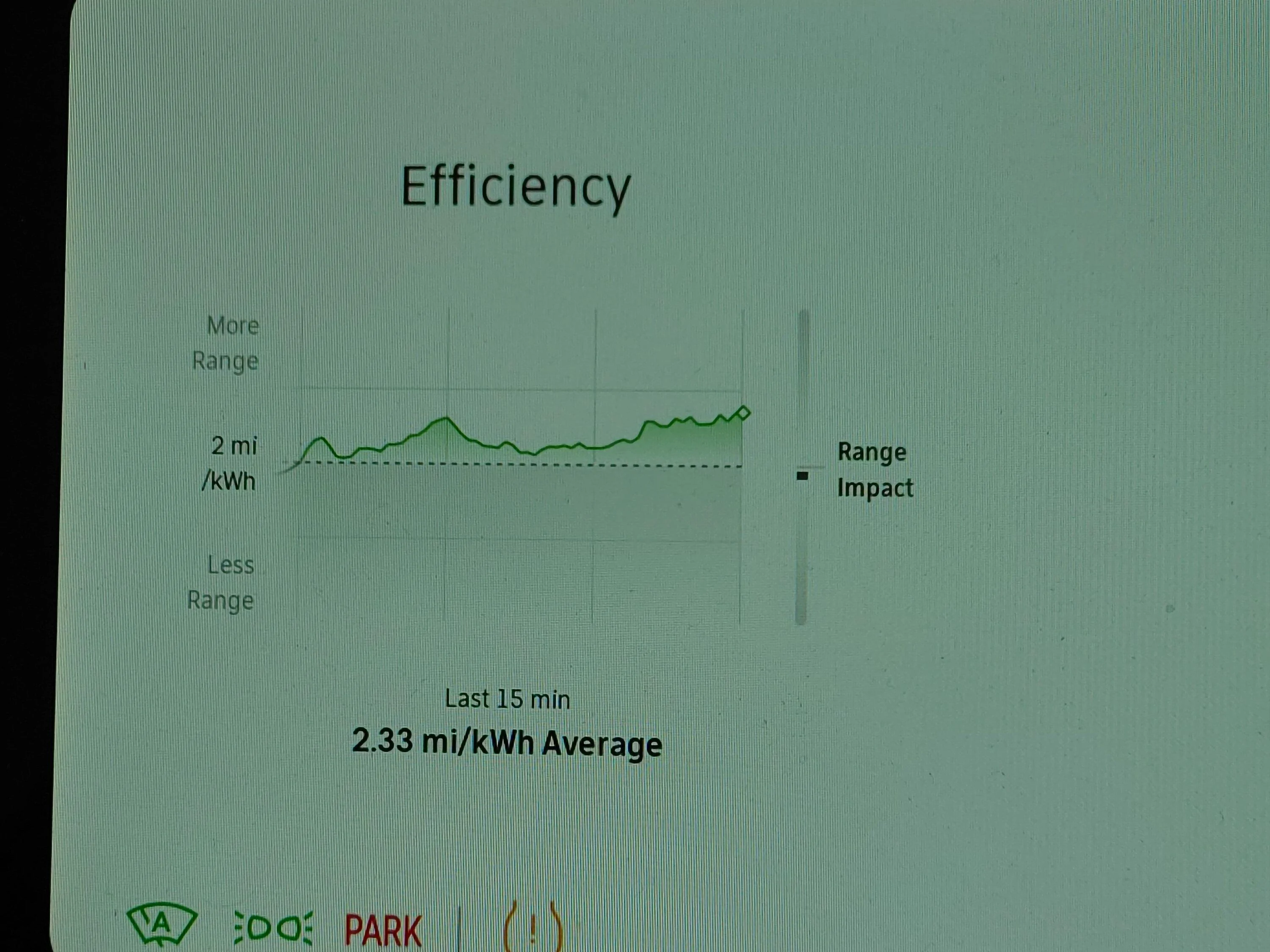

I agree with your assessment and I am not even more annoyed with the graph.
A graph of trailing 15 minute efficiency is arguably useful/correct. In my opinion it's a little too lagged, but whatever.
But the number at the bottom that says last 15 minutes average is just straight up wrong. They need to address that. It doesn't make any sense, and is mathematically nonsense.
I now know why I have had such a bad time estimating efficiency! I just need to use the most recent point o. The graph and ignore the readout. I suspect this was a misunderstanding by the developers who put this screen together.

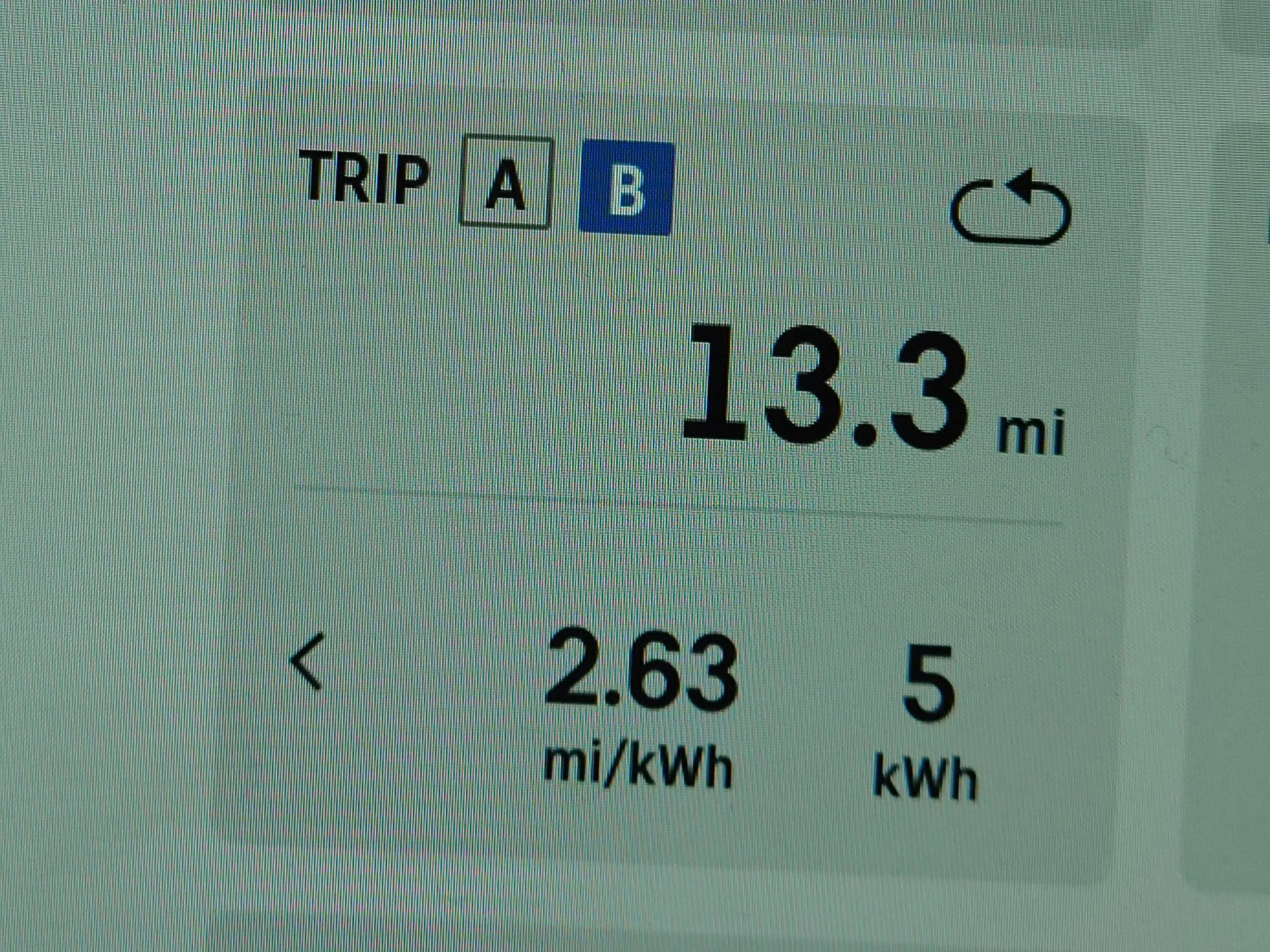

I also reset the trip and then drove 15 minutes and compared...
Rivian R1T R1S Why the efficiency graph is way off vs  real efficiency. 20240126_155452
Rivian R1T R1S Why the efficiency graph is way off vs  real efficiency. 20240126_155501
