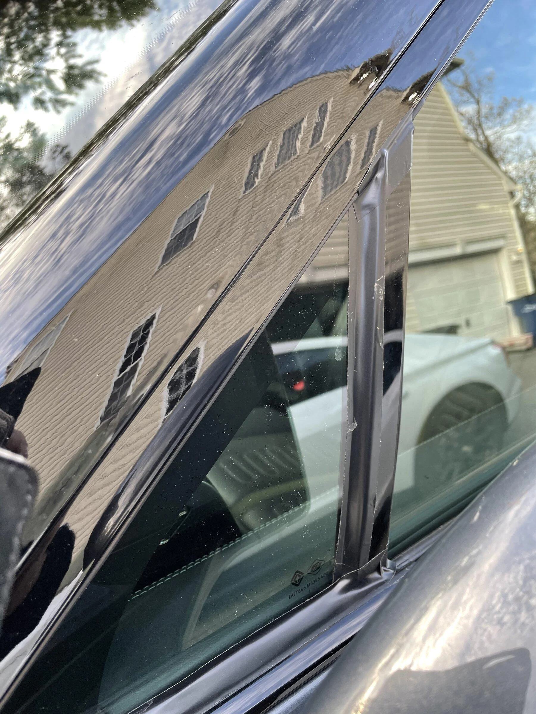

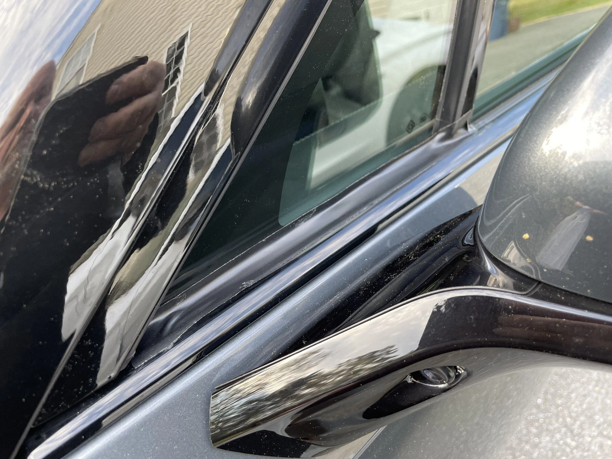

Went in for service and the tech isolated
The noise to the small window at the front of the door. He said he’s ordering a new window to replace it. One of the times I saw him drive by I noticed he had a bunch of painters tape placed on the trim. While I’m waiting for the fix I decided to replicate his method of isolating the issue. I used electrical tape as it matches the trim. It reduced about 80% of the wind noise. There is still some coming from the windshield.
I submitted a ticket for wind noise yesterday as well and the service writer on the phone said it was likely this. So Rivian is certainly is aware of the issue.
