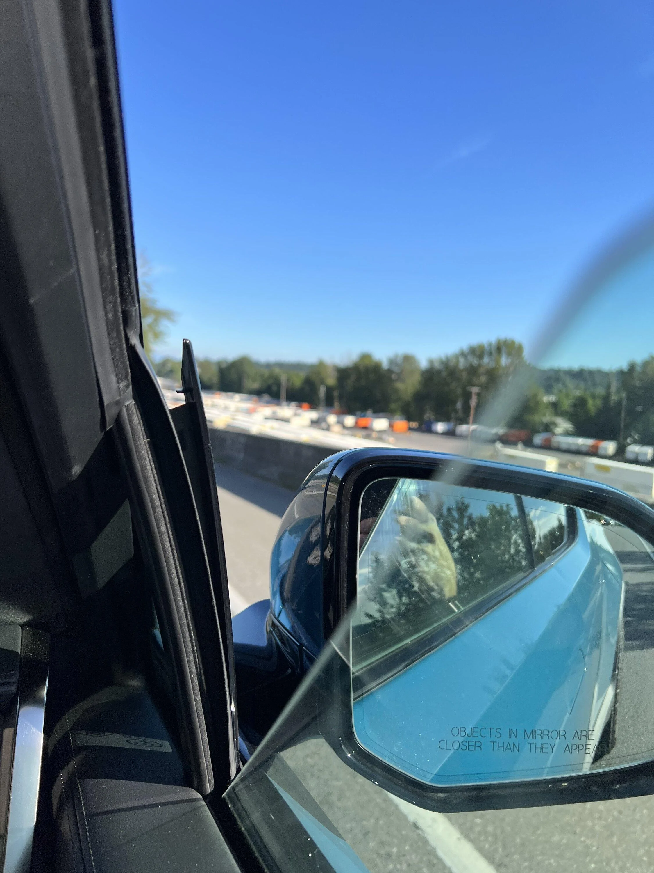

I have some noticeable wind noise on the driver side. Its not bad but noticeable. I submitted a service request primarily because it was uneven. The passenger side was tight and had no noise.
I had the service appointment today. At first they indicated that it was normal but when the technician moved to the passenger seat and I drove, it became more clear to him. They believe a seal needs to be replaced but unfortunately they didn't have it in stock. Once they get it, I'll schedule a follow up.

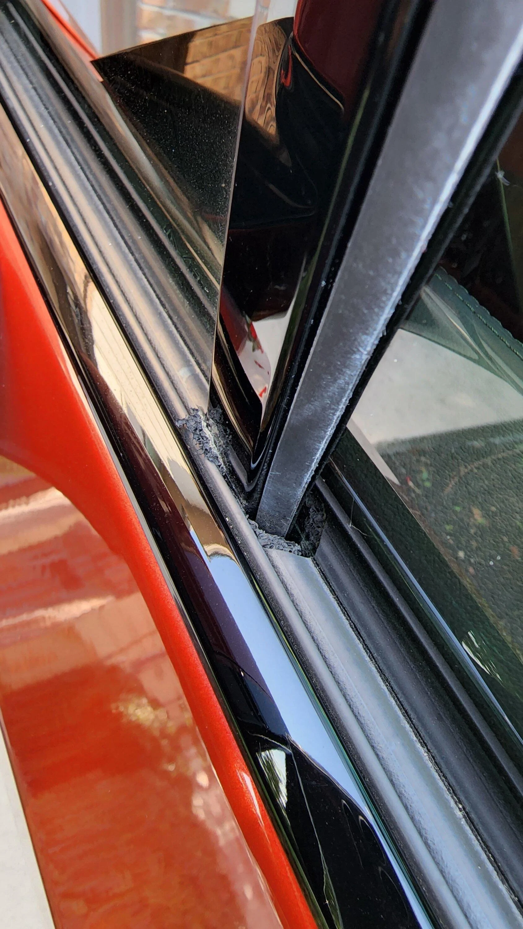

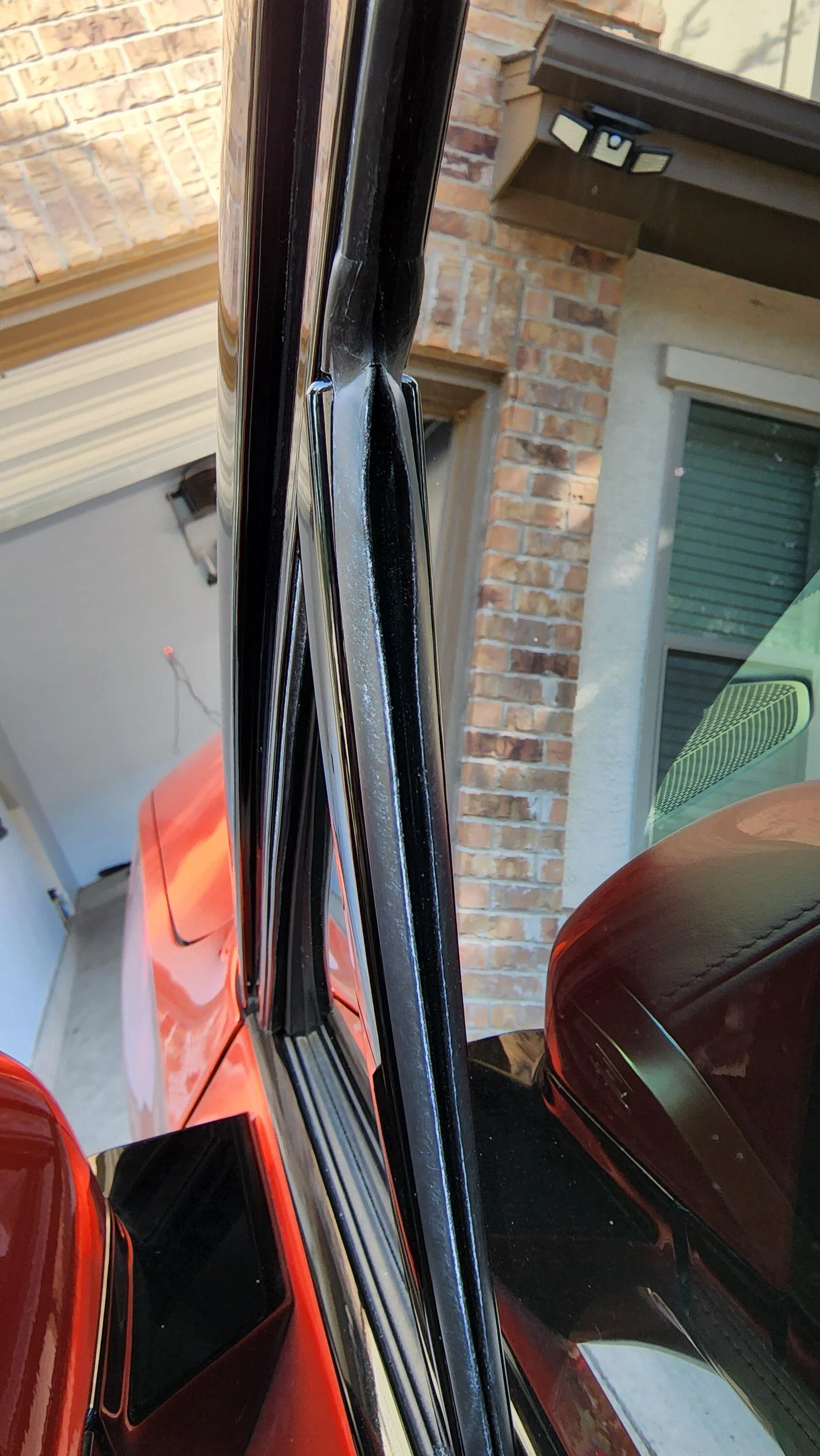

I'm in the wind noise club as well. You can see the defects in the seals easily.
It's both the vertical strip and the little expanded foam bit at the base. The passenger side looks tight and flush and filled.
Rivian R1T R1S Wind Noise 20220527_095520
Rivian R1T R1S Wind Noise 20220527_095551

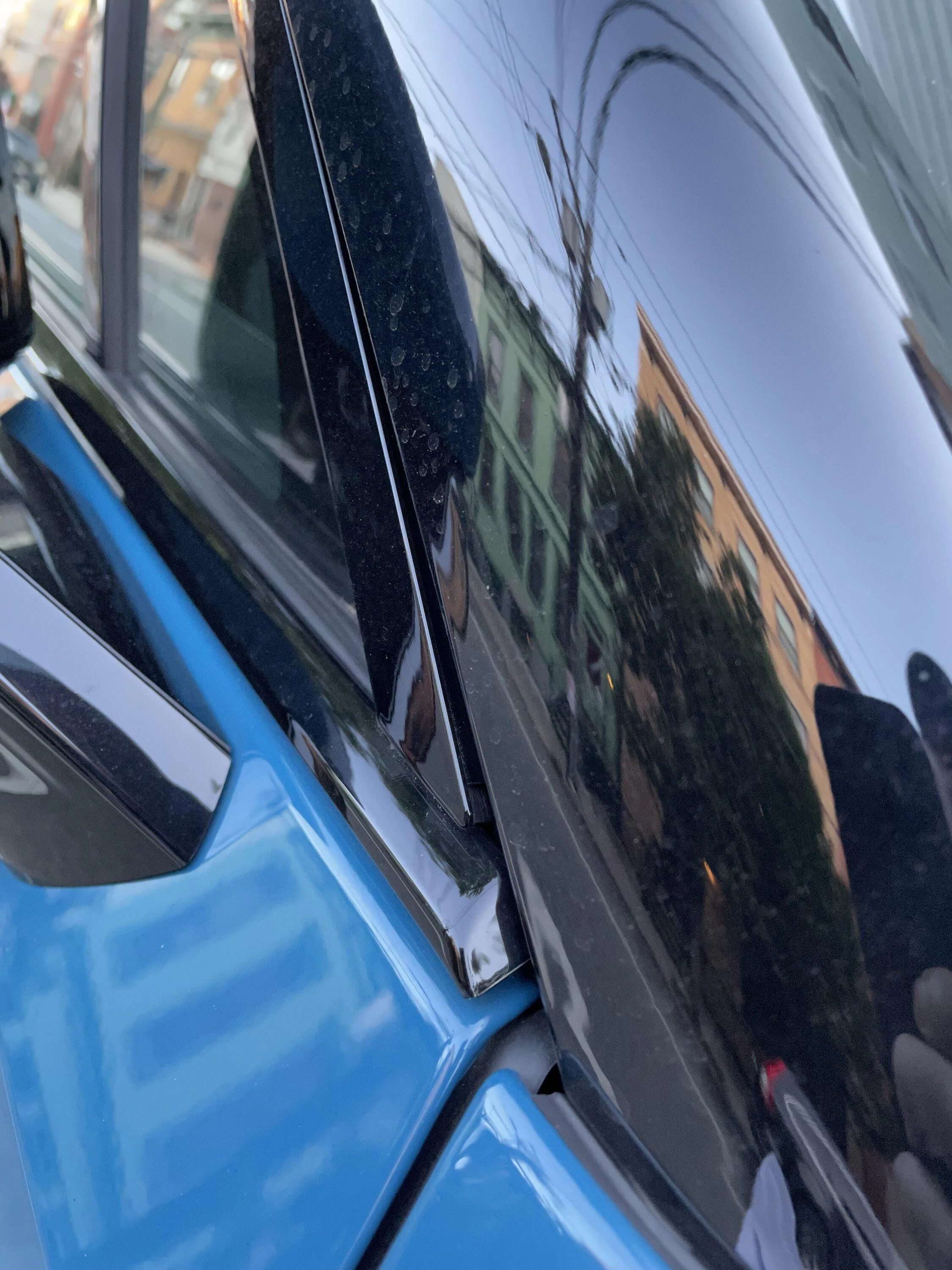

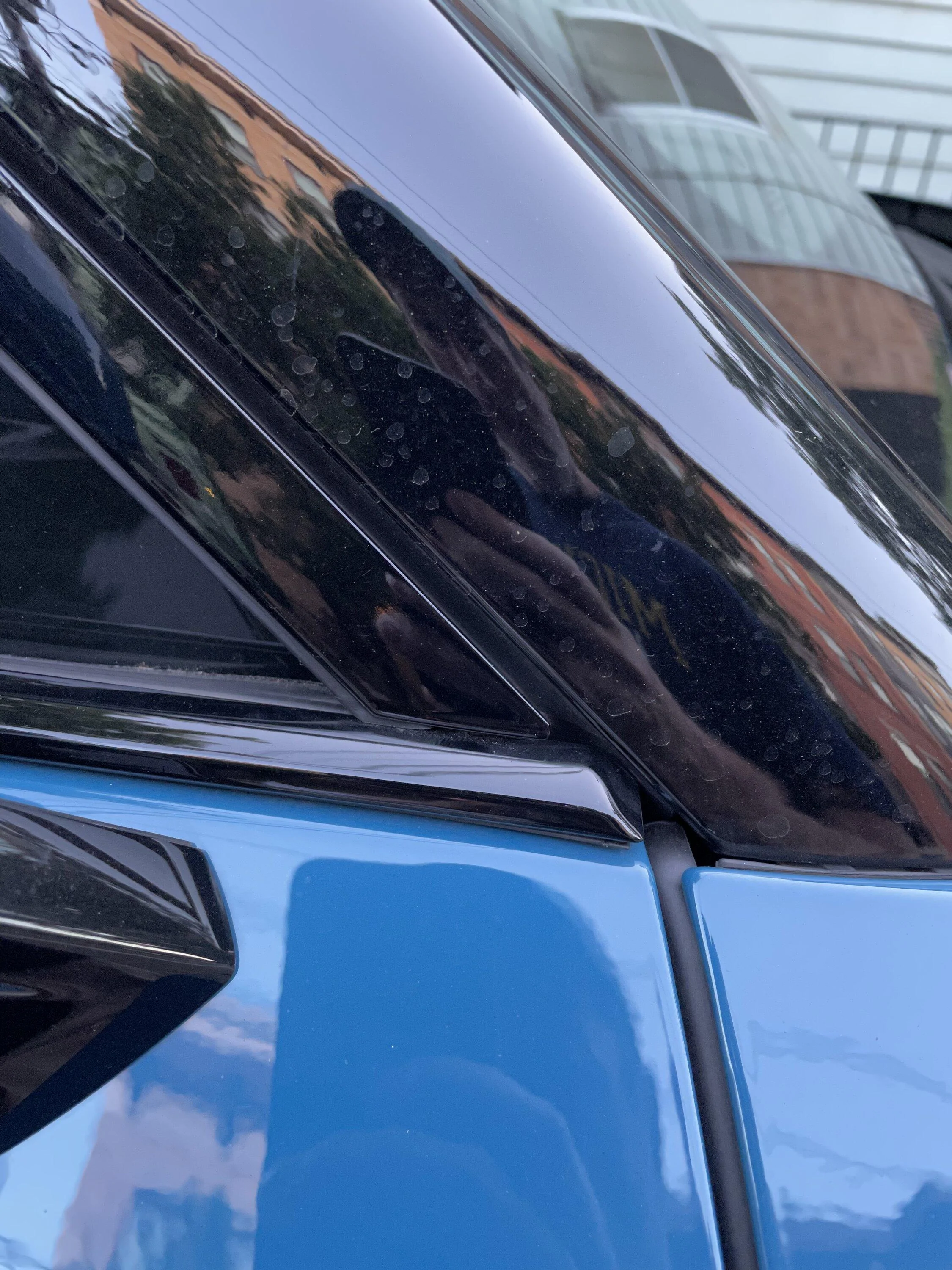

passenger side trim sticks out slightly. I certainly get wind noise creeping
Rivian R1T R1S Wind Noise 844A2656-5511-444A-B0A5-897FF41C07F2
Rivian R1T R1S Wind Noise A2EE99F1-3A88-4EF6-A823-553942B046F1
driver side does not stick out like my passenger side

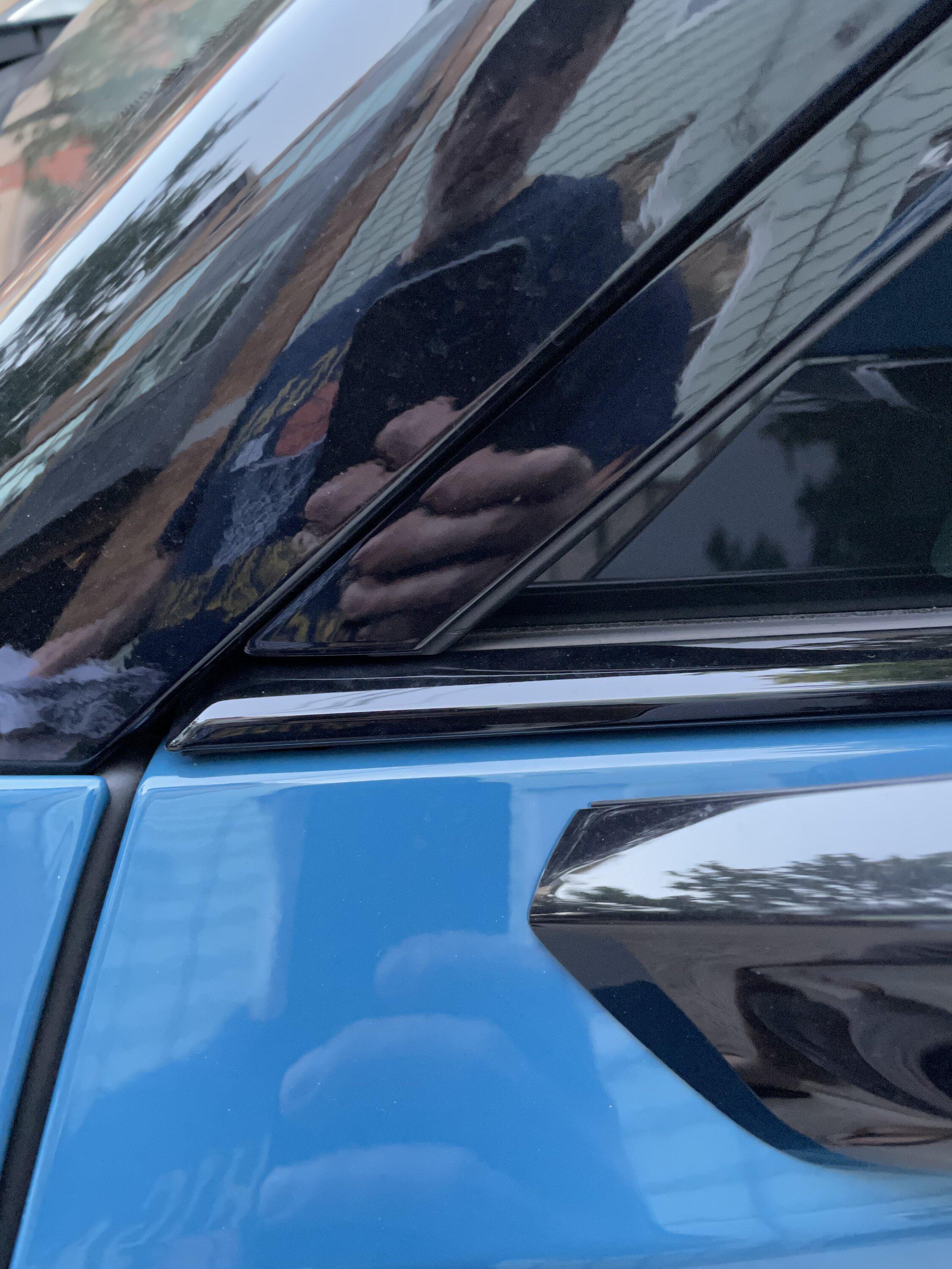

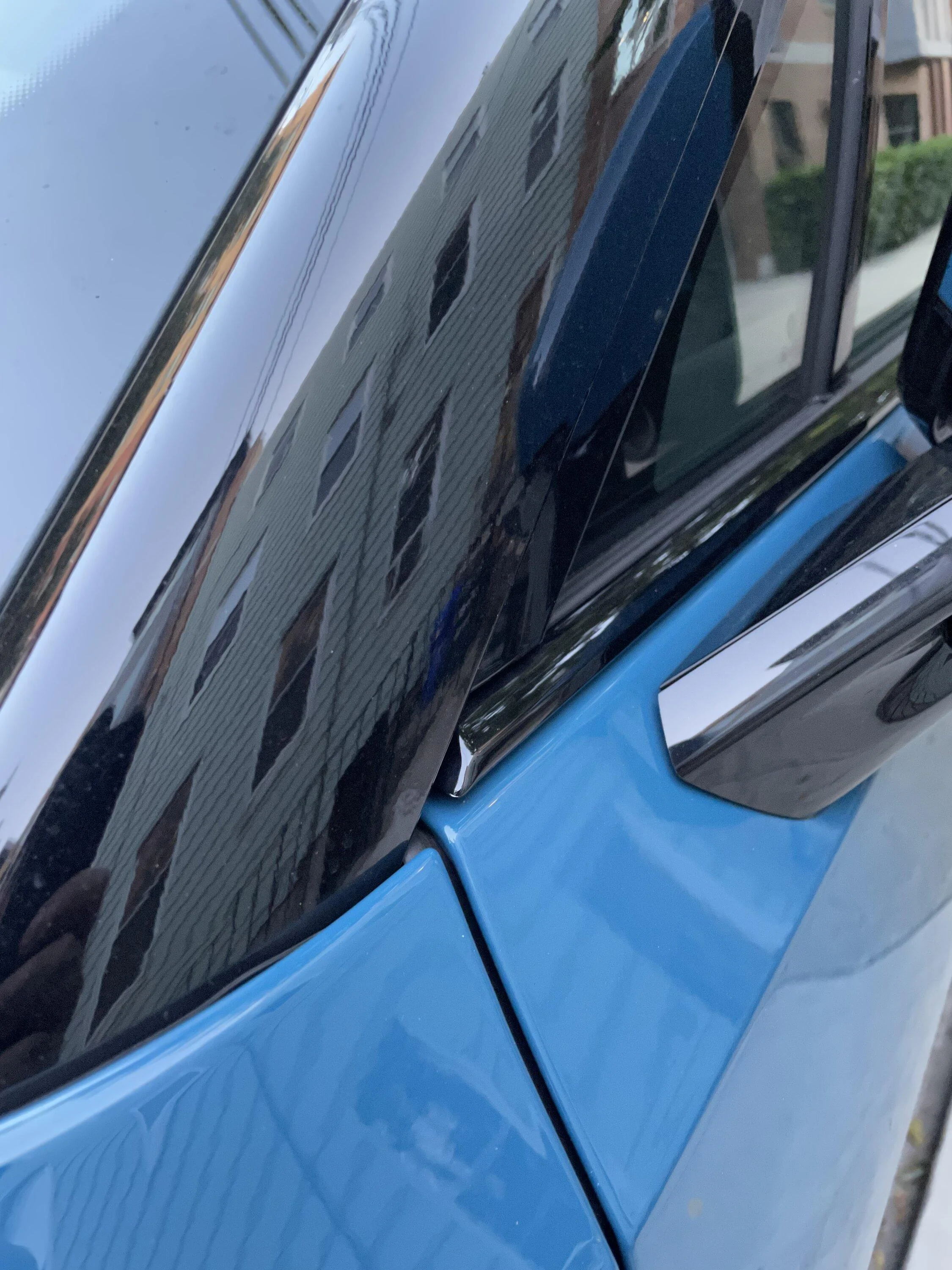

O
Rivian R1T R1S Wind Noise 47191146-3D5A-451E-B678-1C2E33DEA845
I’m not sure if the pictures accurately show the issue, but you can certainly tell from visual inspection that the passenger side trim is sticking out behind the pillar and not flush with the door frame.
