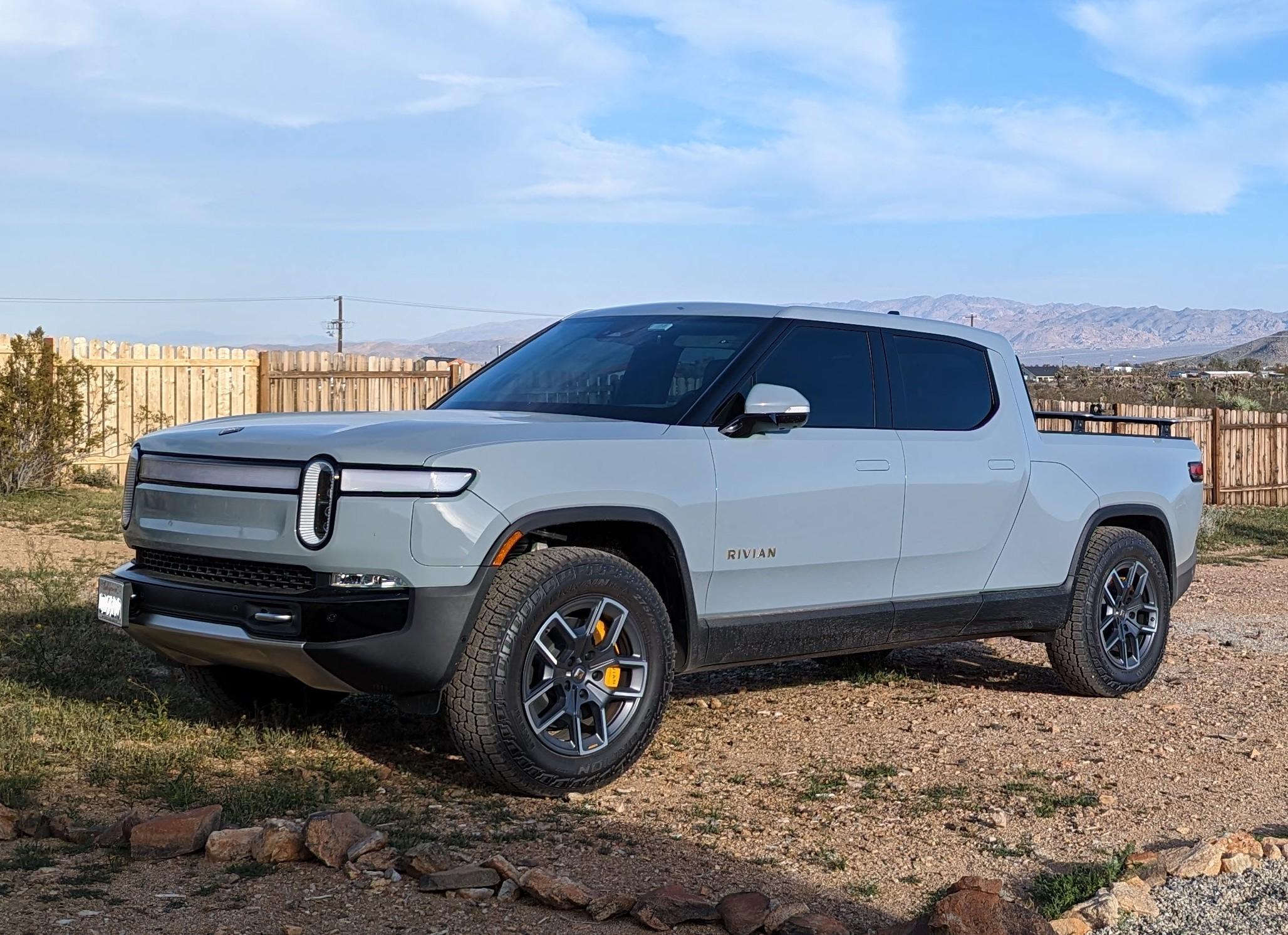

XPEL ceramic -- 50% on the front, 70% everywhere else (including windshield and roof).
$850 total
Rivian R1T R1S Window Tinting % Level Preferences PXL_20230408_004330841~2
