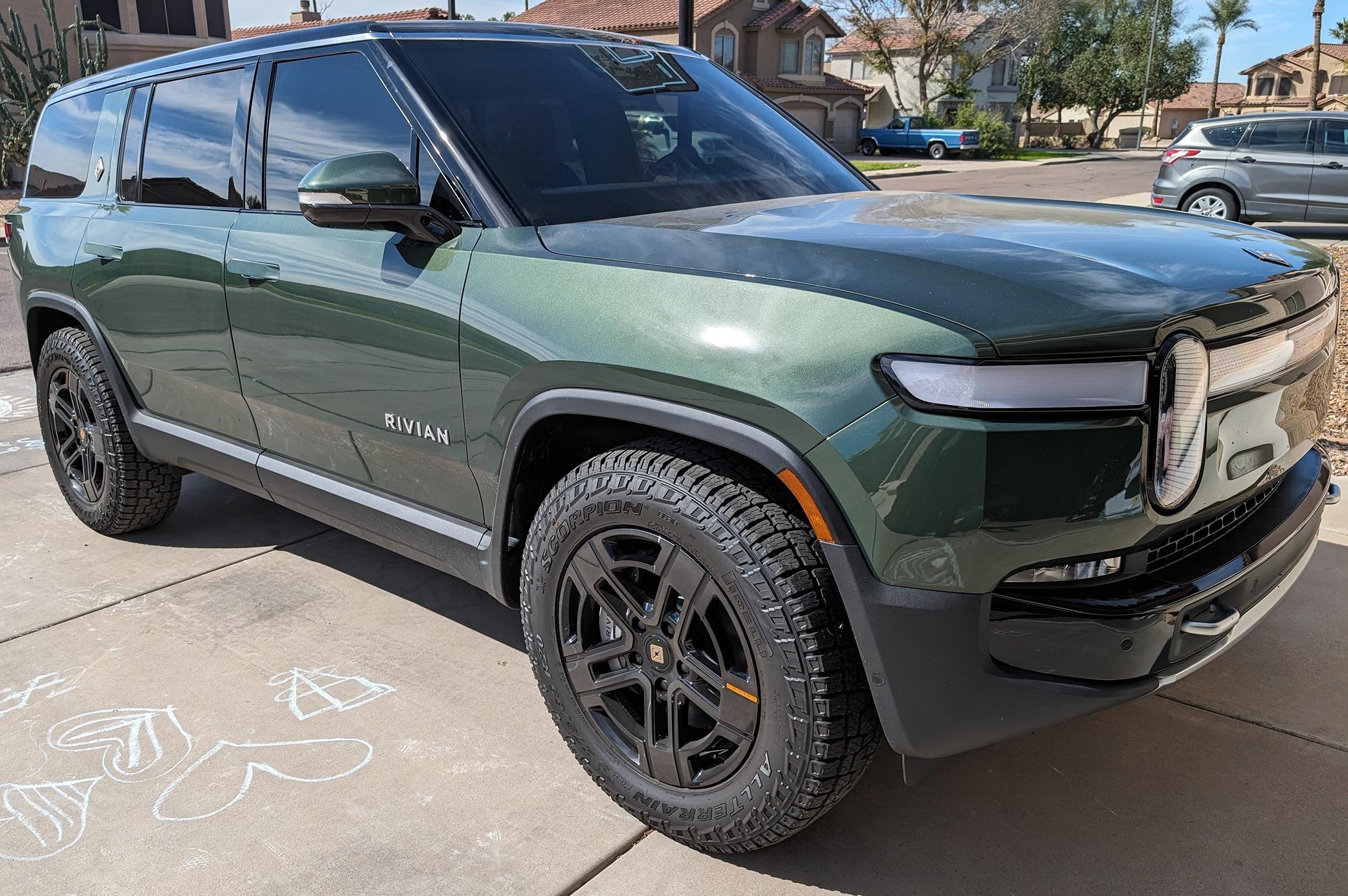

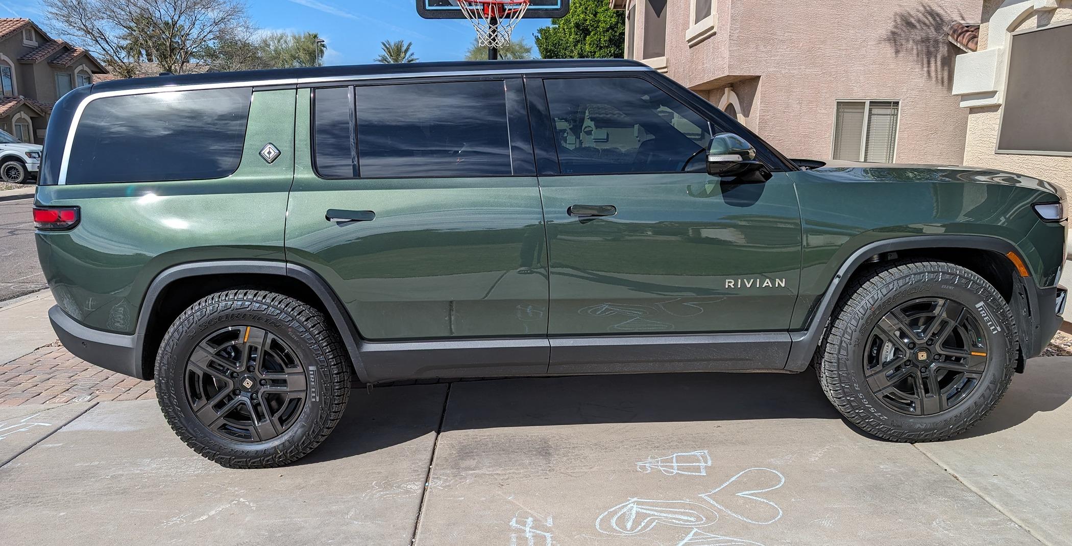

EDIT - adding a pic below of my truck for reference. 70% rears over the privacy glass and 35% front (33% is the legal limit in Arizona). The rears are still a bit darker.
Thank you for the pictures. I am trying to match the rears with the front. On the rear windows and the front windshield, I am debating between 3m Crystalline 70 or 60. I have never seen pictures of 60 before so if anyone has them, please let me know how they look. I don’t know if 70 makes the rear windows slightly darker or if they just are clear. If you did 35 in the front with 70 in the rear, and they don’t match the rear, that means I probably need a 15-20 in the front to match the rear windows?
