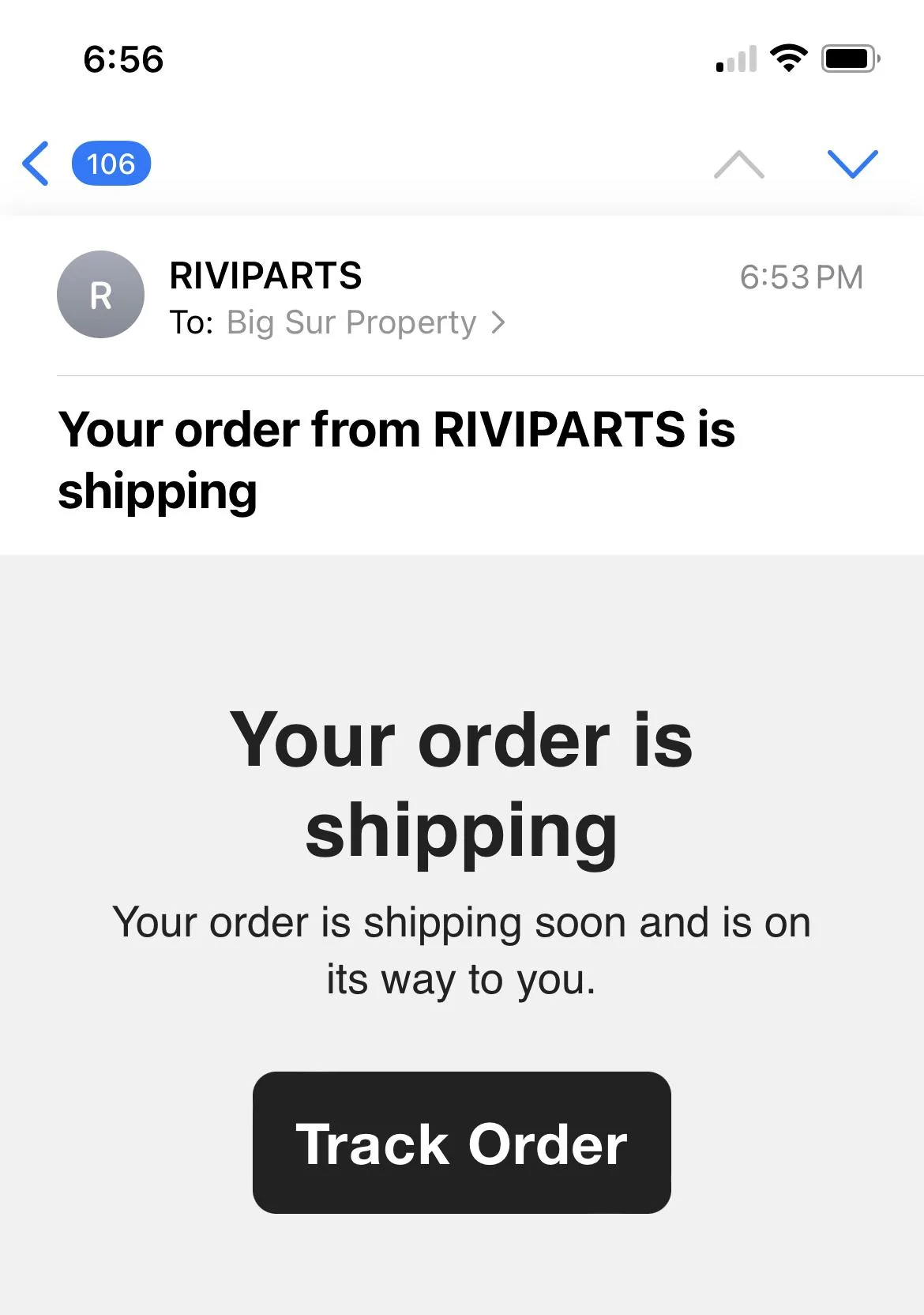

Coming in hot! With assembly! Sadly I’ll need to get my rivian back from the service center.

You will get email with tracking.
Yep - I assemble everything, package it up, buy the label, pop it on the package, then click the button to generate the email. Typically they are dropped off same day or next day if it's after 4:30 local time.
