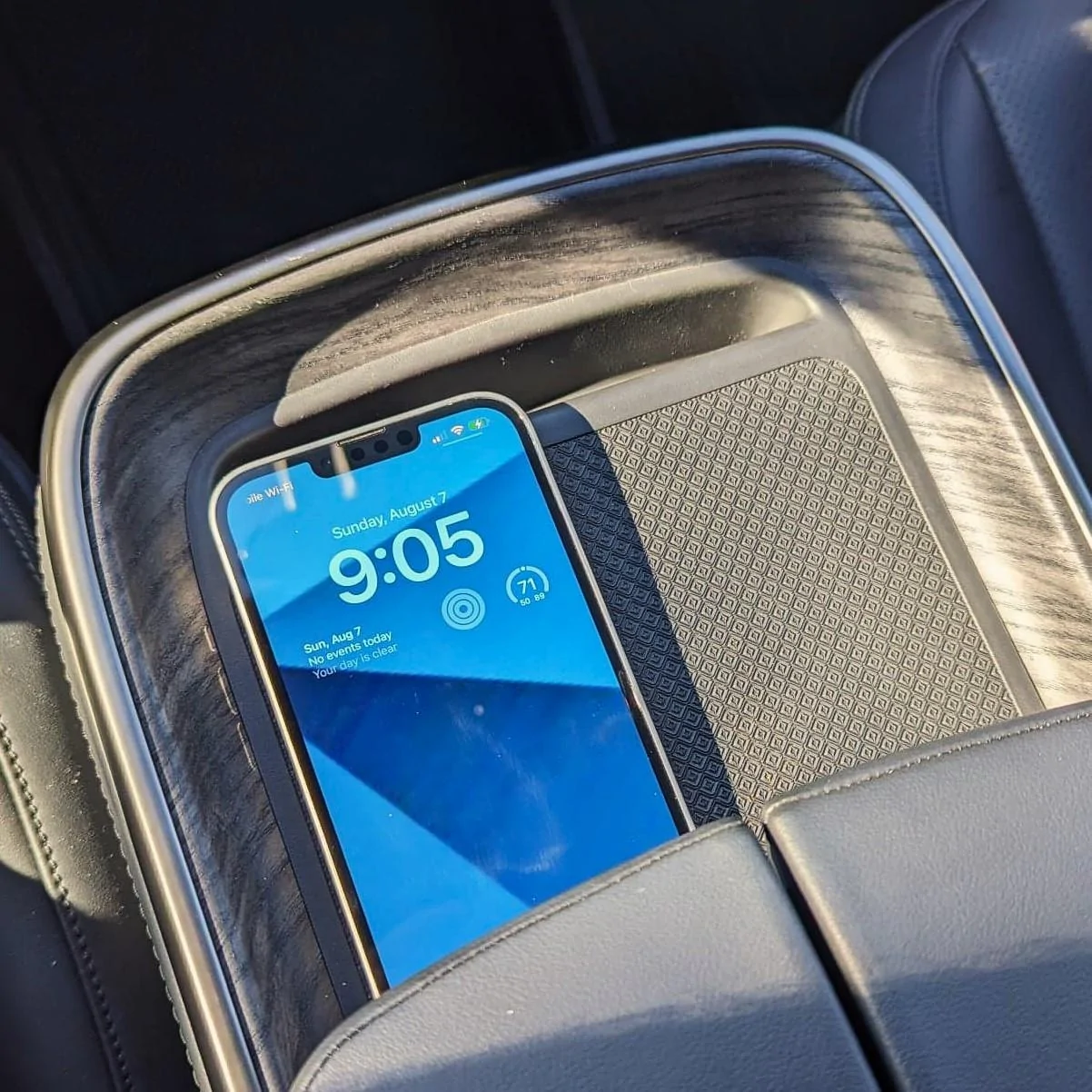

The amount of magnetism is driven by three factors:
  1. The alignment of the pad with the sweet spot on your phone.
    I like my phone to be all the way back against the beginning of the center console. (the resting against it helps keep in in place too) The pad should be just under the ring circle in the case or the phone. If it's not holding, first make sure the pad is aligned correctly. You can do so without the rubber pad on top.
  2. The case itself.
    Generally, for a case to be 'Magsafe' compliant, it will need to have a metallic or magnetic ring built into it. Construction of cases vary wildly when it comes to insert and depth. If it doesn't work, try case free. If that works, you may want to consider a different case.
  3. Distance from the magnets due to camera bump.
    Some of the very large phones have a very large bump that seems to rest right on the bar before the troth at the front of the pad. In this case, you may want to consider reversing the direction of the phone - top of it pointing toward the rear of the vehicle. You'll have to reposition the pad to support this.

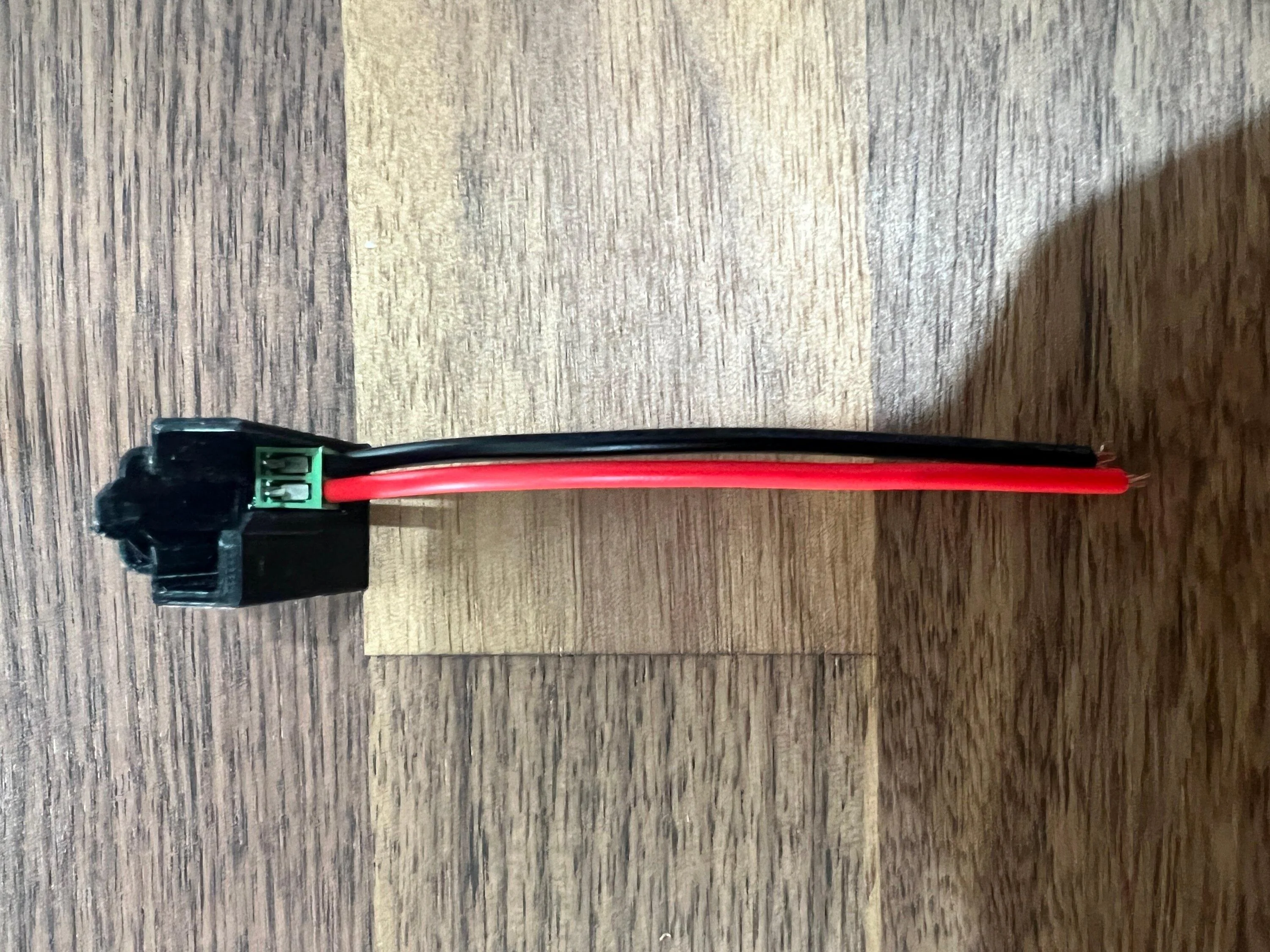

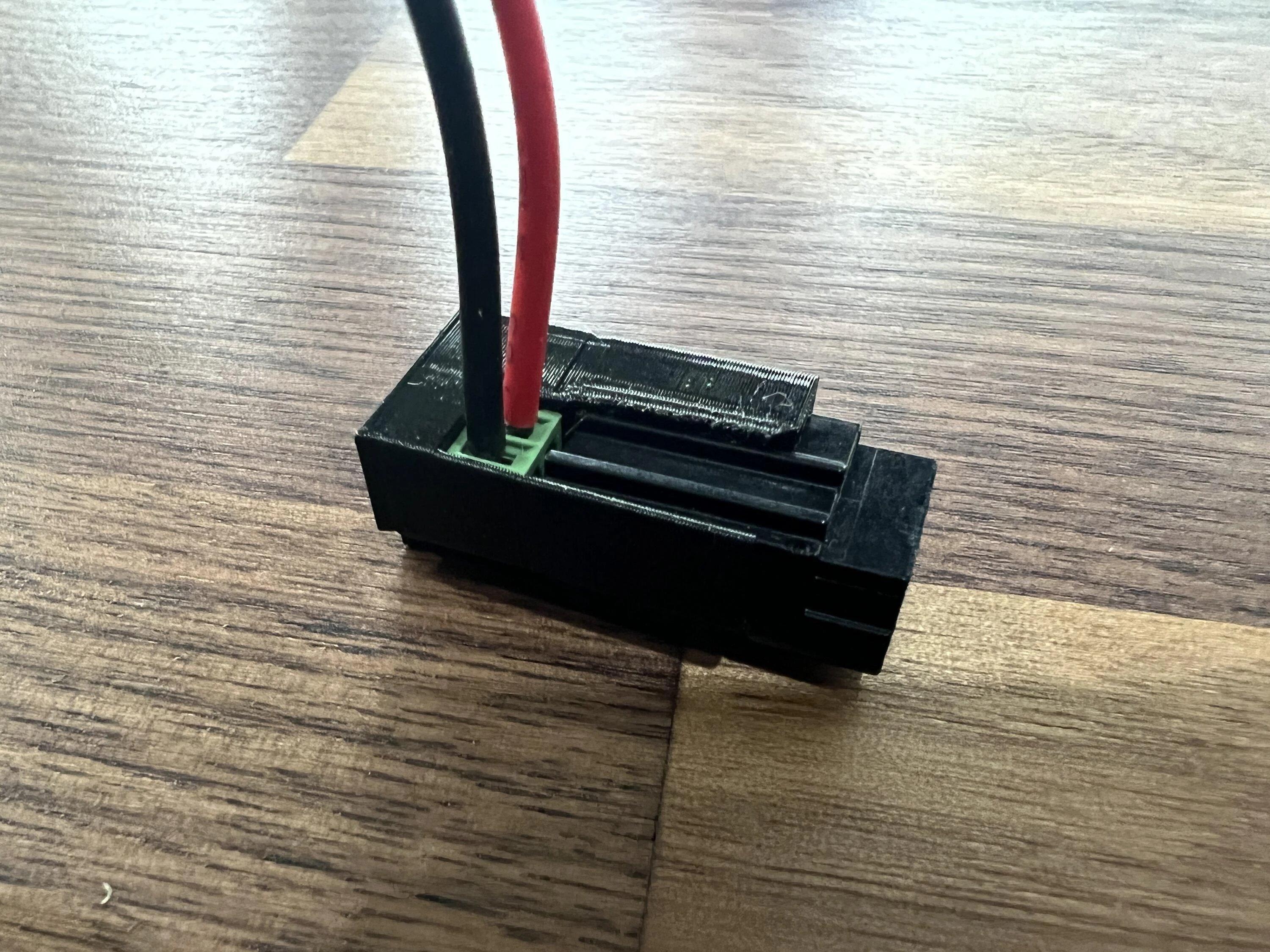

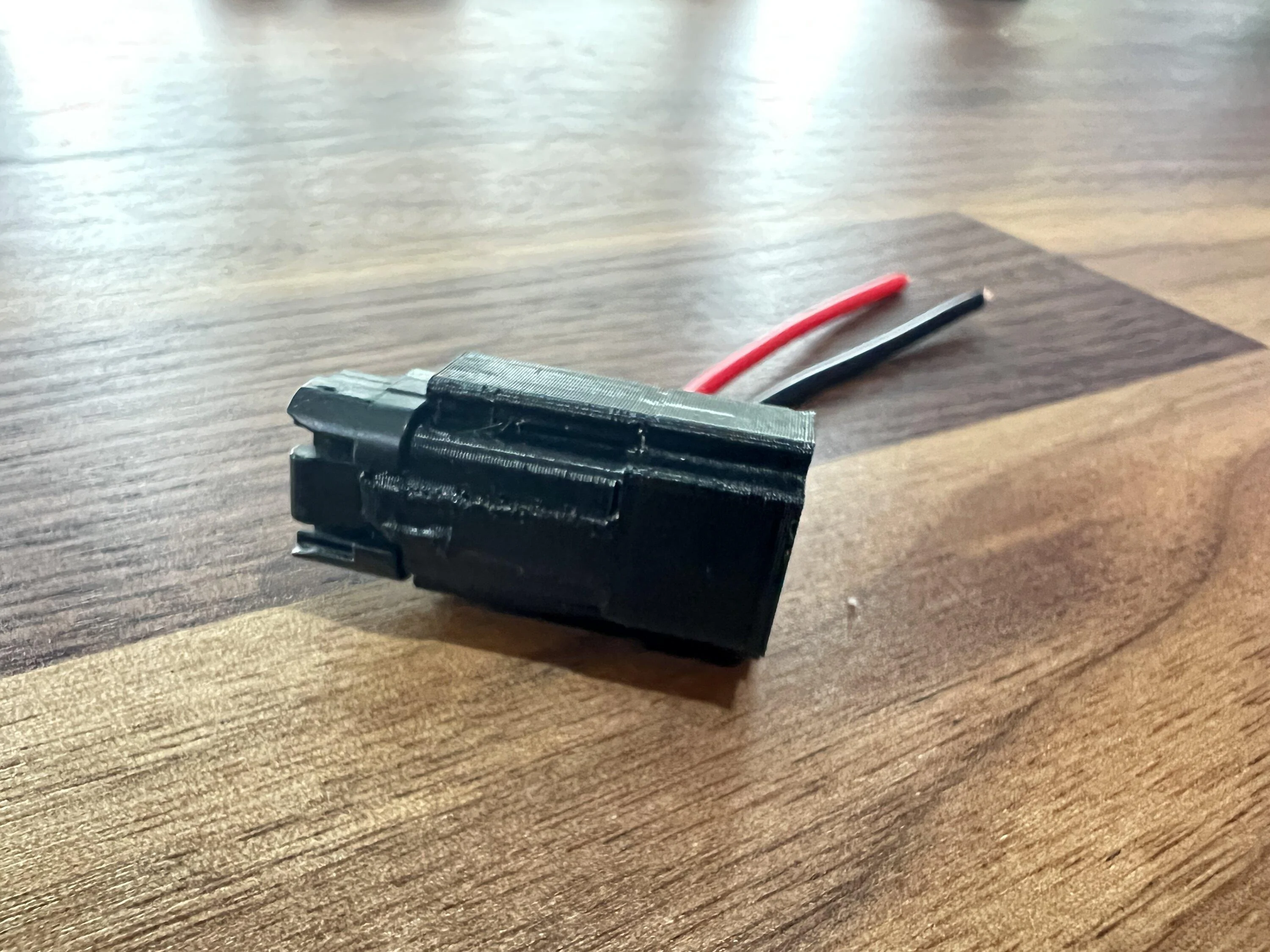

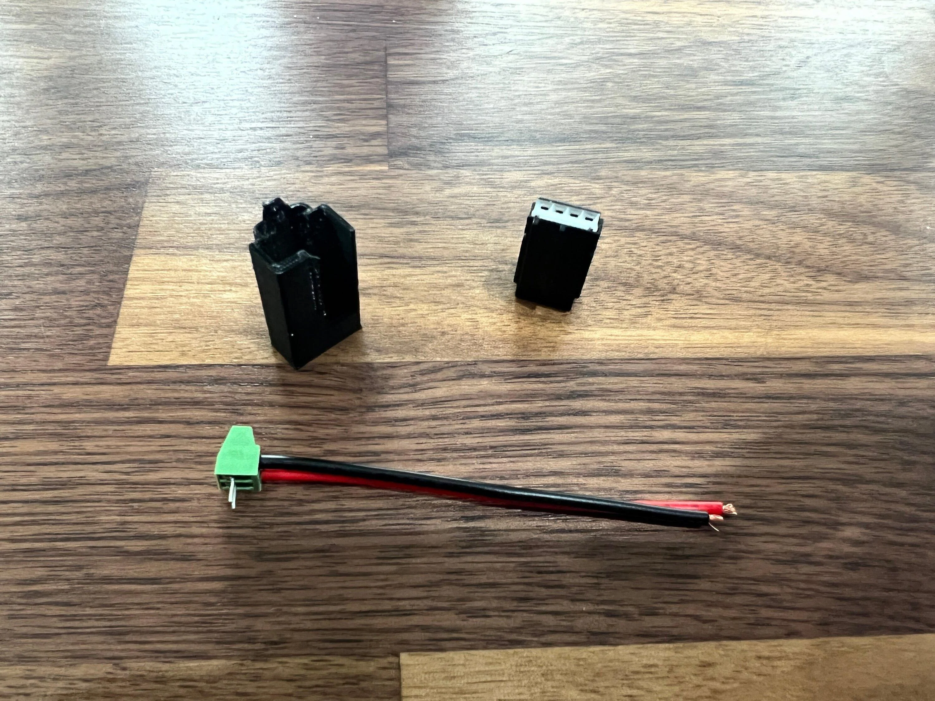

I've printed the solderless connector for the kit, and it has come out exactly how I hoped that it would. The terminal block fits right in, as does the connector for the truck. It snaps into place and everything is held together well.
The print itself is very easy to make. and installation for the entire magnetic pad assembly would only need a small flat head screw driver in addition to the torx and pry tool.
Here is what it looks like. please note the the connector on the right in the picture (and inserted in others) is actually a bare connector -- the same as on the end of the truck cabling. It's used and show here so you have an idea of what the finished product will look like.

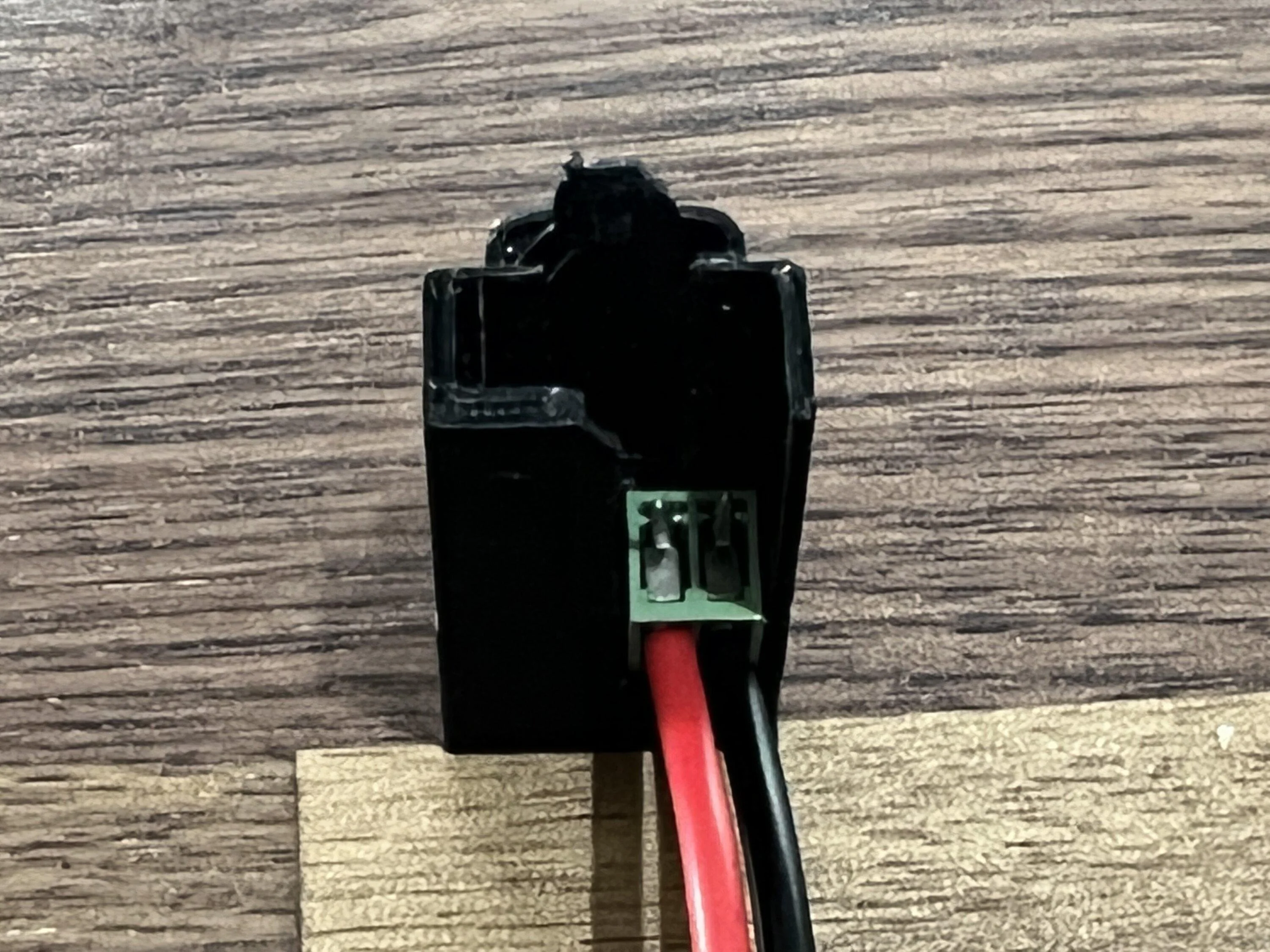

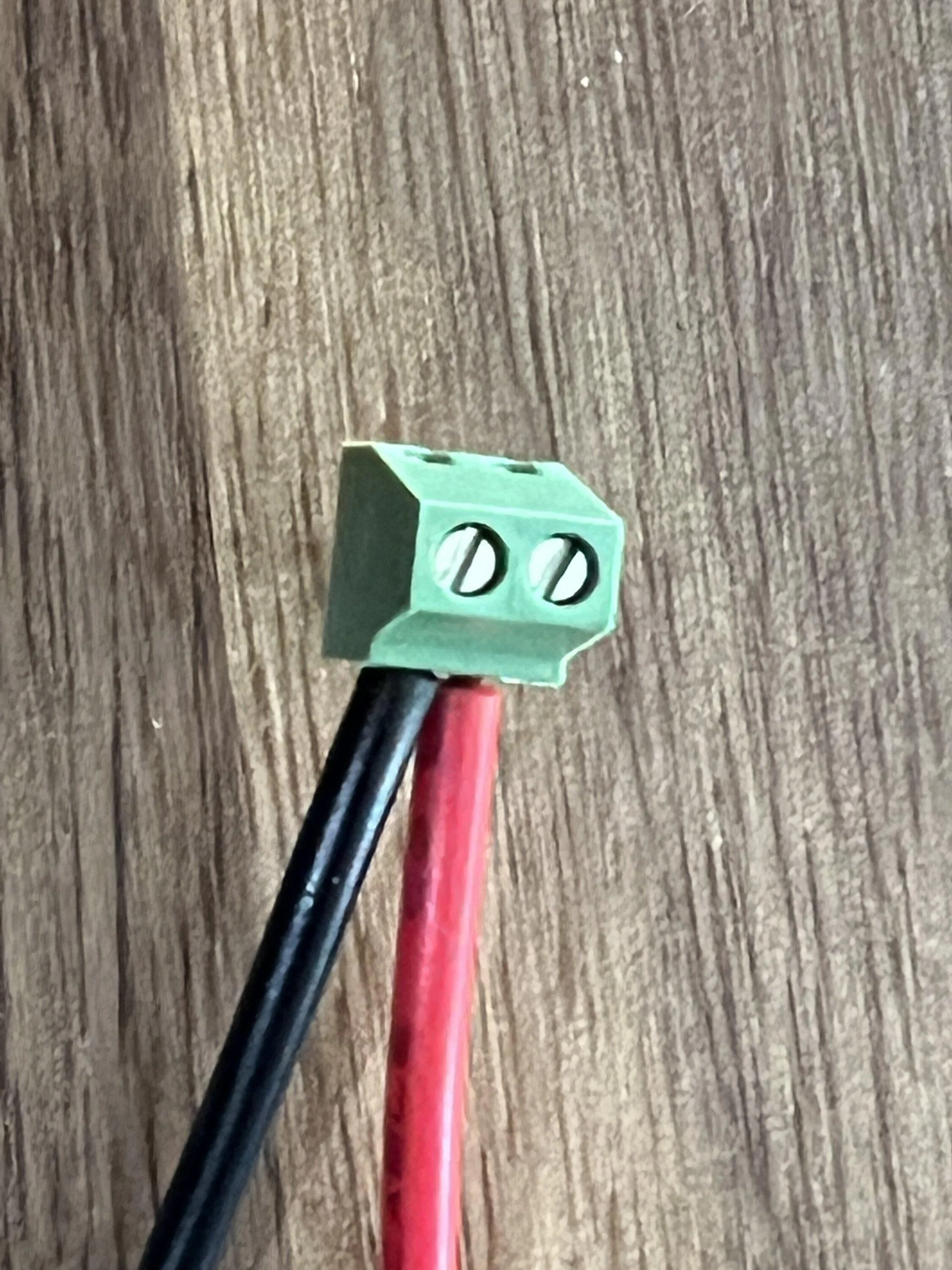

The below picture is a close up of what the back of the terminal block would look like. Notice the flat head screws. The red and black wiring would go to the distribution block (the grey part) on the pad replacement.

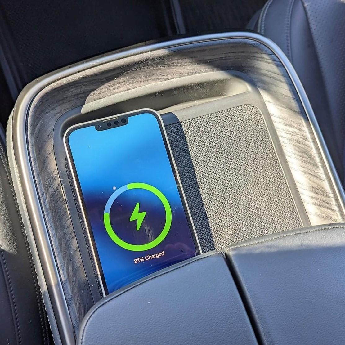

Got mine a few days ago and just finished fully installing and initial testing. Took me about an hour in total. This included watching the assembly and printing out the install instructions.
Assembly was good, I followed along on the video and was able to do everything without difficulty. Biggest obstacle is soldering and holding everything in place while working.
Installation was ok, the double-sided tape on the existing pad wanted to pull off the top of the existing charger as someone else posted, so you need to go slow. I had to place a finger on the charging pad while I pulled off the rubber mat.
Overall Results - It works... Charging is good/very good. Mag hold is slight and I need to do some more testing.
Charging actually works! Where as even without a case, my phone would maybe start an actual charge 5% of the time. Now even with a case, it will charge. Without a case it charged slightly faster but for me, it was still charging at a decent pace even with a case on.
Tested at 85%
Phone estimated charge rate
Without case - 28 mins to full
With case - 29 mins to full
I gained 1% while testing and checking so it was actually charging it up.
Magnetism hold is barely there when the mat is over the chargers. I haven't tried driving around yet to see if the phones stay in place. The chargers themselves get a strong snap and hold when used without the mat so it's mostly the mat that causes the loss of magnetism hold.
I am going to test out if the chargers could sit up a little higher as they are ever slightly sunken below the holding case.
Notes for others - As with most things - Test the chargers before you do anything. You don't want to assemble and install only to realize they never worked to begin with.

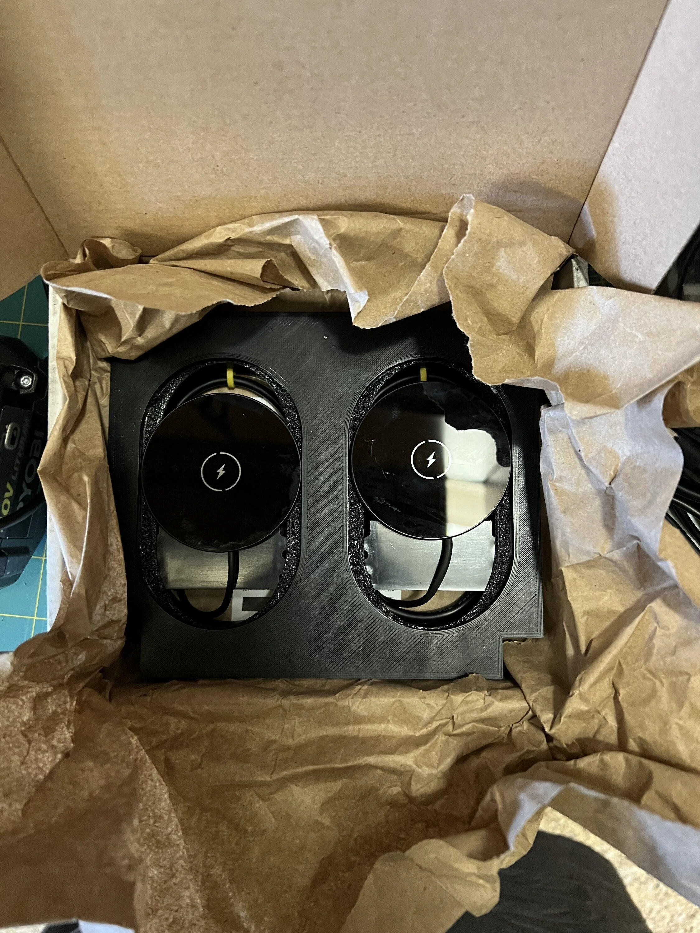

So, of course being the one to mention testing the charging pads, one of mine failed. Rest of the components seem to be fine and my wife doesn't have a wireless charging phone so I just moved the working one to drivers side for now.
