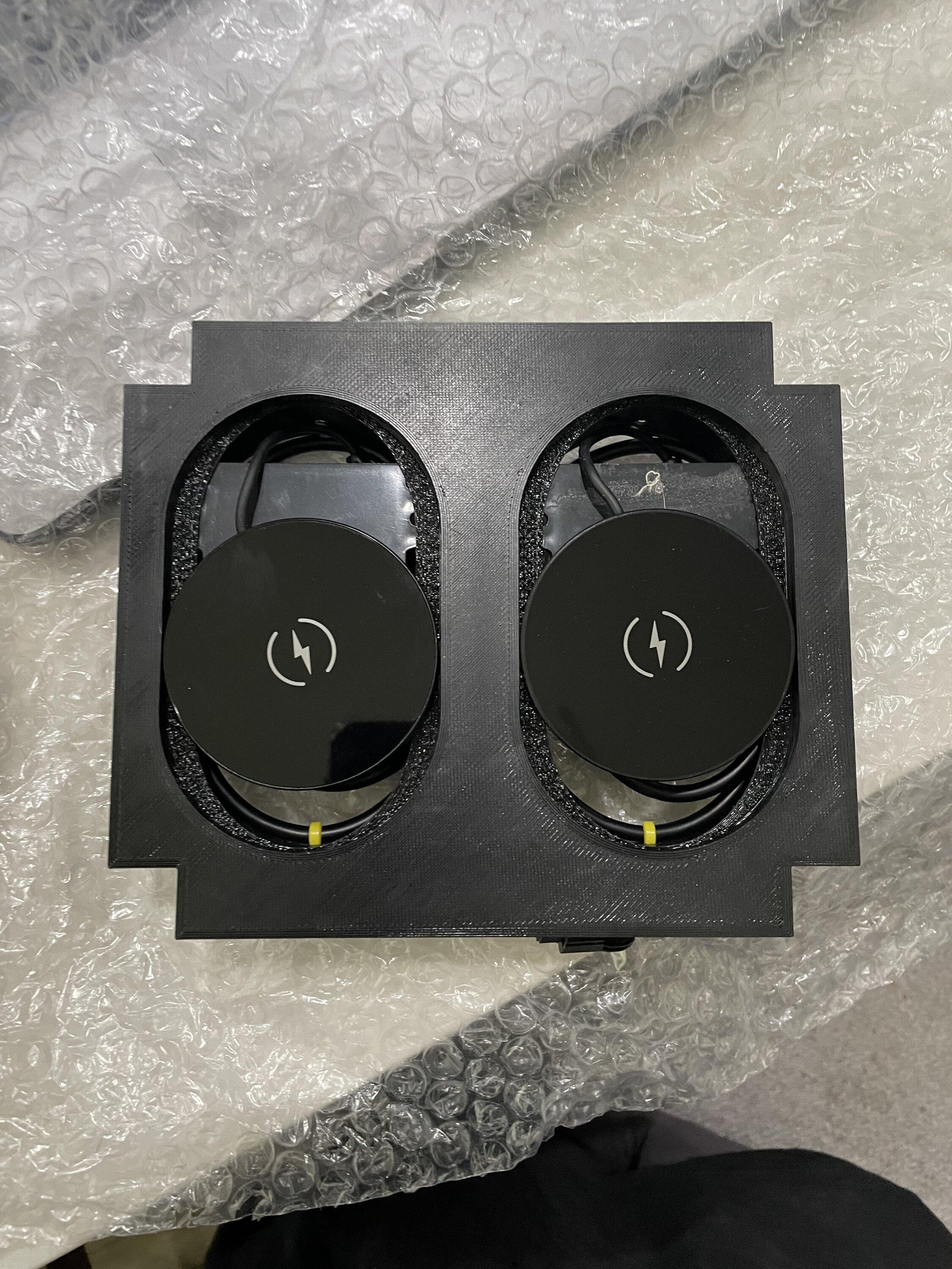

Appreciate the product and effort to make this. Installed this morning, struggled a to get the new box to stay flat with the power cord and to adjust the wireless pad to where I wanted (probably need some sort of tape).
Ended up reinstalling current charging pad.
If anyone wants mine, looking for cost and shipping.
PM me if interested

I was able to install it and it is a notable improvement over the OEM charging pad. I just used a little scotch tape to hold the charging pads where I wanted them. It does take a little fiddling to get all the wires situated so that the two oval shaped supports rest flat but once you get it, it sits flat nicely and supports the OEM insert above just fine. I wouldn't expect this fix to be magical. I have a thin, clear case on my iPhone 13 Pro and installation of this upgrade makes wireless charging "sometimes possible" from "not really possible" with the OEM charger. If I take the case off, it works reliably so I'm thinking it's the camera bump on the case that is creating just too much of a gap. That 1-2MM or whatever it is makes all the difference. My takeaway here is that wireless charging sucks and there needs to be one more aftermarket accessory made to turn this space into a small storage space and the power can be used for a little light or an additional USB-C port or something.

I finally got around to installing mine. I was a bit skeptical given how little magnetic attraction there seemed to be, but after about 2.5 hours of driving (some in a spirited manner on twisty back roads), my phone (iPhone 12 Pro with MagBak case) stayed put and charged just fine the whole time. Charging speeds aren't amazing, but should keep it topped up while sitting there. I think the case on my phone was a huge contributing factor to making this work. It has a very high magnetic force.
Thanks again for putting in the effort to bring this to reality.
