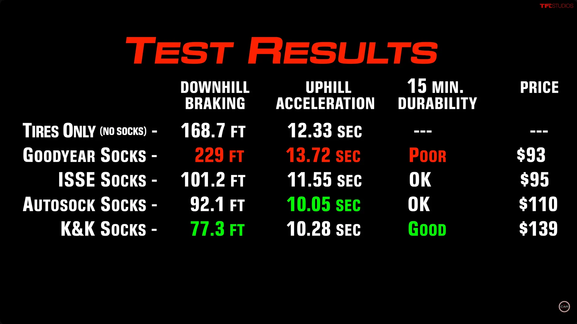

And for a comparison of socks and chains
ha well maybe the socks vs. chains :)
I watched this from TFL the other day, and was surprised by the results.also decent little test loop they did putting them through different conditions etc.
I'll probably pick up a set of the K&K's for my truck next year, this one is already a write off due to poor snow.

I am always surprised by snow sock performance, but they always consistently do much, much better than you would think.
Considering how light they are and how easy they are to install, I'd say they're a no-brainer to carry around if you have a chance of driving in snow.
One thing I've repeatedly seen - socks are really not effective on ice, so be careful (black ice, icy roads).

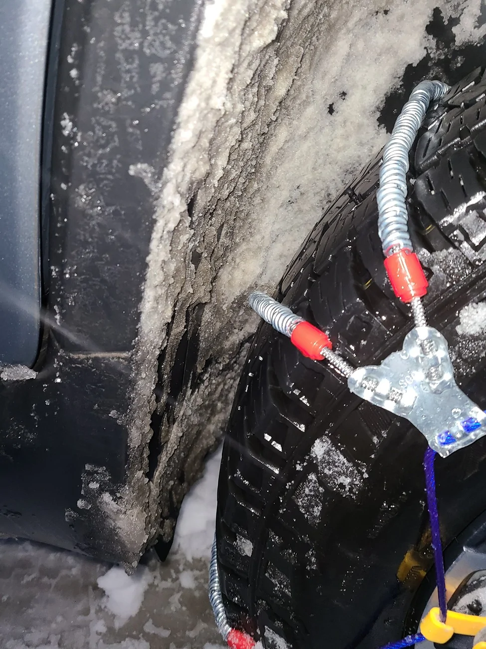

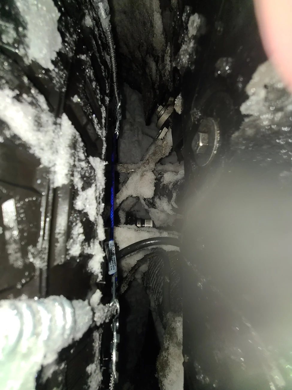

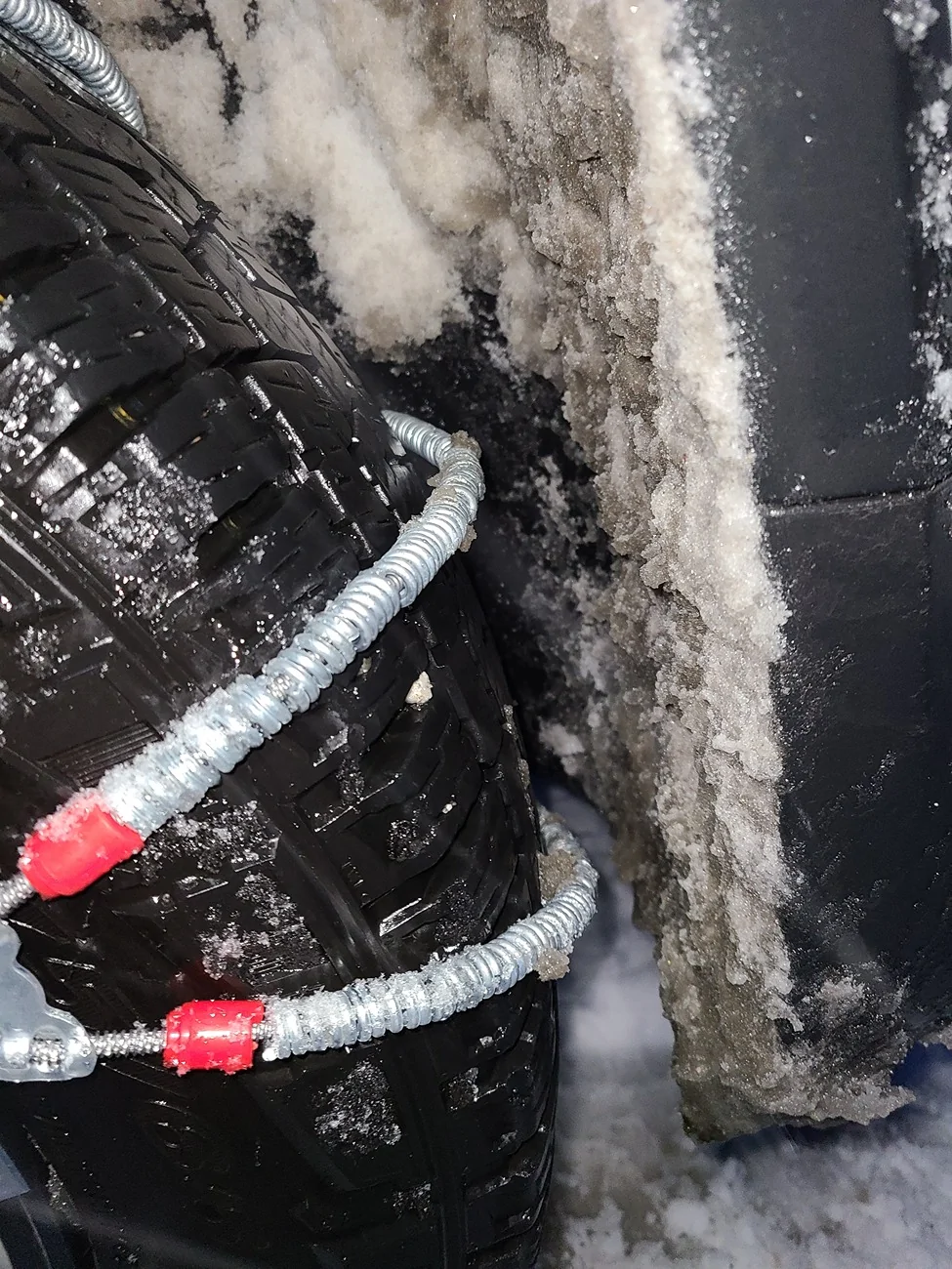

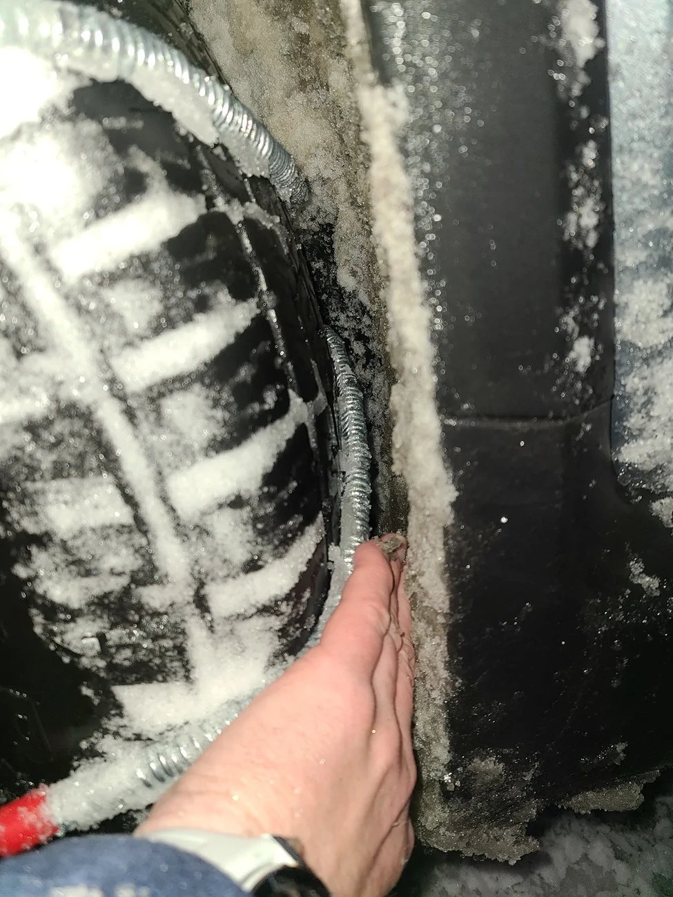

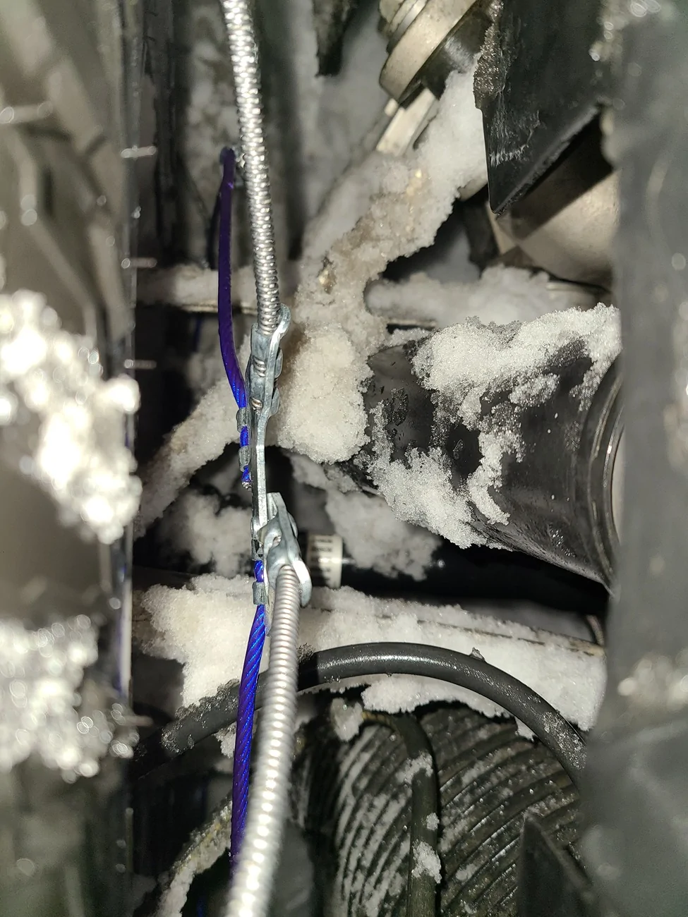

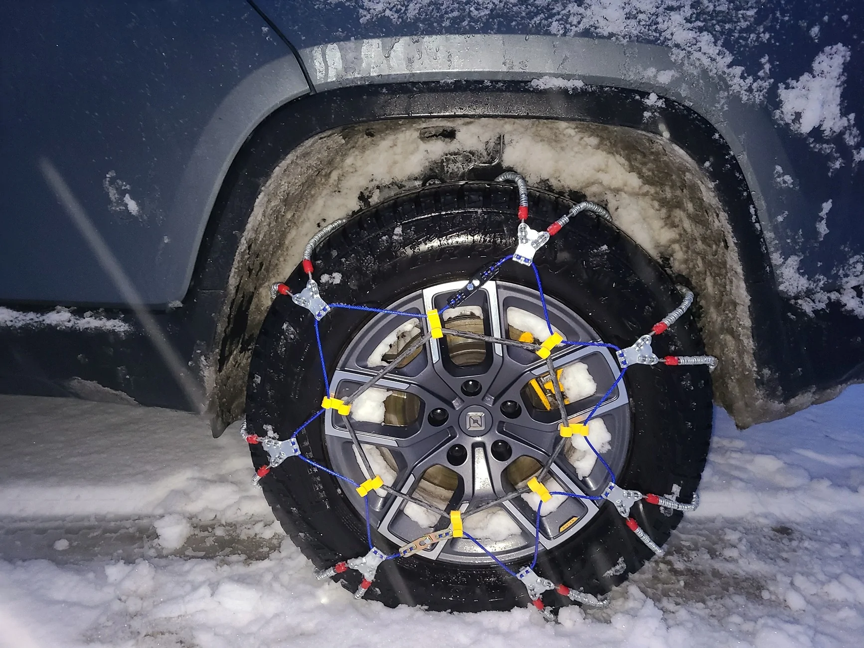

Be careful. I bought a set of Super Z8's and returned them.
They are great in the snow, but Rivians have a surprisingly tight wheel well, and above 20 kph, in all drive modes (Edit, and heights), they come in contact with the forward and rear liners. The photo with my hand there and chains shows how little clearance there is. You can also see the darker spots without snow in the areas mentioned where the chains came in contact with the truck.
Also, be mindful of the cables on the inside face of the tire.
Guess I'll just remove those from my saved for later list. Were they passable for the rears, or both ends it was a no-go?

+1, there are a few videos that show how (surprisingly) chains/cables splay out when rotating at speed.
I couldn't get as good an angle, but when I looked with Alphatrax webbing "chains," they didn't seem to do the same. And of course, snow socks would not have the same problems.
Almost. but you can hear them hitting while inside the cab. The video of the rear, if you watch it carefully you can see how the chains start to pull away from the middle of the tire most visible toward the front of the tire just before it makes contact with the ground.
While I wanted them for my off road adventures, my wife also wanted them so she could use them for snowshoeing. In the end, I was weary of the damage they would cause at low speeds, and the total prick of trying to get them on even for me, would have been impossible for her.
I really wanted them to work, in spite of all the threads and comments saying they likely wouldn't.
