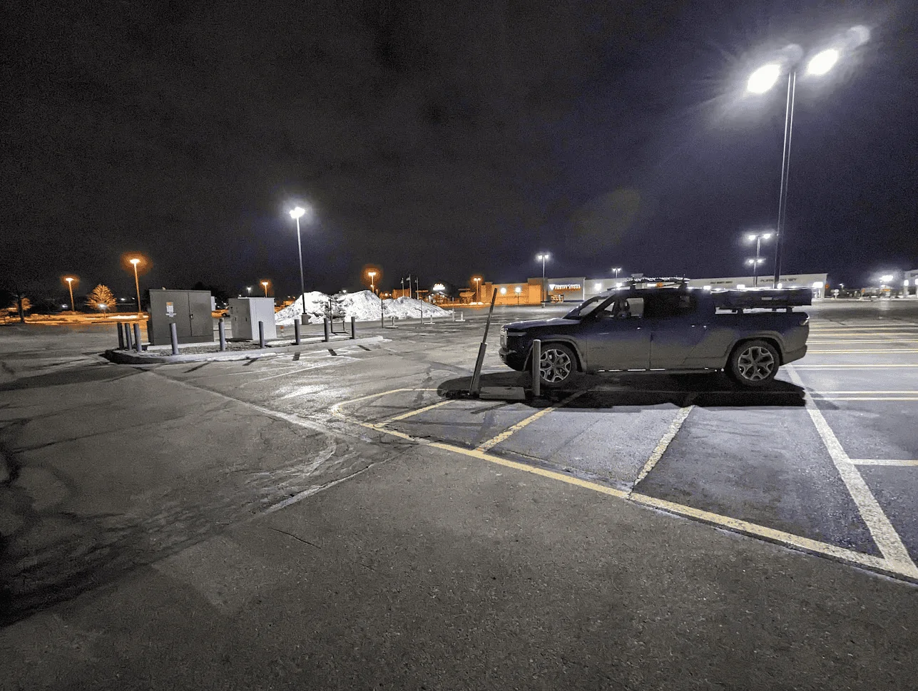

Here's me opportunity charging at my closest RAN last night :(
