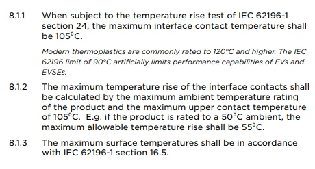

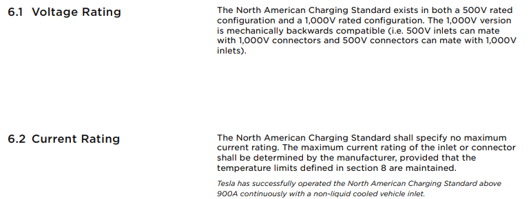

To date, I do not think Tesla has released exactly what the specifications are for their NACS standard. They need to specify:
Maximum voltage
Maximum current
Minimum required power envelope
Maximum temperature at the connector
Minimum time sustained at full power
Etc.

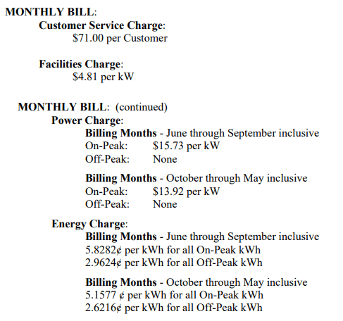

Places like Corolla, NC or Moab, UT, where there's no other charging options, should just charge whatever it takes to at least break even. Even if it makes it more expensive than gas. Then lower their prices over time as there becomes more competition.
It depends on usage. Taken to the extreme, let's say there is only a single charge in a month, peaking at ~220kW for a total of 80kWh. That could cost them ~$6,600 for the demand charges and ~$4 for the energy charges. Obviously, they can't charge a single person $6,604 for a charge. (Demand charges vary by region/utility but are often between $20 and $50 per kW, I figured at $30/kW.)
Say you wanted to get it down to $1/kWh you would need to get ~85 charges per month, or three per day. But if you have two of those charges overlap, your demand charges double to $13,200, so then you need ~6 sessions per day to keep it at $1/kWh. But that increases the chances of having three simultaneous charging sessions, increasing demand charges to $18,000. (Assuming a maximum station capacity of 600kW.) So, you would need ~8 charging sessions per day.
Do you think there is enough demand for at those sites to get ~250 charging sessions per month? Even when charging $1/kWh?
Edit: I found one rate structure for a random place in Utah:
Rivian R1T R1S 🚨 Rivian Adopts Tesla NACS Standard! (Adapters in 2024, Standard Charging Port in 2025) 1687361614526
So, demand charges are only about $20/kW. (Facility + Power). So maybe it would work at ~175 charging session per month.
