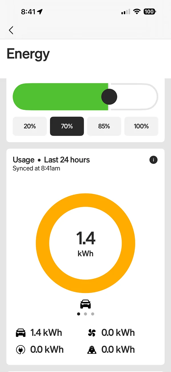

My issue could be a coincidence....
My Gen 2 had a history of very low vampire drain. But when I updated to .46 I started seeing BIG losses parked away from home. Now, even plugged in I'm losing 4.5 kWh per 24 hours. I know that can be associated with a failing 12V. The 12V failure could be coincidental...
I'm also started getting a dashboard warning to "Carry key card at all times", figured that was associated with the new .46 capability. Anybody else getting this warning? This started appearing right after the update.
I doesn't seem like there are widespread reports of 12V issues after .46?

@Budman you could hook your 12v up to a trickle charger directly for some testing…
My 12v shows normal in @Rivian Roamer dashboard.

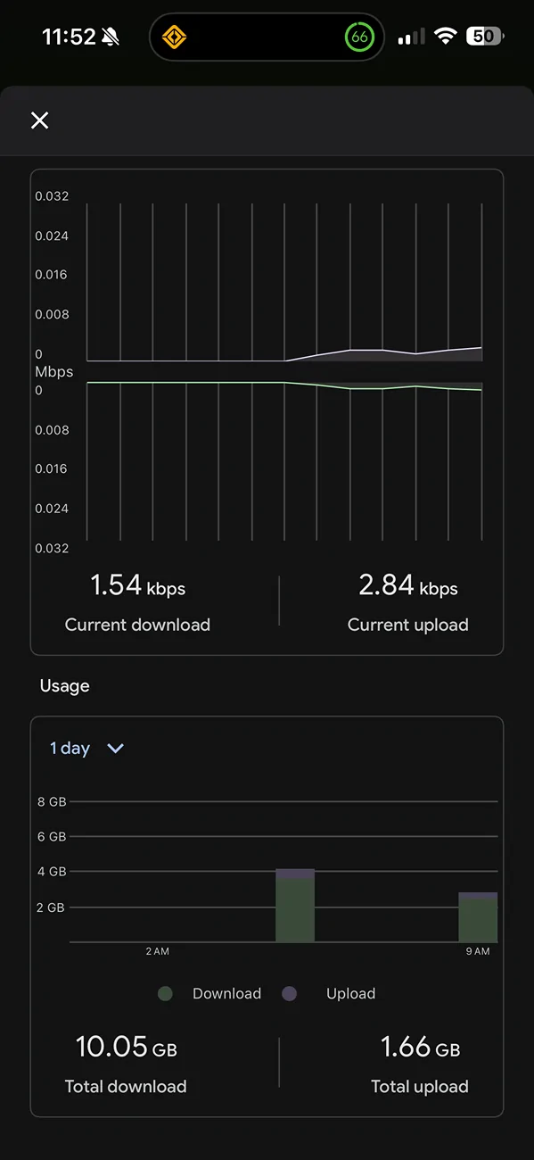

I feel like my kWh usage is all related to WiFi. I am unsure why a 10gb download in 1 day, post .46 update on a Gen 1 is for? Maybe Gen 1 is downloading the UHF data unnecessarily?
Just prior to this screen shot I ā€œPausedā€ the Rivian on my home network to see what the drain is in the next 24 hours.
This is google wifi correct? 10gb is excessive especially when an update is not being downloaded. I usually turn WiFi off when updates are not pending. I have seen large downloads have no impact on VD though.

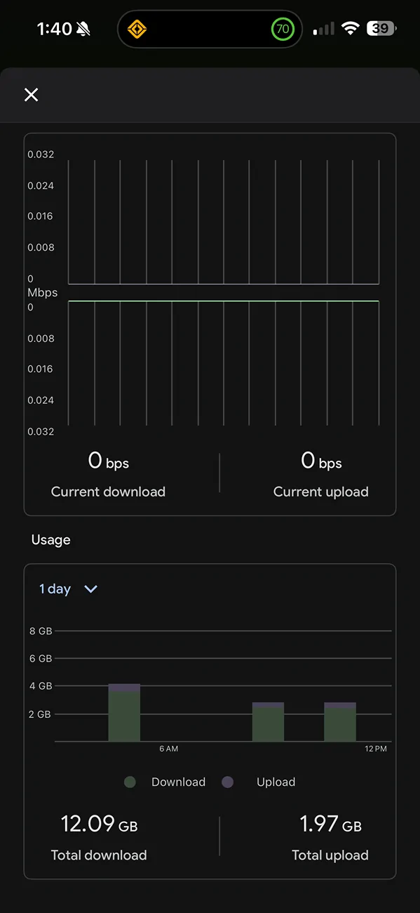

Yes Google Nest WiFi. Now showing 12+ GB.

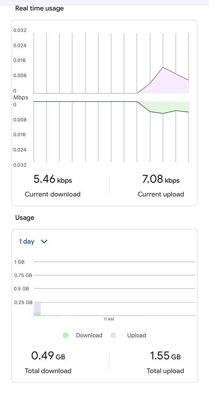

I used to see large downloads like this (ā€˜23 Gen 1). I haven’t paid attention in a while but checked just now since I forgot to turn WiFi off after the last update and don’t see anything near 12GB.

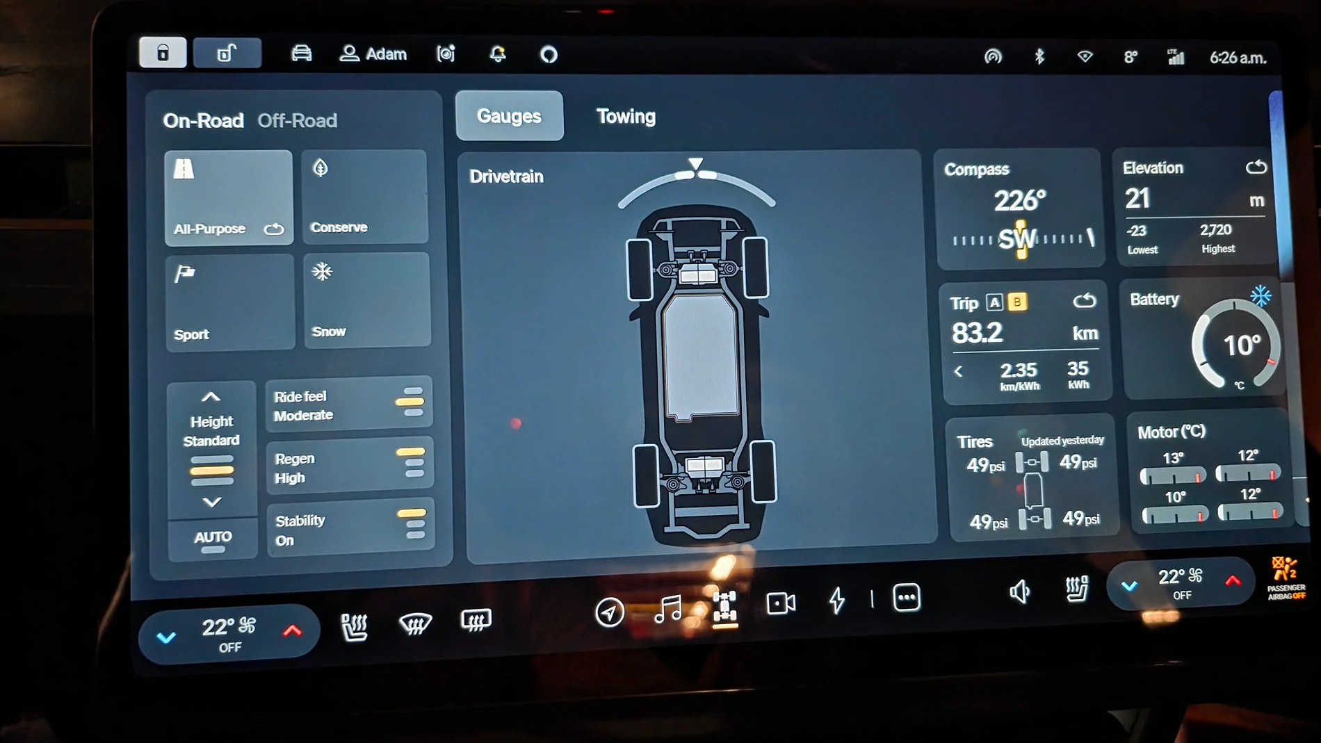

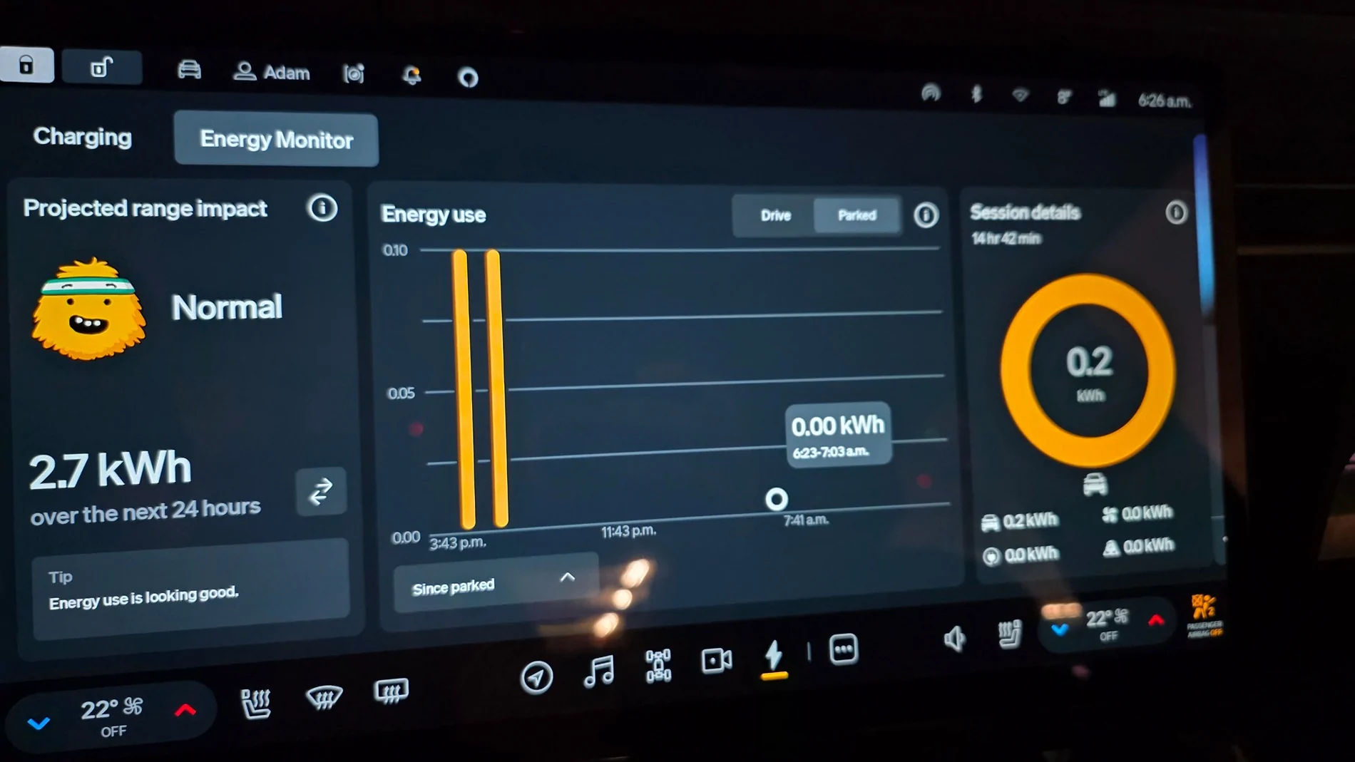

'23 Gen1 R1T nearly 15 hours, 8c weather, gear guard off, no WiFi available. 0.2kWh
I find the 24hour estimate off, but it may be accounting for me typically sitting in my vehicle at work for about 20 minutes with the heat on etc 🤷
