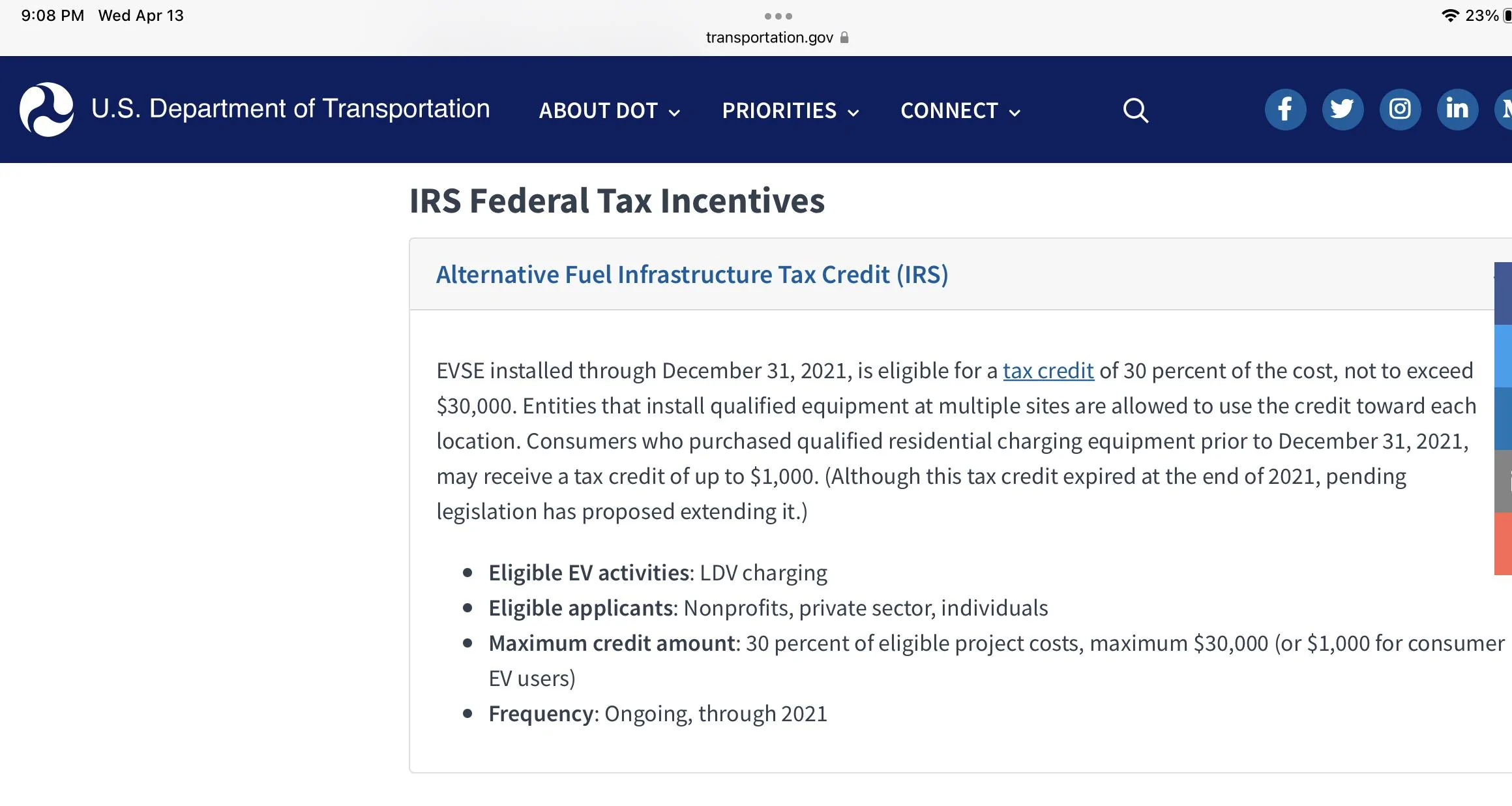

You may want to watch to see if the 30% federal EV charger tax credit gets extended again. If it does the cost of installation is covered by the credit, if the panel upgrade is required it should be included as well.
I have not heard if they will extended it but they did extend it to Dec 2020 and then Dec 2021 so it is a possibility.
edit: I did see this, looks like there is pending legislation to extend it. Might be worth watching to see if it is approved.

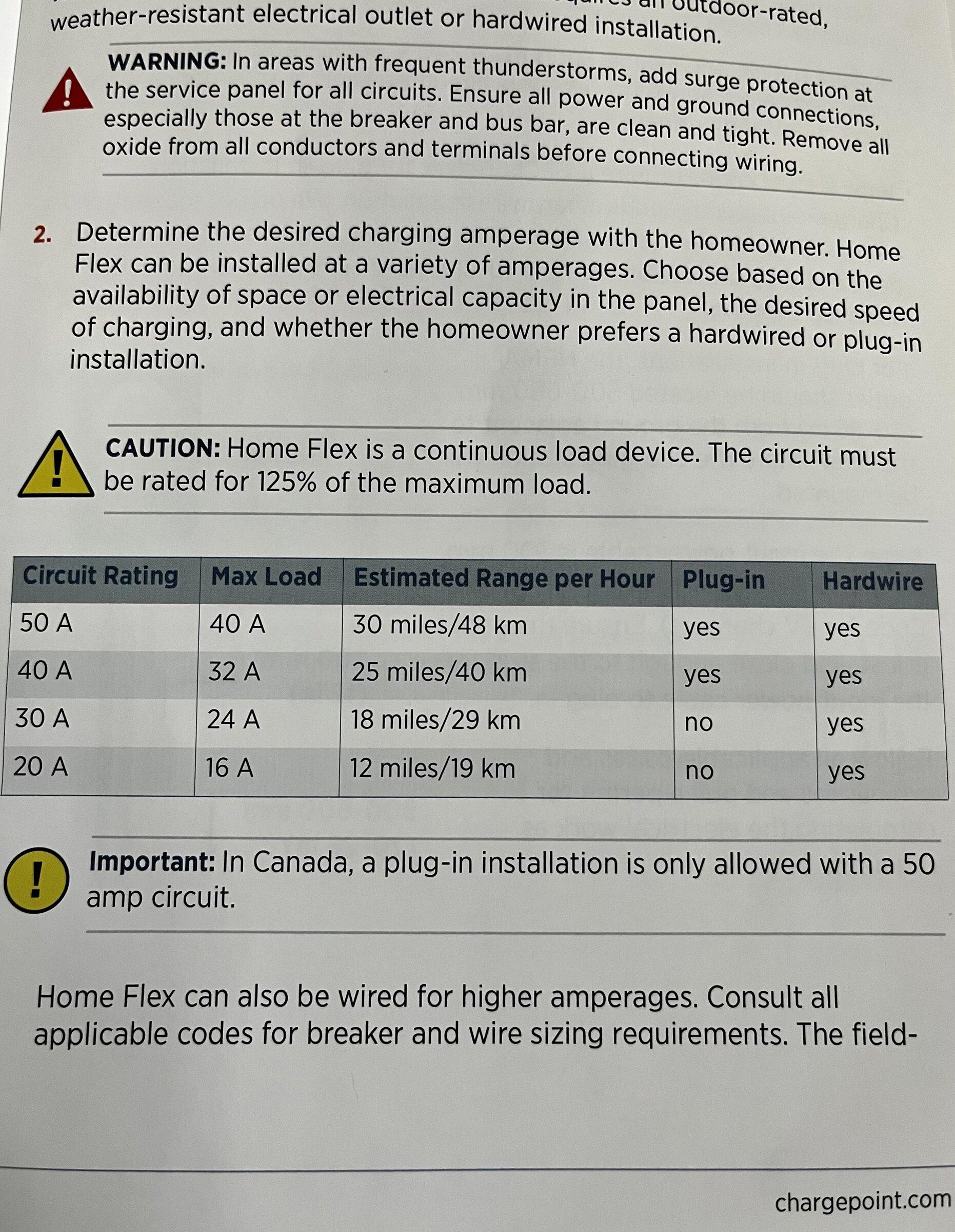

You could get something like the Charepoint HomeFlex or the Juicebox where you can set the charger to only deliver 30A. Install it on a 60A circuit, that way you at least have the option to charge higher if needed. Just make sure it's not at a time that you are not running AC, oven, etc. Nice to at least have the option.
For those reading this part keep in mind ChargePoint doesn’t approve of a plug in installation running on 30A. For plug in they recommend 40A or 50A, hard wire for more or less…
…there’s also that bit about in Canada, only 50A plug in allowed but YMMV…
That's really strange, any licensed electricians care to add their $.02? (American only, no Loonies please. Inflation)
Not always. Each province has different rules. Maybe they mean 50A maximum for plug in.
Yes, it does seem like a dubious statement but since they only endorse either 40A or 50A plug-in installations everywhere ex-Canada it sure looks to me like they are endorsing only 50A installs...

I'd venture that's just because their plug-in models likely ship with a NEMA 14-50 plug and they don't want you using an adapter for a 14-30, 6-20, etc plug.
Probably just a CYA thing.
