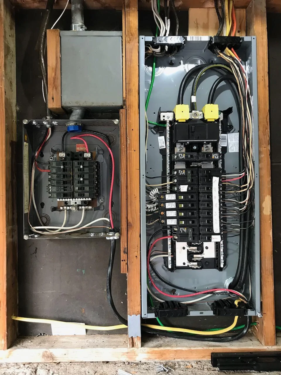

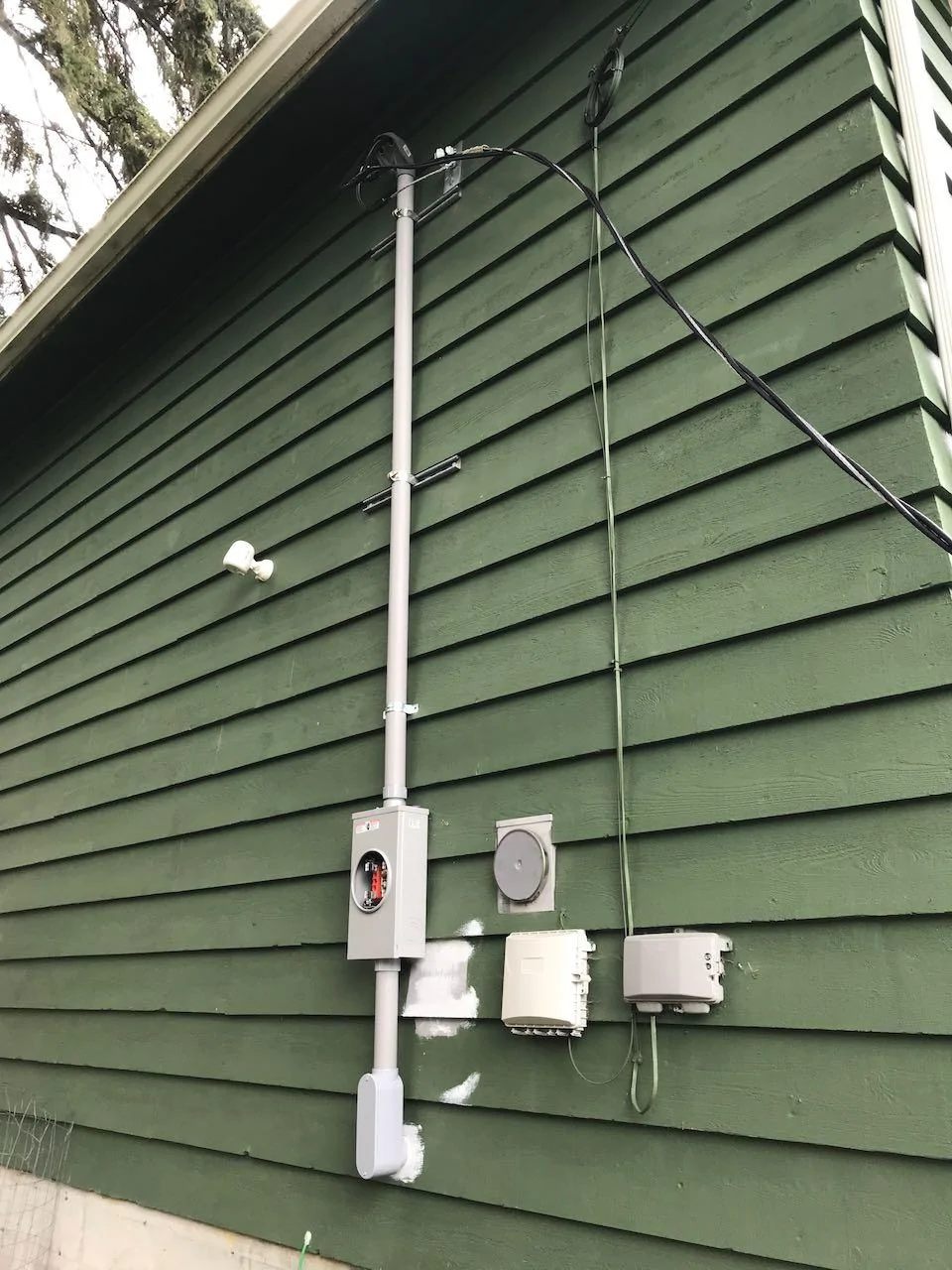

This is the secret reason I put in a new 200 AMP service on my son's house. He thinks it was to allow him to install a heat pump.
I am a licensed electrician in Oregon. His house is in Shoreline. I was there when the inspector came to look at the work, wearing my company sweatshirt. The only correction was to bond the hot and cold together at the water heater. I've never had to do that before.
Rivian R1T R1S 100 amp service not enough for 48 amp charging IMG_4747
Rivian R1T R1S 100 amp service not enough for 48 amp charging IMG_4746
I had to re-feed the old panel because the range wire wasn't long enough to reach the new panel.
