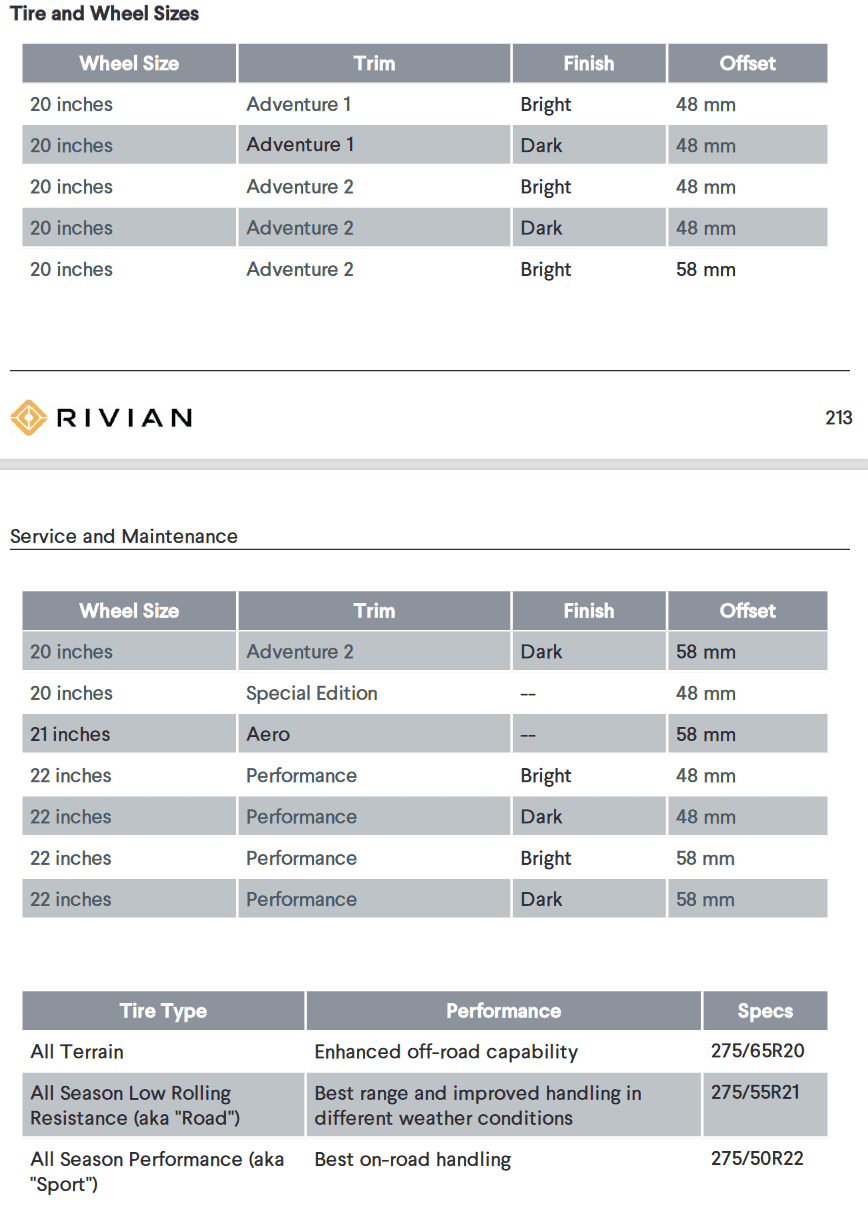

dp351
Aug 17, 2022
264
470
Ariel Atom, R1T
Rivian R1T R1S Tested 35" tires on the R1T - for offroading / overlanding 1672632419278
Someone shared this in another thread. It shows stock offsets are 48mm or 58mm, depending on the wheel.
Rexbo
Rexbo
Oct 9, 2022
101
391
Ooo this is fantastic! I'm gonna do some math and I think now that we have a known maximum backspacing (inner limit) and a maximum outer limit... This should get interesting!
