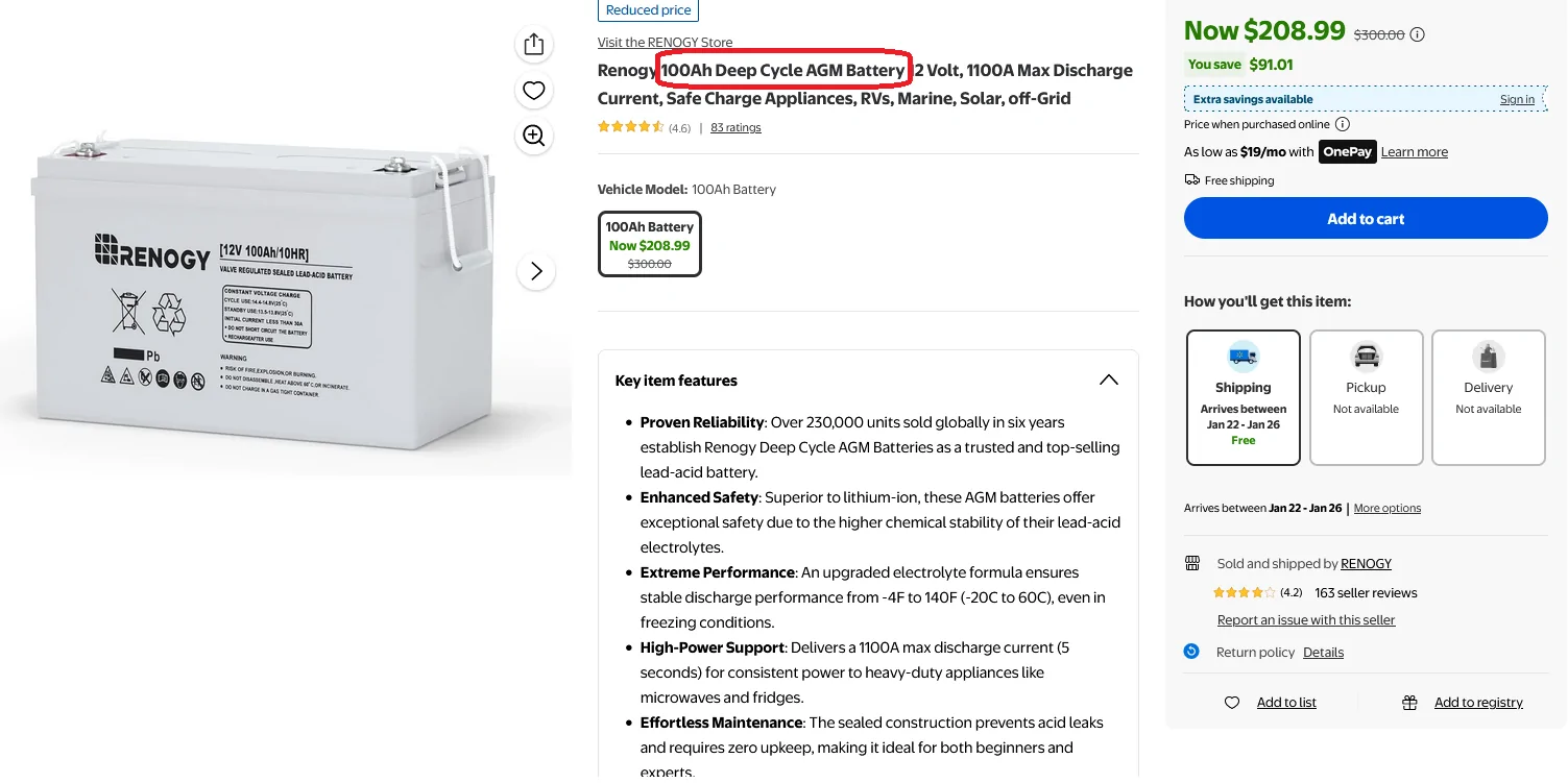

If you really wanted, you could always get a standard size Deep Cycle Marine AGM battery and relocate the OEM leads so the battery would go (in a marine battery box $25) inside the frunk.
A standard size 100Ah Marine Deep Cycle AGM battery would probably last forever in the R1 vehicles.
Battery is part of the safety system. In a crash, the frunk mount may shear off and cause loss of 12v power, much easier than the original mount.
