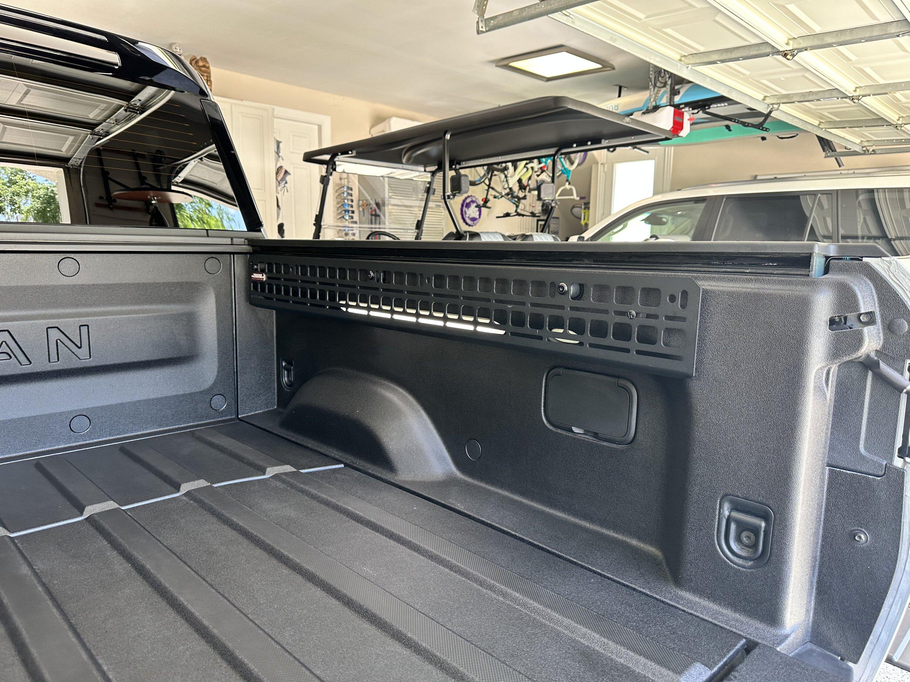

Nice. I was looking at these too. Does it block bed light at all? Doesn't seem to bad from your photos.

While the grid itself is robust... how robust are the mounting points on the truck? Would be nice to know how much weight they can hold, to determine what could be mounted and what should be avoided.

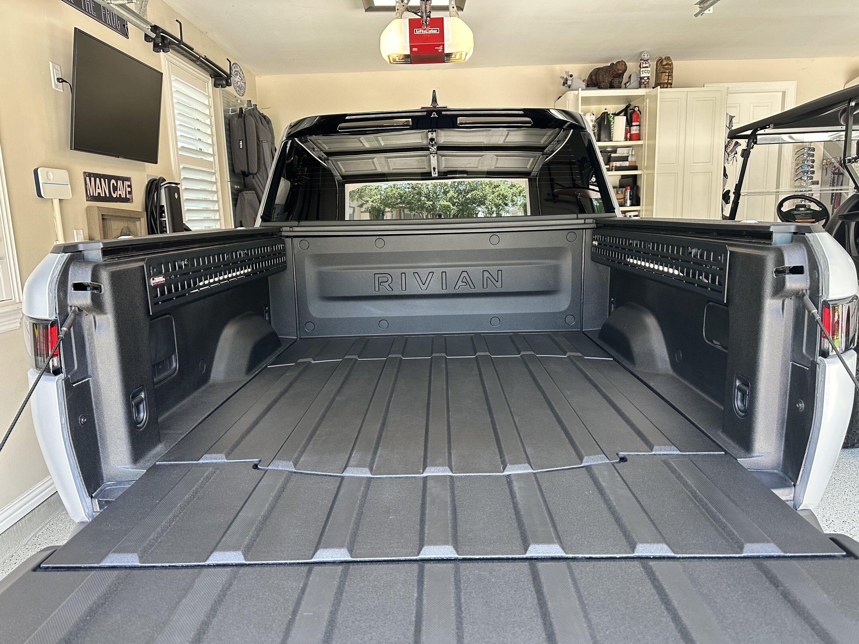

i have been thinking about these as well as the one on the back of the bed. how do you think all three would look and function?

Interesting, nice thing too is you get a lot more options for tying things down

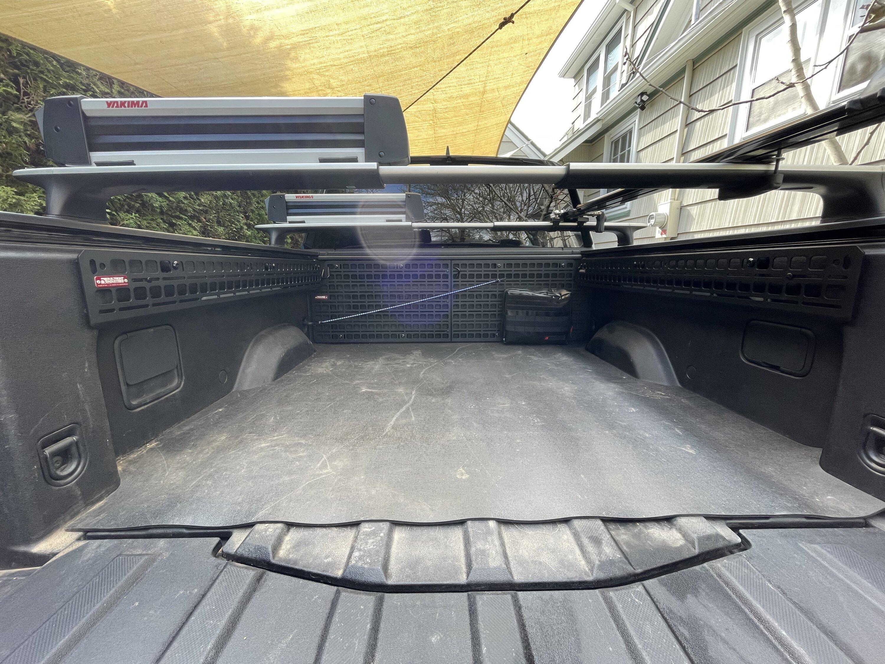

all 3 panels. Fits like a glove. They bolt onto the frame itself. Should be pretty sturdy.
p.s. bedliner is from evsportline.
Rivian R1T R1S Builtright Bedside Molle Panel Kit installed in R1T bed IMG_2509

Stumbled upon this thread--I just DIY'd some aluminum L-tracks down both sides of the bed, and can definitively say that those M6 mounting points (the ones under the plastic circular caps) are NOT MEANT TO BE LOAD BEARING--they are only meant to hold down the plastic bed liner.
The M6s bolt into a rivnut, which is rivetted into a thin sheet of aluminum . I know because when installing the L-tracks, one of the rivnuts became stripped then started spinning freely, so I had to remove that side of the plastic bed panel, replace the rivnut and added some JB weld on the backside to stop it from spinning.
I plan to use the L-track mainly for securing light loads (basically to keep it from shifting). The big torx-bolts that hold down the D-ring shackles in the bed (of which there are only 2 on each side) are into the frame and are meant for securing anything of substance...
