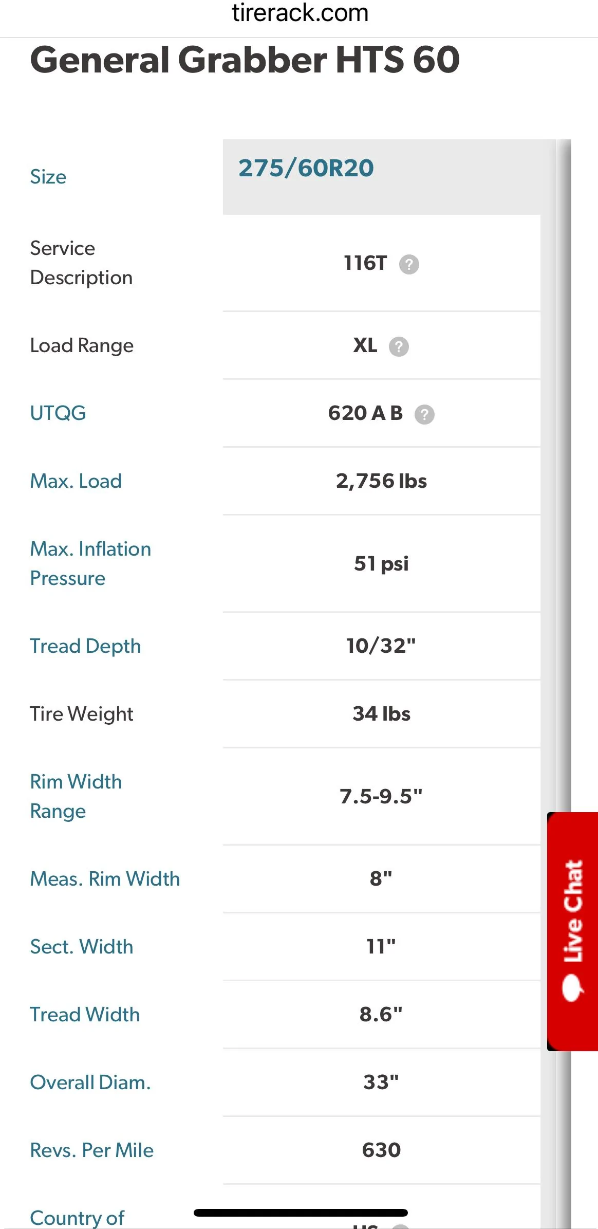

Agree, the big question is do you want >350 miles of usable range, or are you ok with only <220 miles usable range…seems like a very easy decision to me…
that said, I’m sure there is a small group that’s totally happy with going 200 miles between charges…
ksurfier
Ken
Aug 23, 2022
62
1,404
1,421
R1S, Tesla
Fake Science Lead
That’s the tire you want then:
General Grabber HTS60 275/60R20:
34 pounds
$212/tire
Rivian R1T R1S 20" tire recommendations IMG_2717
