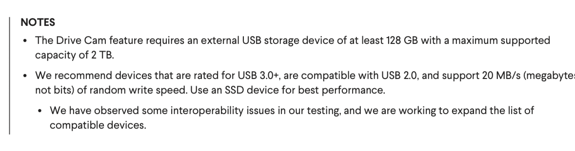

When I tried to format it from within the truck, it gave me an error message during formatting saying I needed 512 or above, but not more than 2TB. My 128gb card worked prior to the most recent update.
I accidentally plugged in the old 16GB thumb drive and it gave me an error saying I need to replace the drive, but no mention of minimum storage requirement.. ?
Try formatting it. At least on mine, that's when I got the message about what size it needed to be
Rivian said that you will want at least 128Gb drive. They should include that in the error message though.

Truck says minimum of 512, maximum of 2TB. I had a 128 and it didn't work.
Rivian R1T R1S 2023.14.0 Software update released 1683136917672
A 128 GB USB-C thumb drive worked for me.
Looking further, I guess I could have been wrong. I just plugged in the thumb drive to my computer and it's only a 32GB drive, so wouldn't work either way. I just glanced at the warning message, surprised it didn't work. Immediately pulled it out to plug it into the computer as I was sure it was a larger thumb drive capacity, but clearly I was wrong about that too. Worked fine for saving gear guard videos but not adequate for this new set up.
Sounds like 128GB is the more accurate number based on several others posting. Sorry for any confusion.

I went the ultra-cheap route to avoid having a cable running to a separate drive. I had a flash drive in there, turns out it was only 32gb, where the update now demands at least 128gb. This one is 1TB. Plus, it's a type C so no adapter needed.
www.amazon.com/gp/product/B0BVG1W7X8/ref=ppx_yo_dt_b_asin_title_o00_s00?ie=UTF8&th=1
USB3.1 Flash Drive 1TB,USB C Thumb Drive with Type-c and Micro USB Port,Computer Memory Stick Drive for iPad Mini,Ultra External Storage Drive USB C Stick Drive for Android Phones and Computer (Black
Ordered last night, received today. Can confirm this one works. Good option for under $30.

Curious, did it come with specs to say what the heat range is for use or for storage? I think most standard drives are only rated to around 45 c (114 F). I think one not designed for extreme temps will fail frequently in the summer, eve mild days exceed 120 in less than an hour.
