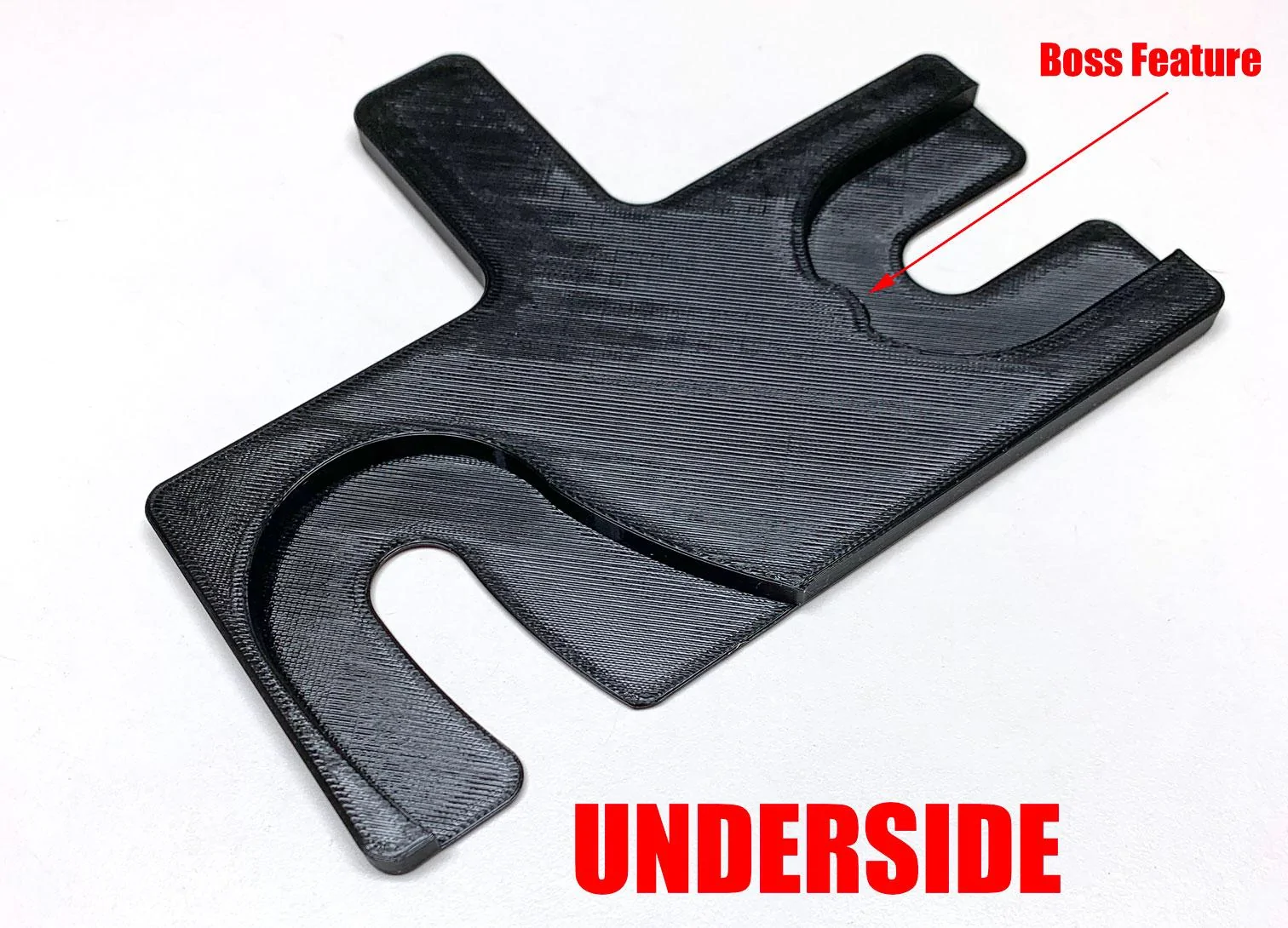

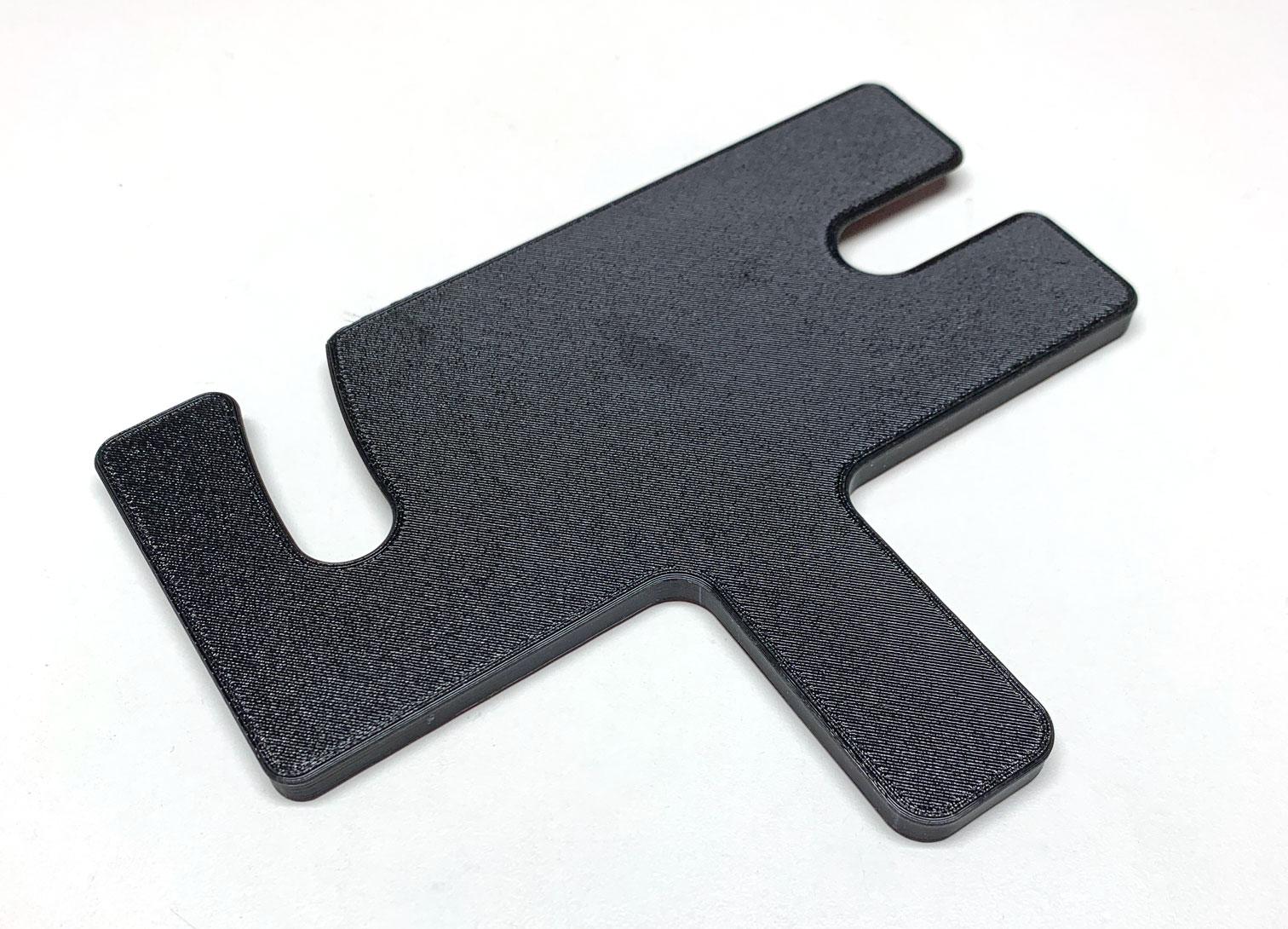

I struggled to get both the left 'button' (which protrudes from the flange surrounding the rod) and the right button (which is flush with the flange and must be pushed in past the edge) pushed in at the same time. So I designed a simple tool that presses both buttons. The slot on the right side of the tool is lined up with the right post (perpendicular to the head restraint) and pushed in until it stops. Then the tool is rotated clockwise so that the curved slot on the left of the tool engages the left rod of the head restraint.
As you can see from the photo of the underside of the tool, as the tool is rotated in and under the head restraint the right button is pressed in by the boss feature and the left button is pressed in by the edge of the arc/recess. It took three tries to get the dimensions just right but it's ridiculously easy to use and works as intended.
I can post the stl file and/or the Solidworks file if folks want to print or remix the design.
