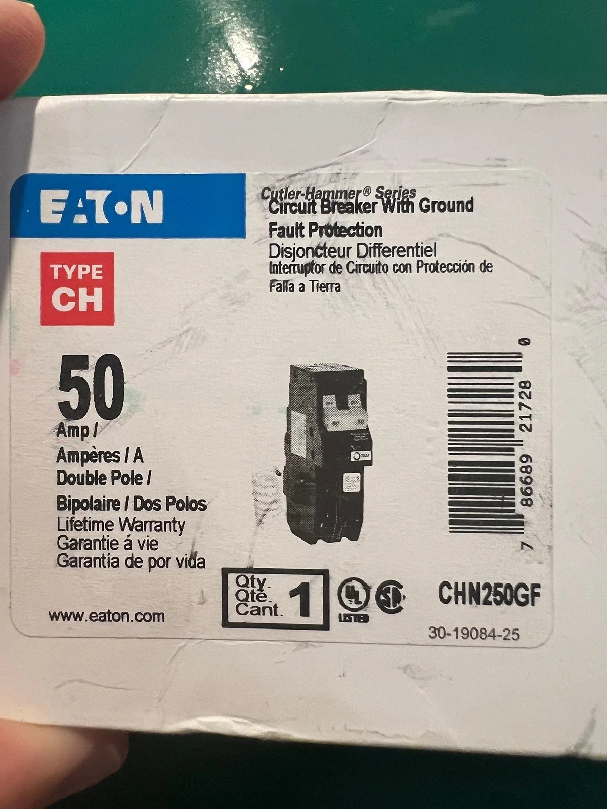

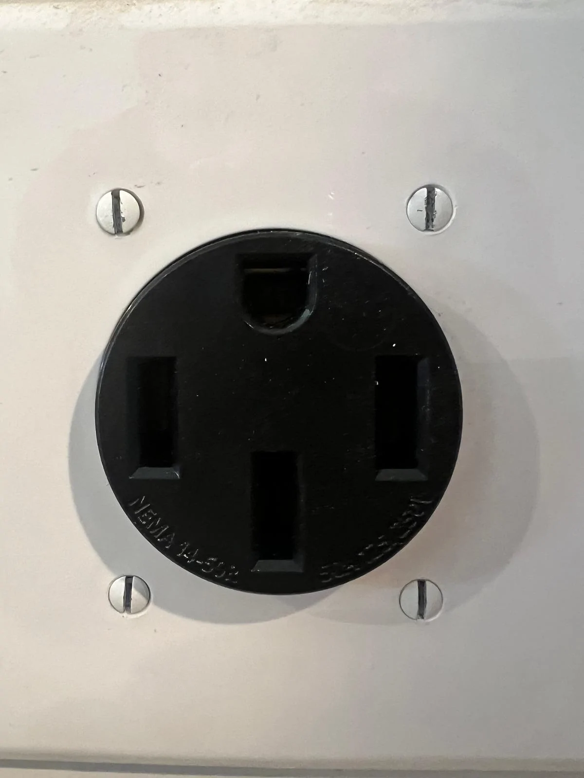

*Update*
Electrician came out today, only $275 because the work needed was so minimal
-We confirmed that 6-gauge wire was already in use, ready to take on up to 50 amps (40 amps continuous)
-swapped out the breaker
-and replaced the outlet with a NEMA 14-50.
-Now just need to order ChargePoint EVSE and eventually take delivery of my R1S
