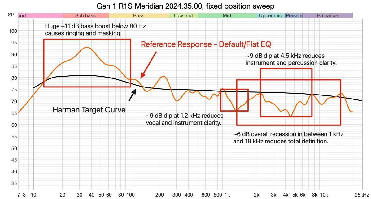

I measured @skyote 's Gen 1 R1S Meridian system with OTA 2024.35.00. Its release notes don't mention changes that affect sound quality so I expect it to behave the same as 2024.27.01 when Rivian implemented Atmos in all vehicle models aside from Gen 2 Standard. See my previous Gen 1 R1S post to understand the sound-quality-related changes that 2024.27.01 brought. This post focuses on improving the sound quality of the Gen 1 R1S Meridian system with OTA 2024.27.01/2024.35.00.

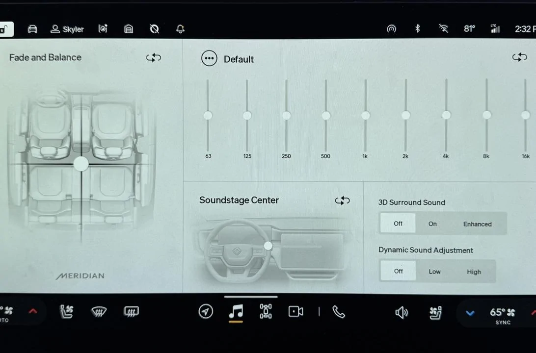

  • Flattened the EQ using the Default setting.
  • Turned off 3D Surround Sound and Dynamic Sound Adjustment.
  • Set Fade and Balance and Soundstage Center to default.

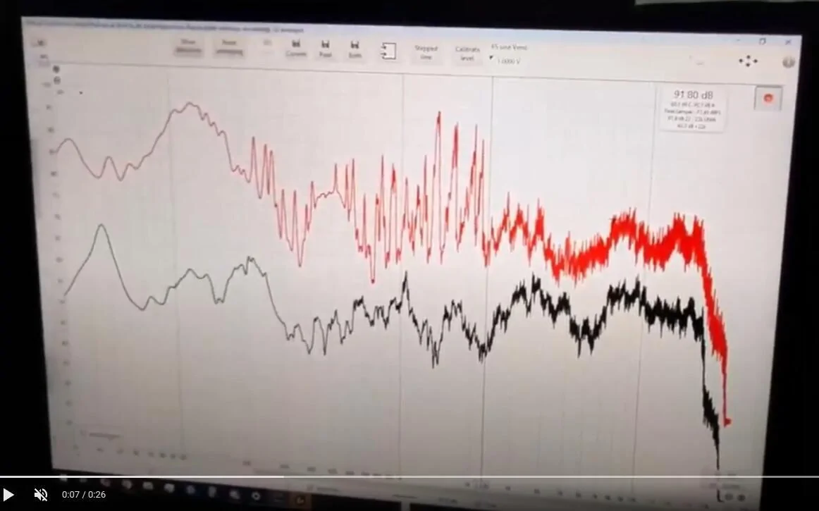

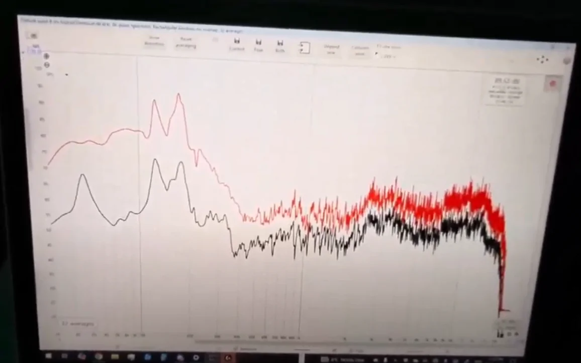

As mentioned, I ran sweeps from 10 Hz to 20 kHz with the microphone in a fixed position where the average person's head would be (in front of the headrest) and RTA with full-bandwidth pink noise while moving the microphone in 3D space. I explain in detail why we take frequency response measurements and how it influences EQ changes here.

The first thing that jumped out at me was that the bass was too hot, confirming the cause of the clipping issue I had earlier. I'm a bass head but it boomed, rang, and overpowered the rest of the music.
Listening to Send My Love by Adele, vocals were muddy. The kick drum rang. The snap of the acoustic guitar strings lacked definition.
Listening to Lost Cause by Billie Eilish, vocals were similarly muddy. The slap bass rang and lacked definition in its attack.
Those results conformed with the recessed region between 1 kHz and 18 kHz I saw in my measurements.
Honestly, I was a bit puzzled by this result. I remember the Gen 1 Meridian system measuring and sounding much better than this. But auditory memory is notoriously unreliable. What mattered was how much I could improve it.

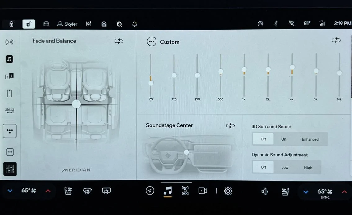

After making numerous EQ tweaks and listening to many more tracks spanning genres, I arrived at the following settings.

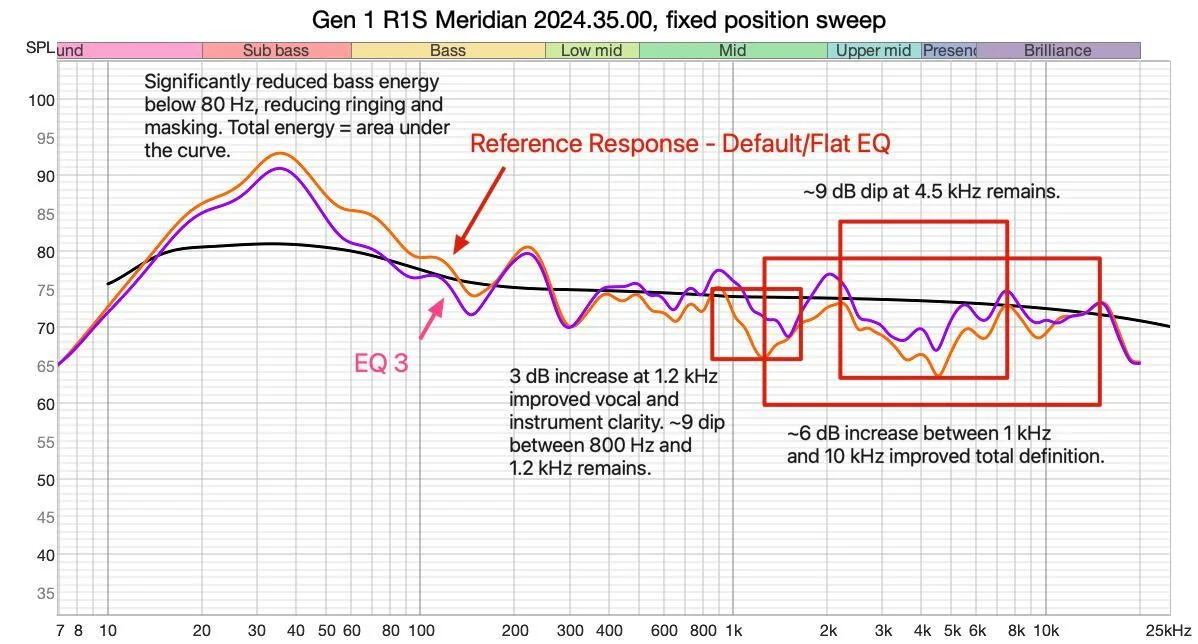

- EQ # 3 -
(Why didn't I post EQ attempts #1 or #2? Because they lengthen the post and people care about the "best" settings, anyway.)
63 Hz -4, 125 Hz 0, 250 Hz 0, 500 Hz +2, 1 kHz +3, 2 kHz +3, 4 kHz +4, 8 kHz +2, 16 kHz +1
These settings addressed the boomy bass and recessed mids and high regions.
The purple line is the response curve after applying EQ 3. The orange line is the Flat EQ response curved used for reference.

Listening to Send My Love by Adele, vocals were much clearer, though still lacking the sharp definition I expected from the Meridian system. The kick drum tightened up. The acoustic guitar's definition improved but, again, not as sharply as I expected it to given how much I boosted it.
Listening to Lost Cause by Billie Eilish, vocal clarity improved. The slap bass thumped more solidly, though still rang. Cutting 500 Hz reduced ringing but left bass guitars and kick drums sounding hollow.
Listening to Crush (Live at Radio City Music Hall) by Dave Matthews, his vocals were chesty and clear. Tim Reynold's acoustic guitar was reverberant. That said, both lacked the resolution I was expecting to hear.
This was the best I got it to sound during the time I had with Skyler's vehicle.

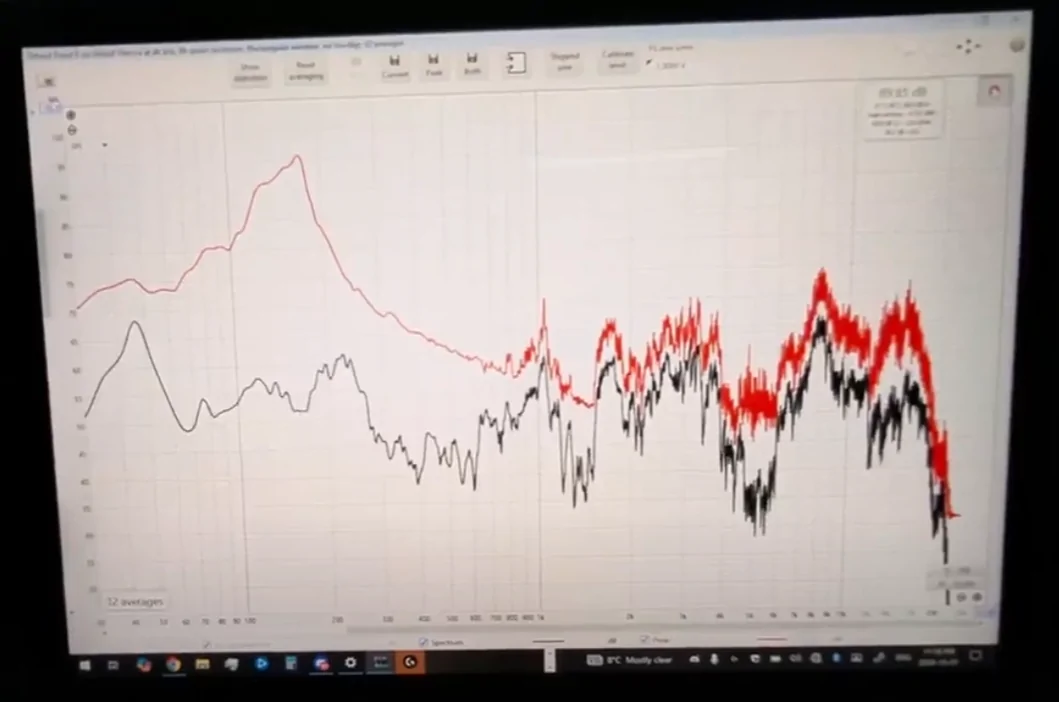

I have a R1S Launch Edition with Meridian Audio. I just got it recently, and it had 2024.31 installed. The audio sounded awful. I even posted a thread about it here: https://www.rivianforums.com/forum/...tion-w-meridian-audio-defect-or-normal.33426/
2024.31
Pretty much only the front center speaker was outputting any sound. The bass sound was insanely high. You can see the ridiculous dip at 4-6K and the ridiculous peak at 8K - leading to pretty much any song losing all clarity at the normal vocal and instrumental ranges.
I applied MAJOR EQ adjustments which helped a bit, but the sound was still awful.
2024.35
Instantly noticeable how the sound is SO much better. The ceiling speakers now actually work, instead of being completely dead. The pillar speakers are the appropriate volume. You can't tell the direction the sound is coming from, it's coming from all around.
I applied a few minor EQ adjustments (mostly only 1-2 notches) to tighten things up, these are also included in the picture below.
Honestly, I was thinking of selling the R1S I just bought, because of how bad the audio was on 2024.31. Now I can actually keep it.
Check out the graphs below, it's very obvious what's good and what's not (Tesla still has better audio, but not by much, and the much smaller cabin size is a huge advantage for the Tesla).
2022 R1S LE w/Meridian - 2024.31
Rivian R1T R1S How to Improve a Gen 1 Rivian R1S’s Meridian Sound System After Update 2024.27.01/35.00 With Simple EQ Changes 1728093948232-pq
2022 R1S LE w/Meridian - 2024.35
Rivian R1T R1S How to Improve a Gen 1 Rivian R1S’s Meridian Sound System After Update 2024.27.01/35.00 With Simple EQ Changes 1728094154713-p6
2022 Tesla Model Y LR for reference:
Rivian R1T R1S How to Improve a Gen 1 Rivian R1S’s Meridian Sound System After Update 2024.27.01/35.00 With Simple EQ Changes 1728094040432-jj
Edit: Note that all of the above EQ readings are of white noise generation, not of any specific audio track.
  • Turned off climate control to reduce in-cabin noise as much as possible.

Q: Is the system louder after the 2024.27.01/35.00 update and is it a good thing?
A: It's likely louder and that's a good thing.
Low volume was a big complaint before the 2024.27.01 update. 2024.27.01 boosted volume (likely via DAC output) considerably, improving sound quality significantly. (A detailed explanation of why here.) However, I couldn't accurately measure the difference in volume of Syler's R1S before 2024.27.01 and after because of the clipping issue I mentioned earlier. What I did record, however, was that I reached listening levels in his vehicle at volume 16 prior to 2024.27.01 but at 12 after 2024.35.00. That leads me to conclude that the update boosted the volume. I'd wager an increase in DAC output was the cause.

- Flat EQ -

- EQ # 3 -
