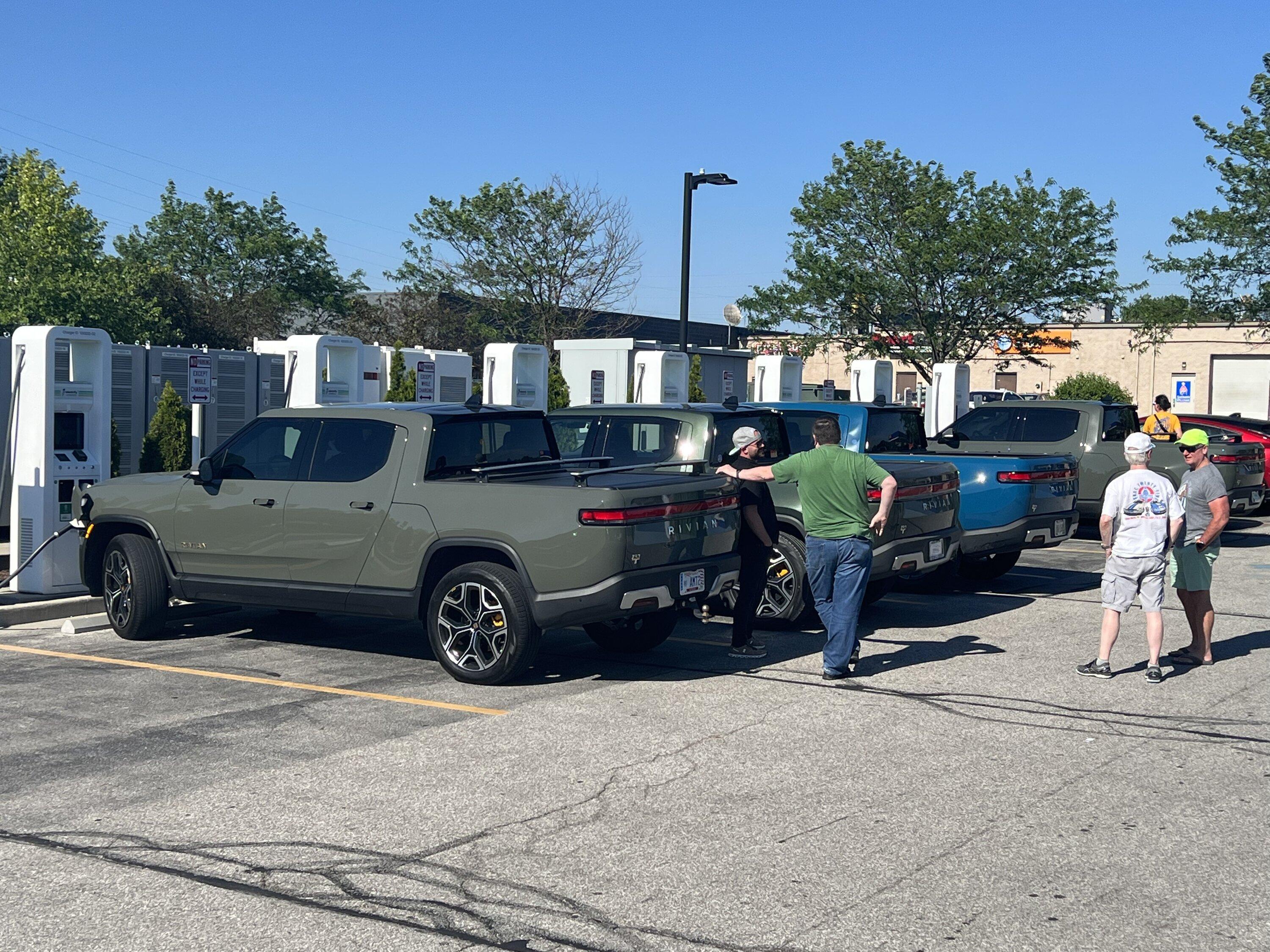

Great to read this as I may be doing a road trip to Denver area later this year. I just did an 800 mile trip Thursday-Saturday from Traverse City, MI to Indianapolis and back. It was my longest trip to date. My efficiency was 2.36 (pretty flat with 8-10mph headwind on the way back north). All EA charging with only one plug that would not work, plus some free RV charging (it would only pull 34 amps on a 50 amp 14-50 plug) at Indianapolis Motor Speedway.
A highlight of the trip was parking next to 3 other R1Ts at the EA station in SE Indianapolis! Two of the owners are Rivian employees - great speaking to them!
OMG, I was there. Lol.
