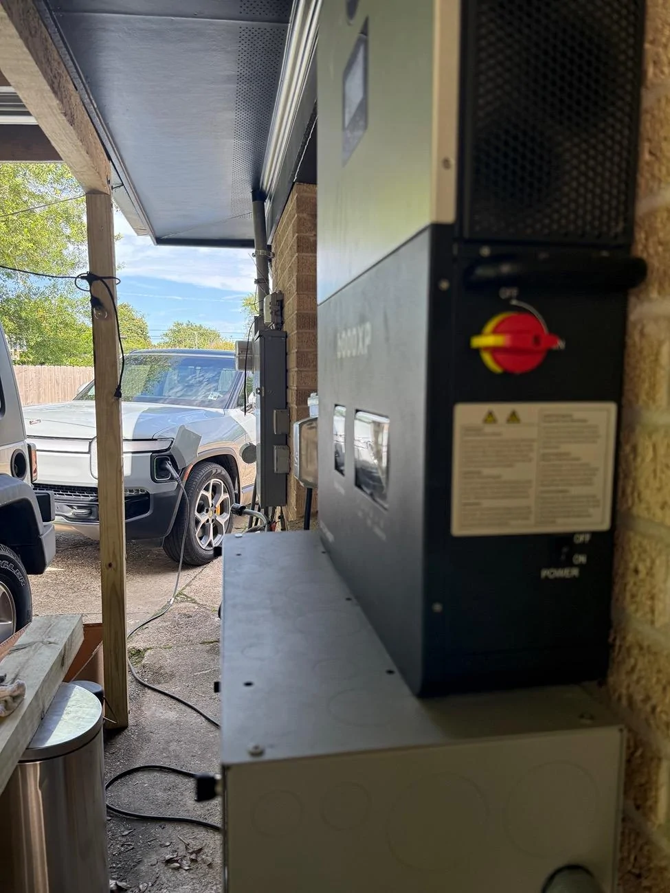

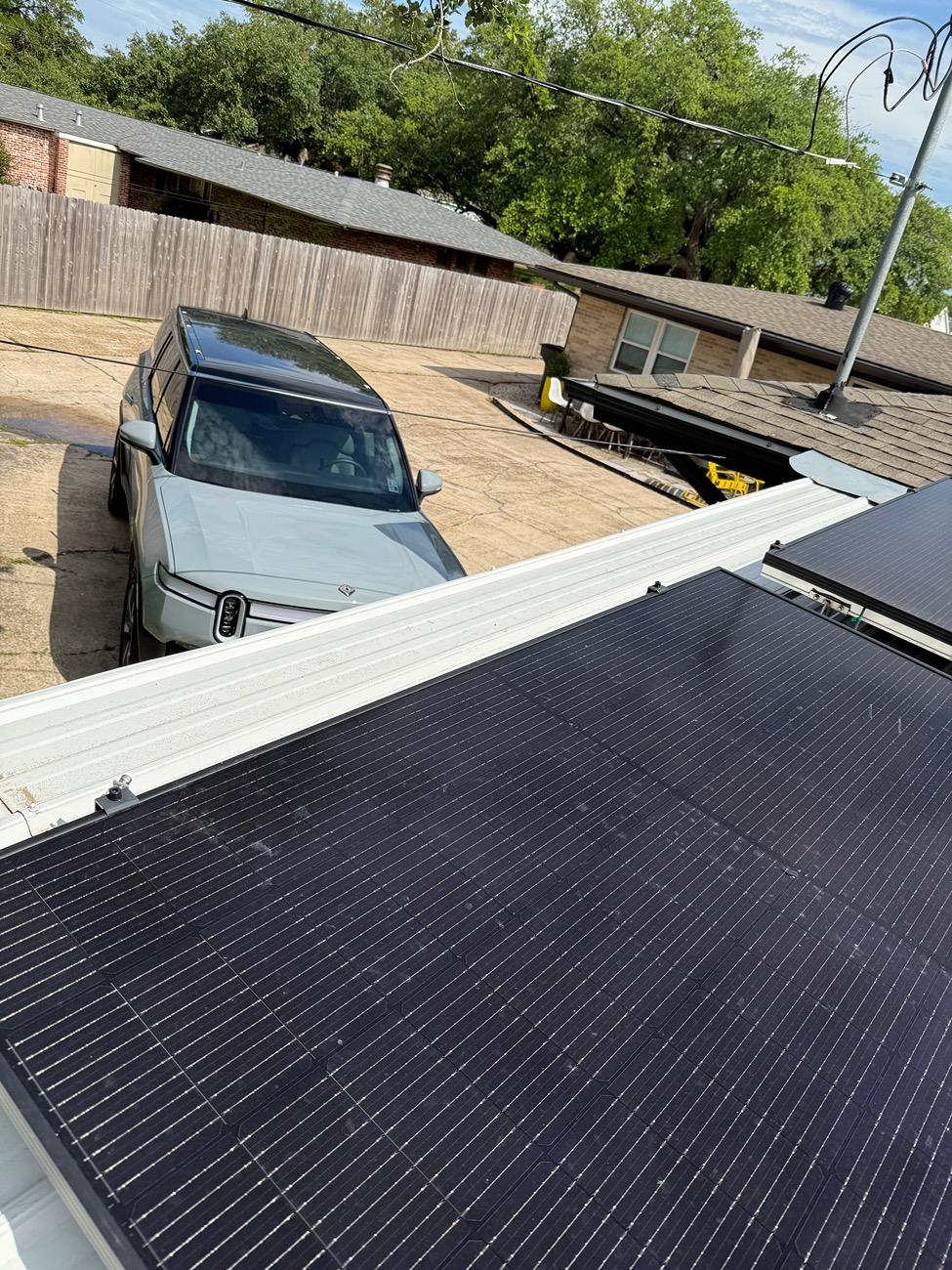

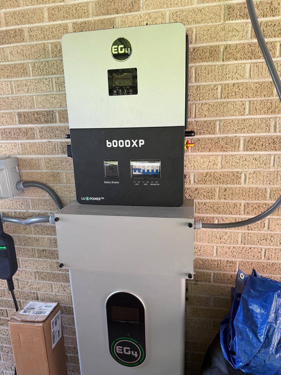

This was more of a science experiment but I added 10- 400 watt panels, eg4 6000xp, and eg4 14kw battery. Two days in and I am maxing out the battery which provides enough charge for the car. In total the project cost about $8k, so a 15 year payback.
Rivian R1T R1S I built a ‘fueling station’ with 10- 400 watt panels, eg4 6000xp, and eg4 14kw battery IMG_0350
Rivian R1T R1S I built a ‘fueling station’ with 10- 400 watt panels, eg4 6000xp, and eg4 14kw battery IMG_0352
Rivian R1T R1S I built a ‘fueling station’ with 10- 400 watt panels, eg4 6000xp, and eg4 14kw battery IMG_0353

I am charging at 25A vs 48A. I drive less than 20 miles per day so I am using roughly 10kwh. Yes it is half as fast as my wall charger but I am asleep while it charges. This setup was also to have additional power when the power goes out and not buy a standby generator.
I have a carport not attached to my roof so I wanted to use this space.

My girlfriend drives a M3 and I could up the R1S charge to 85%. I have not figured out what to do when I am out of town. I may just turn the system off. Or I could add a transfer switch and run the house.

I wish payback was that good. I am at .12/kwh. So about 600/year. But it beats paying $600/year on a service contract for a standby generator.

I have a 70 year old roof and I know it’s only a matter of time before I need to replace. At that point I will add whole home. I could fit a 12kw system and I can now save about $10k as my off-grid has battery backup.

10 panels - 1k
6000xp - 1500
Battery - 3500
Parts/materials/labor - 2000
I could have bought a bigger inverter but I knew I would not exceed 6000 watts on this off-grid setup. Also I am only charging at 25A so I am ok with the slower charging. All in all this set is sufficient if you drive less than 40 miles/day.
