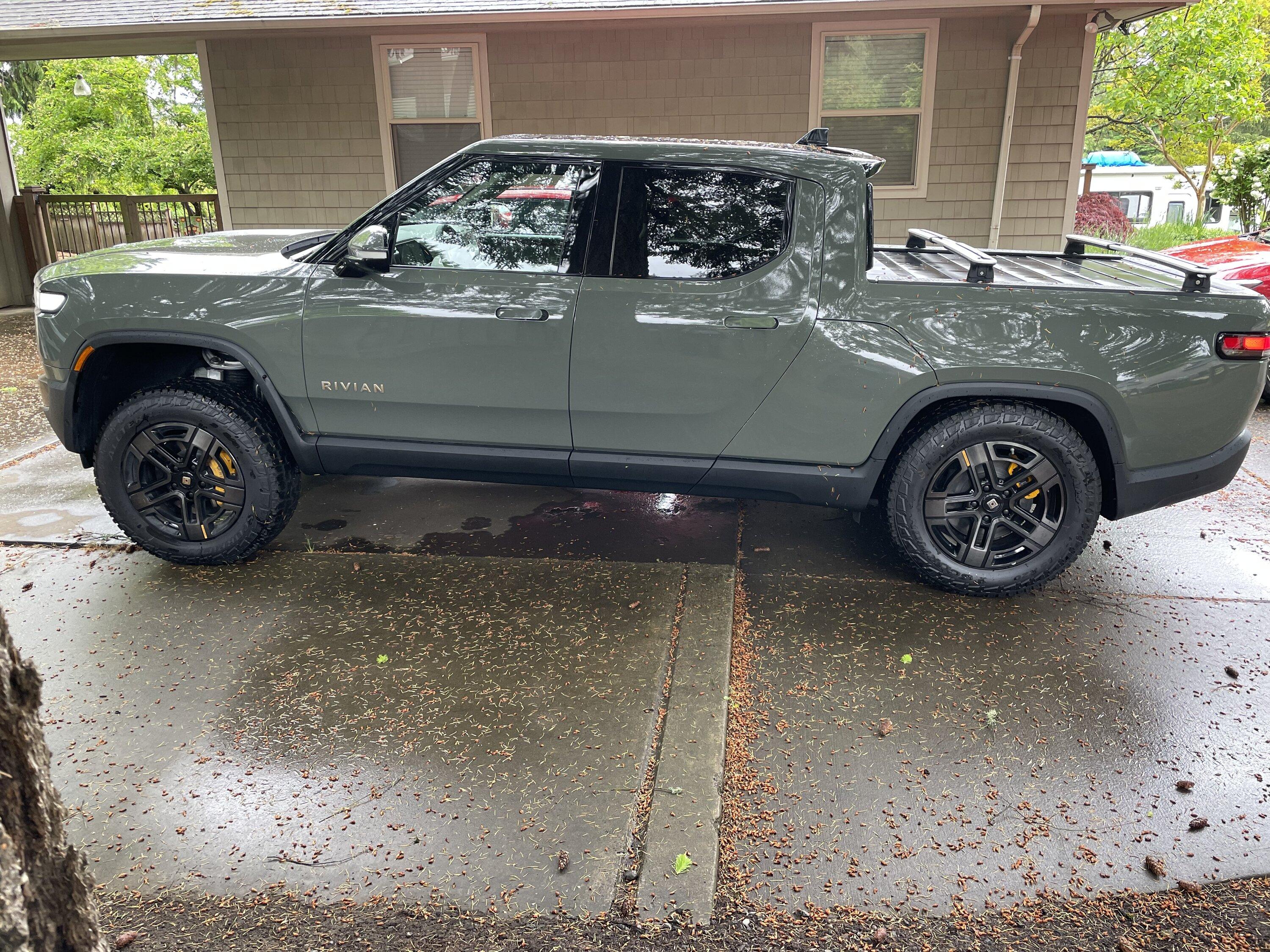

I had a leak in my front tire, so I decided to swap out the spare so I could drop the bad one off to get looked at.
Followed the procedure exactly, got the tires changed, and then went to take the truck out of Off Road Highest and only the back end will drop. Tried several different drive modes and heights, as well as going back into and out of tire change mode.
Eventually, called service and they had me do a vehicle reset to no avail. So, now waiting for a call back to see what's what.
And here I was hoping I'd be a lucky one with no issues ;)
photo evidence

I put the truck on high and decided to see if driving it a bit would fix the issue. Turns out it did, almost immediately the truck leveled itself out - not sure why it wouldn't do that in the driveway.
NeuronBasher

My delivery person mentioned that height changes go much more smoothly when you drive, even if it’s not far. Definitely was the case when I went to highest to try it out.
How much driving did it take?
