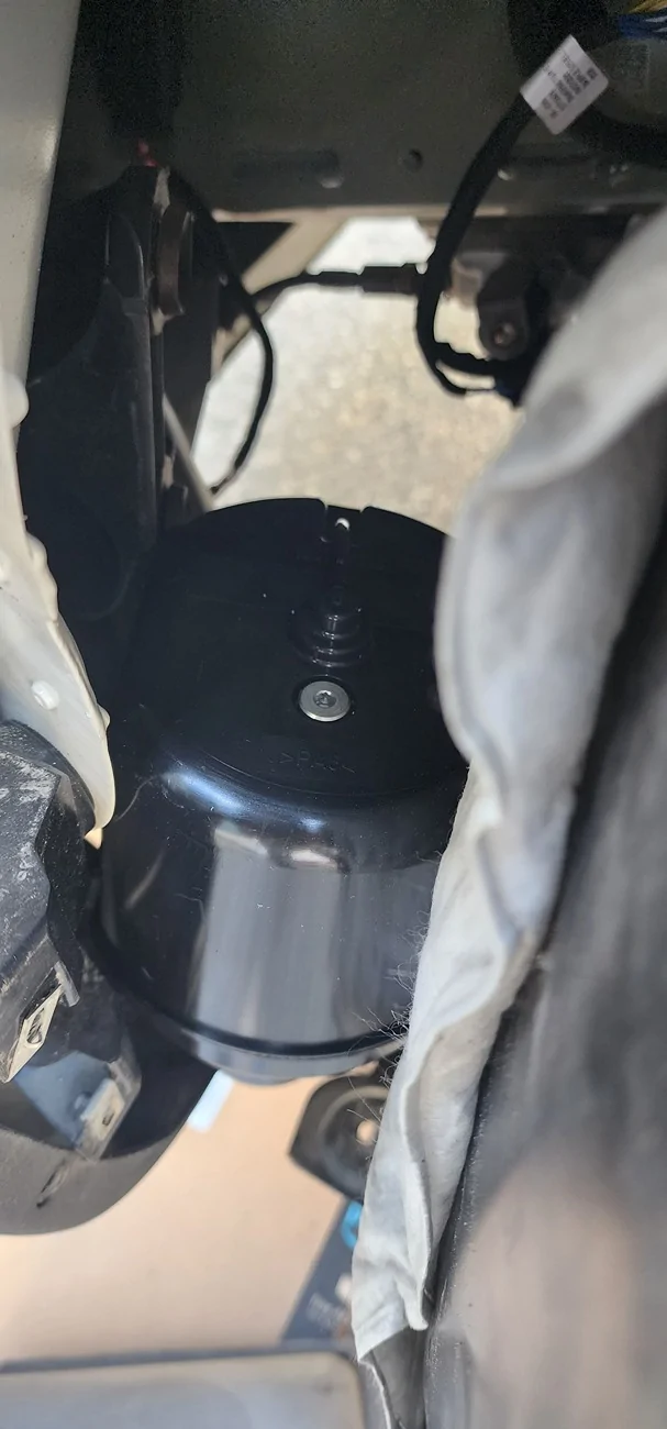

I'll have to dig up a picture I took of it. But no further disassembly is needed once you get it out of the foam shell. The reservoir tank is the round plastic tank on top with a small hex plug,you remove the plug and fill it with a tiny funnel and a piece of tubing. It's a slow process as the hole is small and have to wait for air bubbles to come out as you fill.

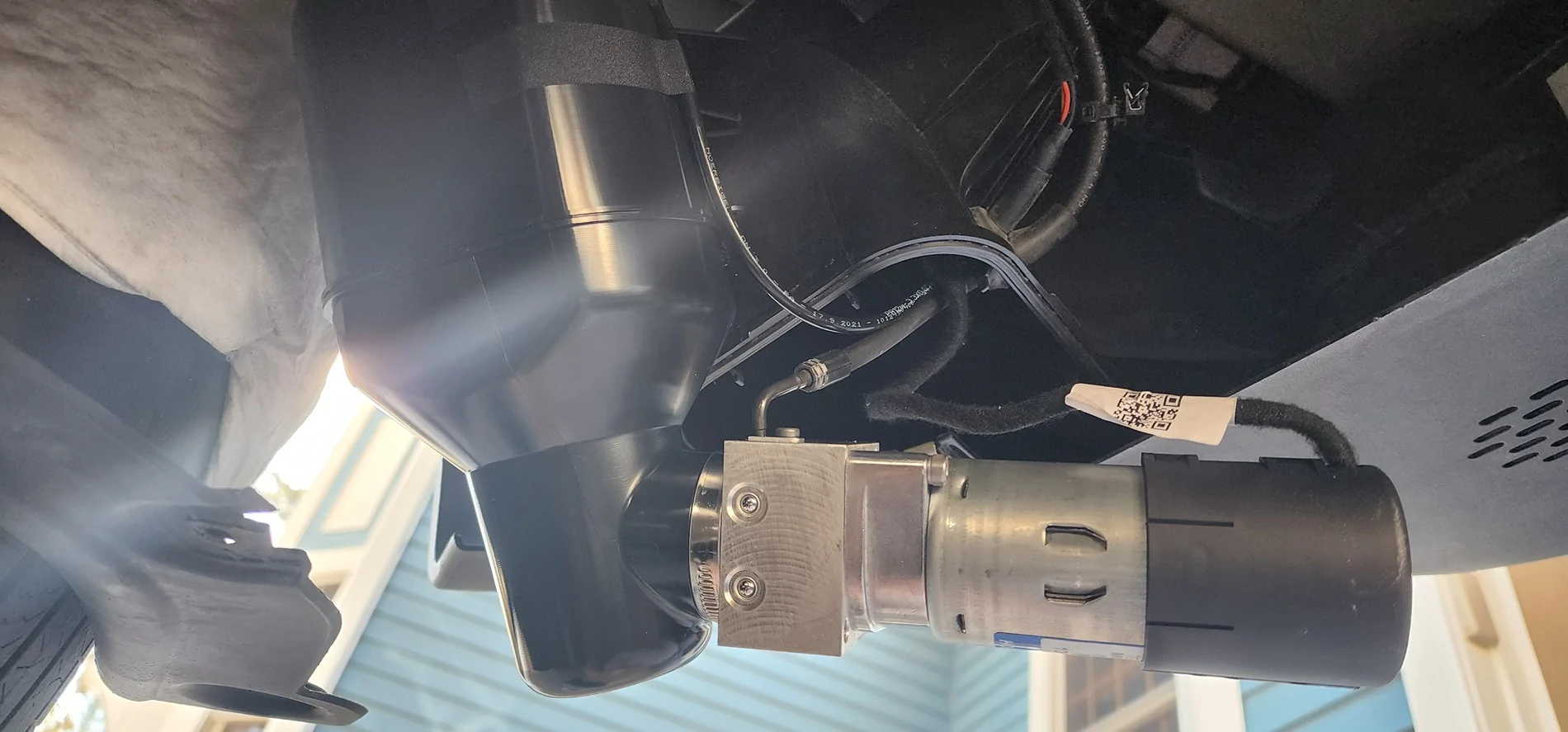

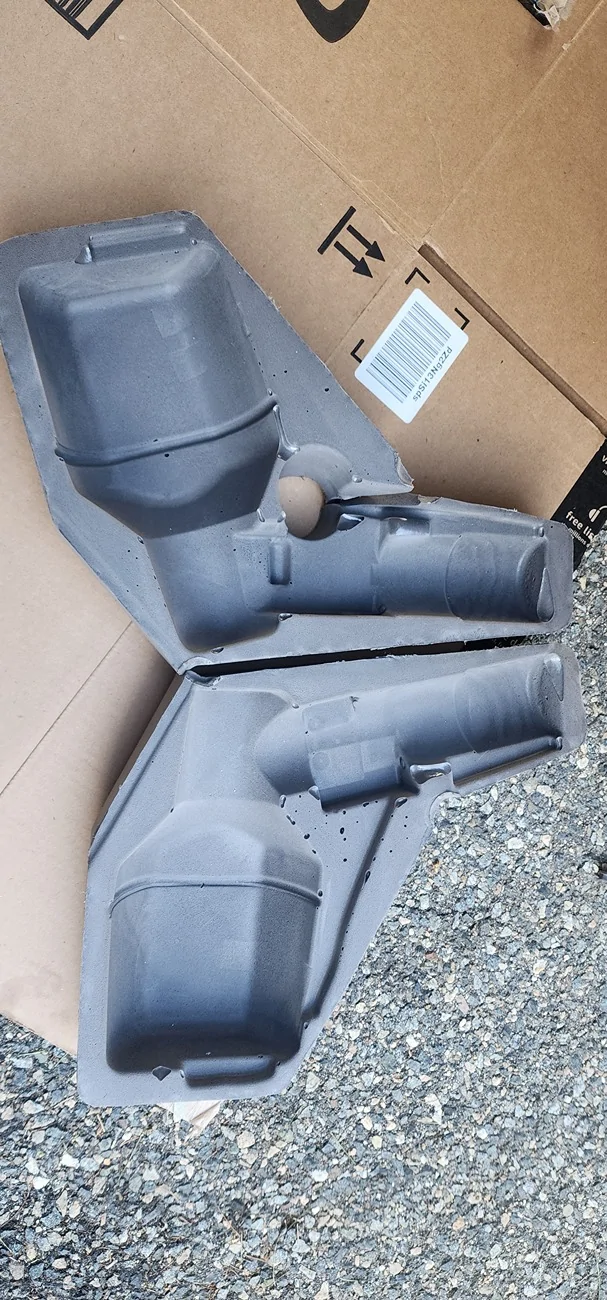

I did not disconnect the line. You'll need to get it out of the foam to see the filler plug. Foam is just friction fit into the housing.

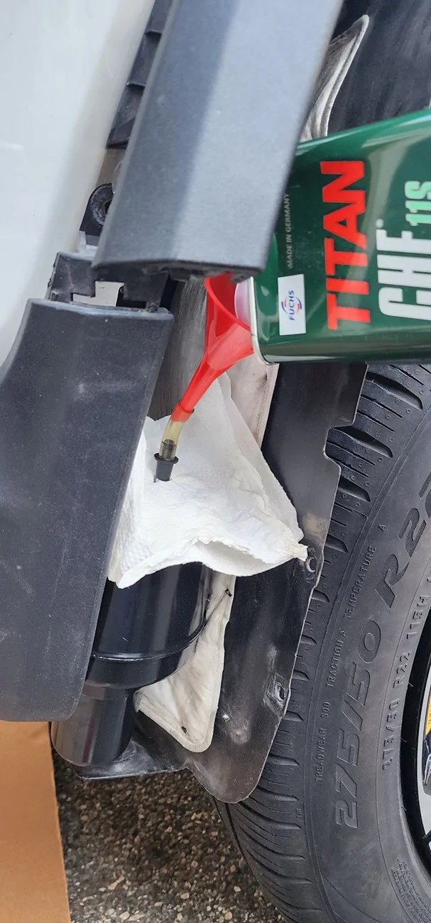

I wedged the pump between the tire and wheel well and bumper trim to get access to the fill hole.
Rivian R1T R1S Rear suspension damage 20250311_145504

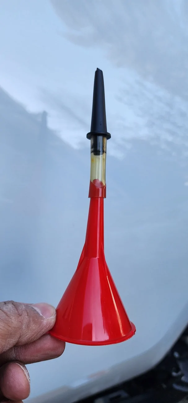

Made a filling tube with funnel and parts from a brake bleeder. Hindsight might be easier with a squeeze bottle.

I finally removed the pump and refilled it with fluid to the brim. It was a royal pain to remove it from the housing. (I needed to separate the grommet by holding the pipe on the side of the pump and pulling the grommet away from the plastic, to allow some space) so I can pull the pump from the housing without putting too much tension on the pipe. That pipe does look very fragile. I took your advice and used a squeeze bottle.

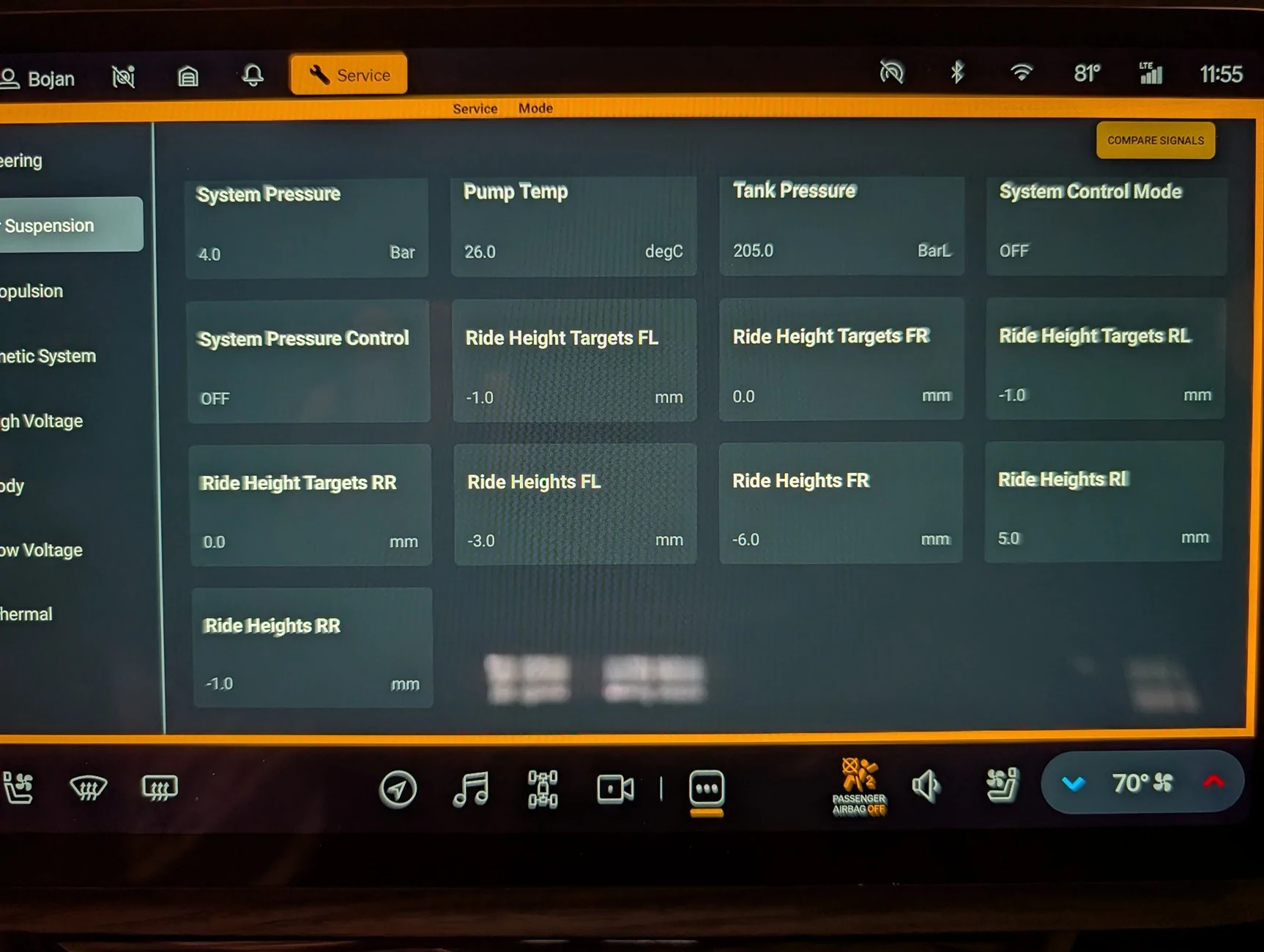

Restarting the car helped, the turtle mode is off and I can change the ride height and into off-road mode. However, the red damper warning is still on the dash. I'll try to get RiDE tomorrow and perform some resets.
