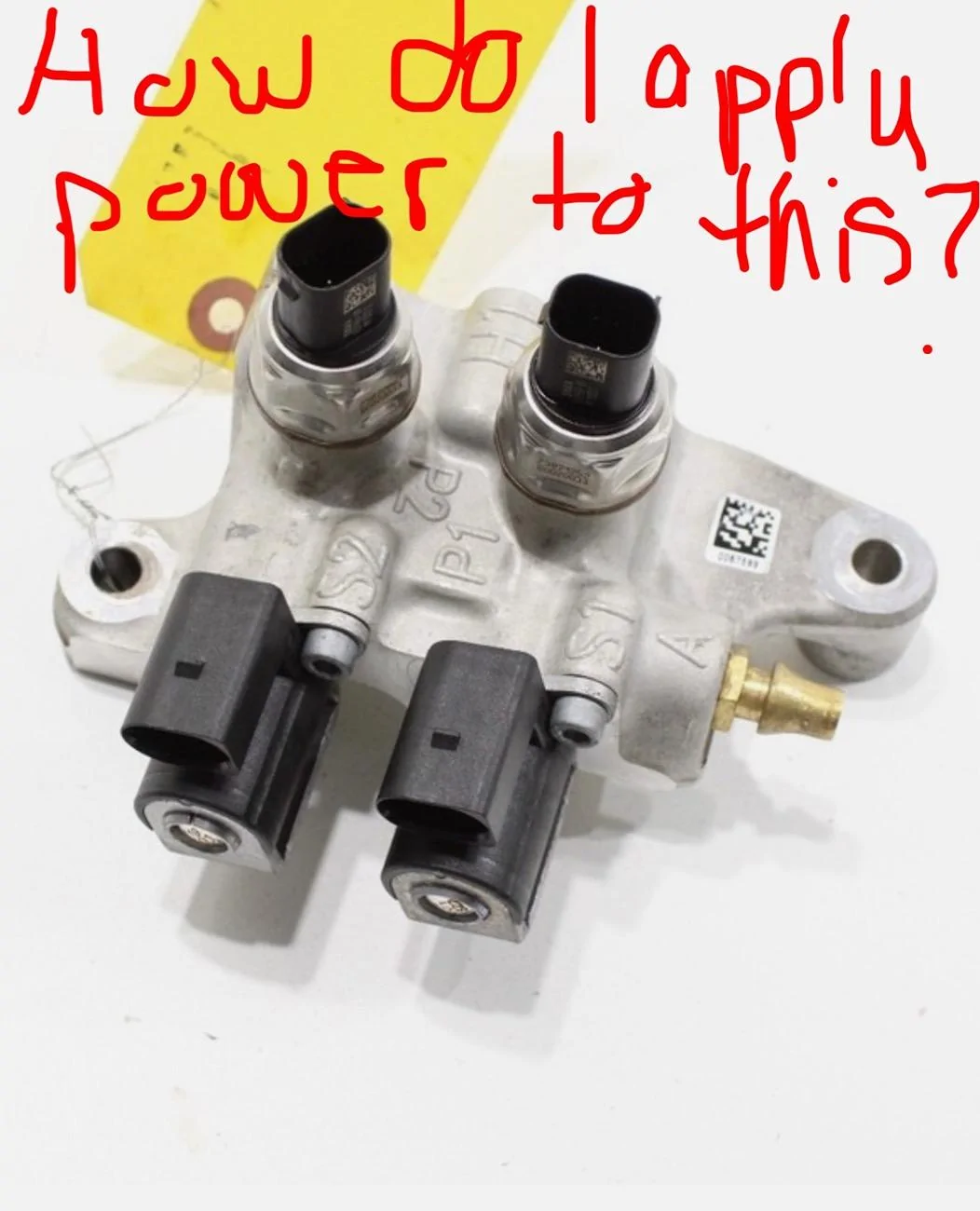

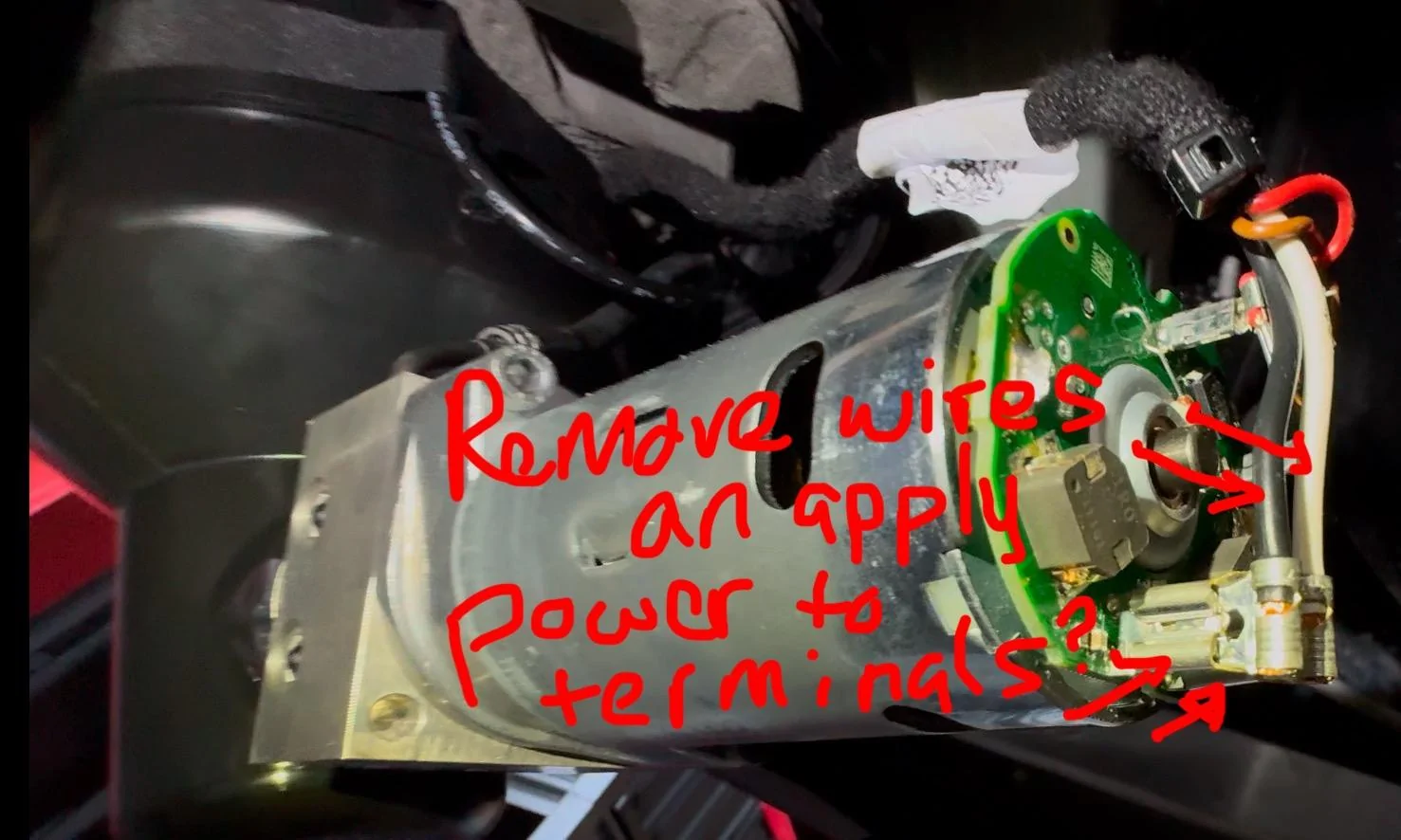

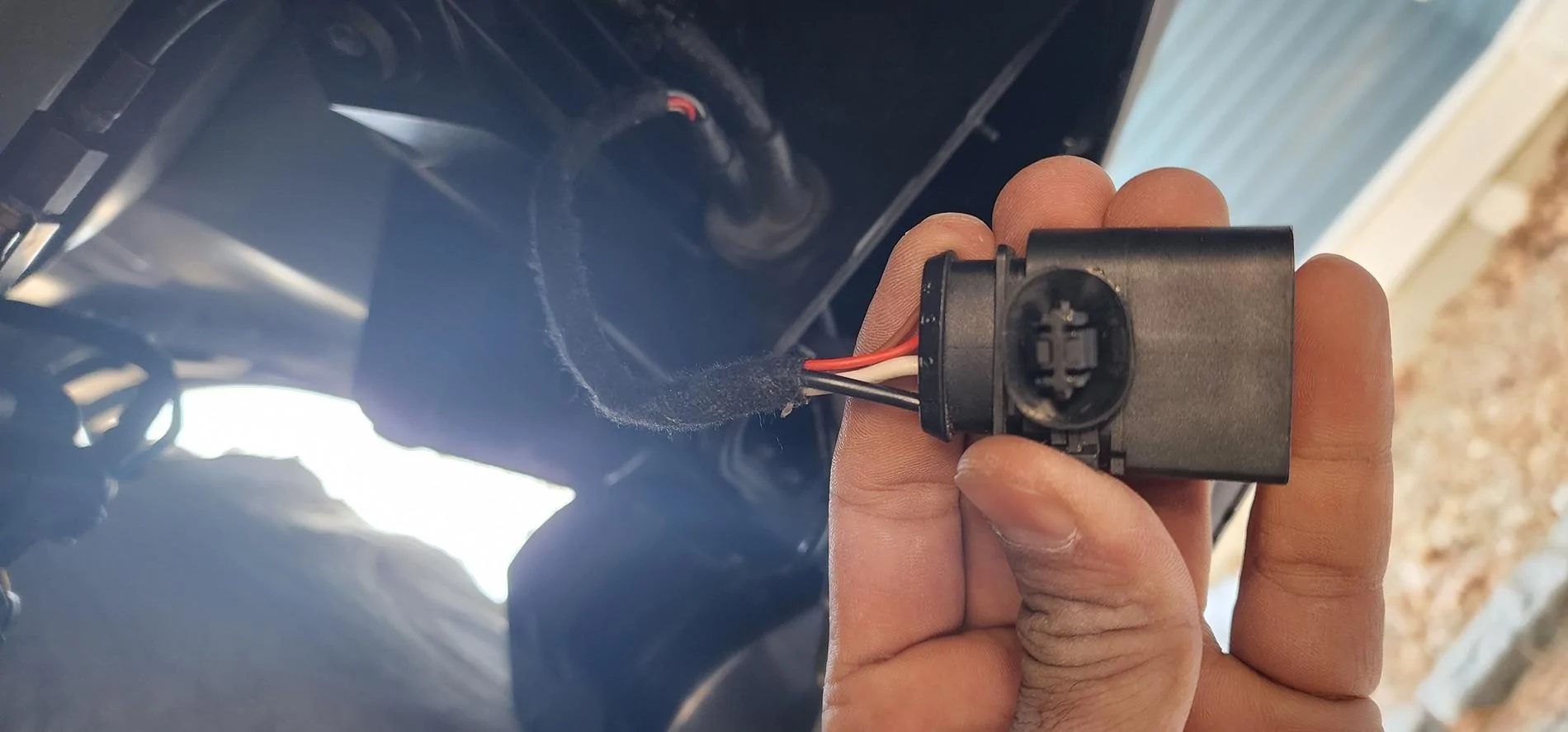

I’m a visual learner so I uploaded this picture to make sure I understand. I also need further instruction on how to supply power to the solenoid.

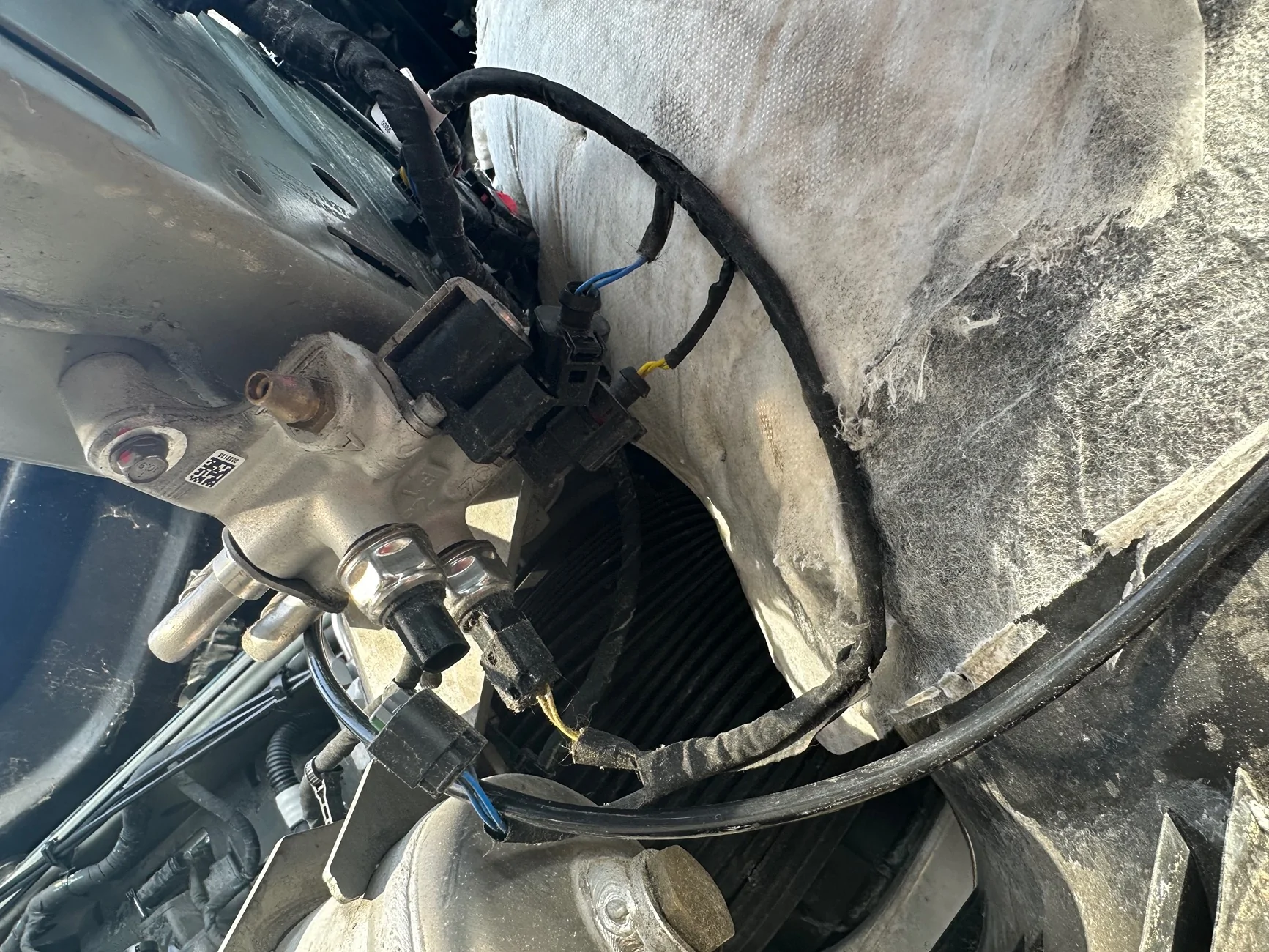

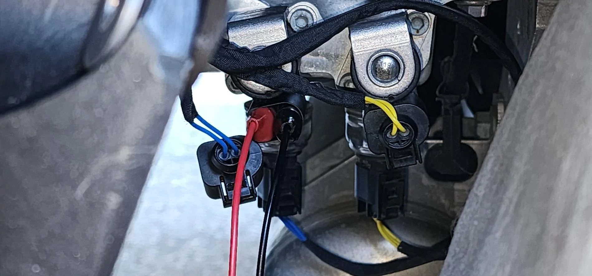

You went too far with the pump housing but yes the black and white. I just tapped at connector with gator clips and 12v battery.
Rivian R1T R1S Rear suspension damage 1000034842
Solenoids is same just gator clips to 12v.
Rivian R1T R1S Rear suspension damage 1000034863

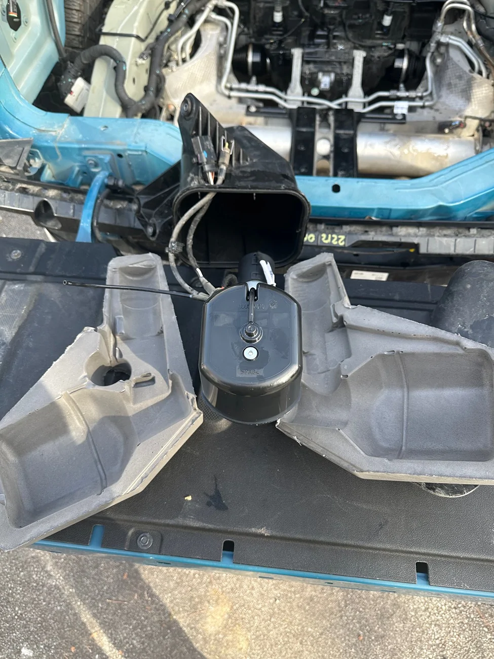

I can not tell you all how much I appreciate your posting your experiences. I am a shape tree mechanic and built a few restomods and kit cars. I have a Lift in the garage, I have a 2022 R1T Launch Edition I am trying to get back on the road after sitting in Copart yard for atleast a year. I have all the parts coming to drain and filled the suspension hydraulics and hope to have that working. I am also thinking I am going to cut a hole in the top of the Hydraulic Pump housing to allow filling the fluid if needed. Also I might go ahead and put a small check valve hole in the bottom to tell me if there are leaks in the future. I had the truck as the SC for the Inspection and it passed fine. This one only has 7k miles on it and just a shame they want to get replace a bunch of parts for no reason, They quoted me 7 grand needless to say I laughed.
Right now Im just stuck in turtle mode until I can get the hydraulic pressure right. It's one of the codes they told me is causing the Turtle Mode, Seems odd to me to cause limp mode just cause a truck is missing "sway bars". just let it drive like crap I say.....

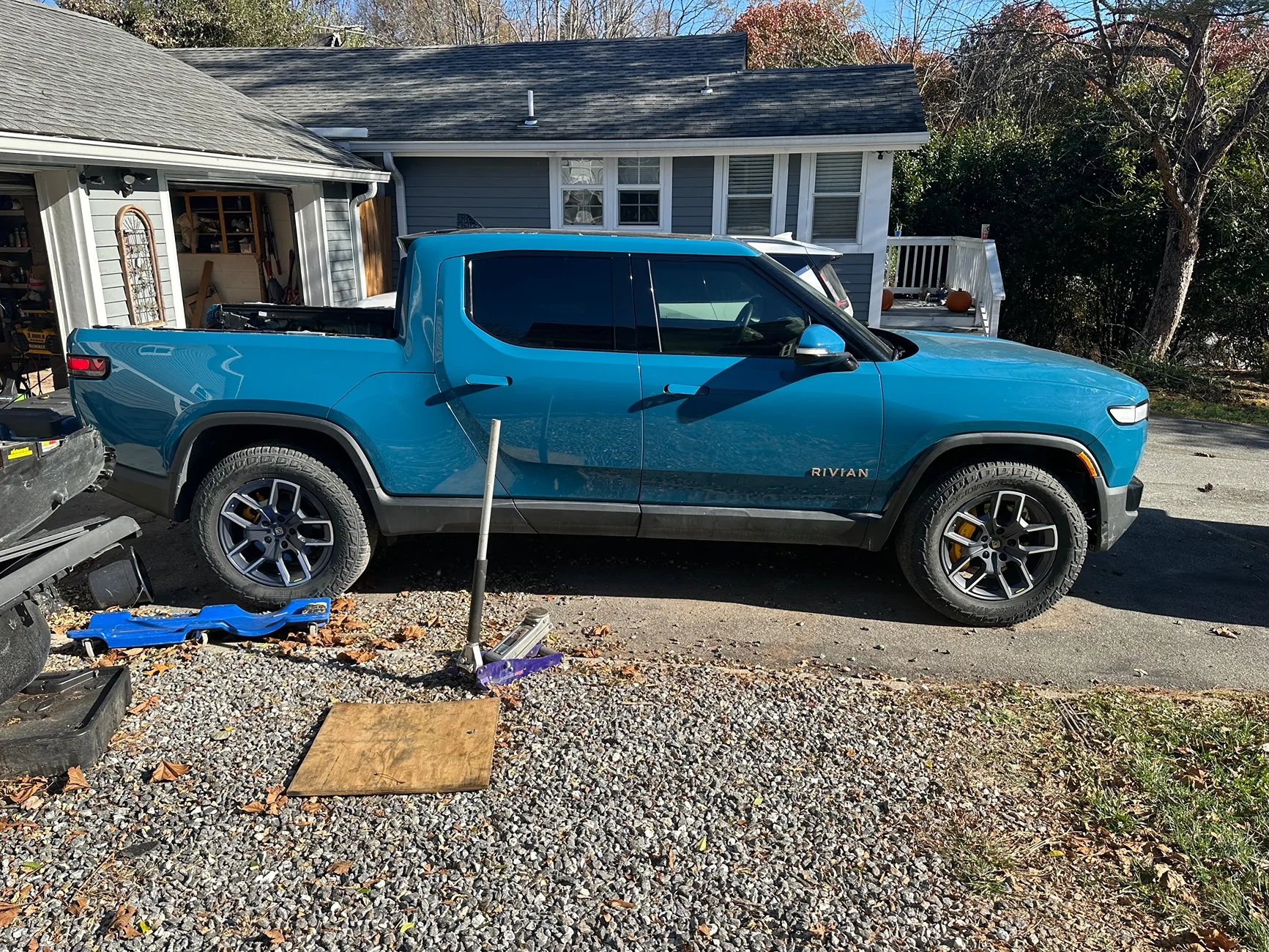

That's a neat looking R1T @viperbmw69. Did you end up rebuilding your suspension?
I bought the parts through Rivian. My car had a side impact where the Gear tunnel door, rear passenger door and the wheel were damaged. Interesting enough, I replaced the rear door and it fits just fine, it closes and opens well. There's a bent behind the gear tunnel wheel area, but I think it can be pulled back to shape.
I believe most of the suspension damage is from Copart fork-lifting the car during transport. So far I see the some dirt on the damper where the car was hit, but other dampers seem in a good shape, except the jounce lines are severed and the fluid is leaking all over.
I'm building the vacuum system with compressed chamber like in the Hollywood mechanic video to drain and refill the suspension. I think I'll have to replace the suspension on the rear left (where it took the hit), but I'd do a drain and refill first to see if it's leaking anywhere else.
I'll post my experience after I perform this.

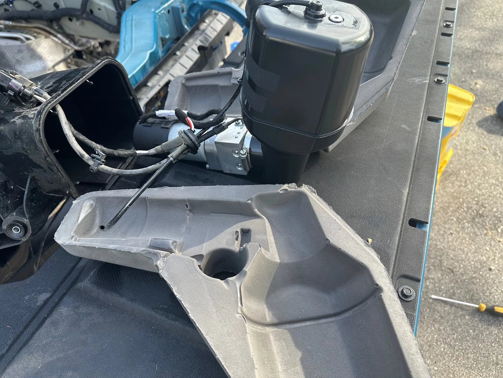

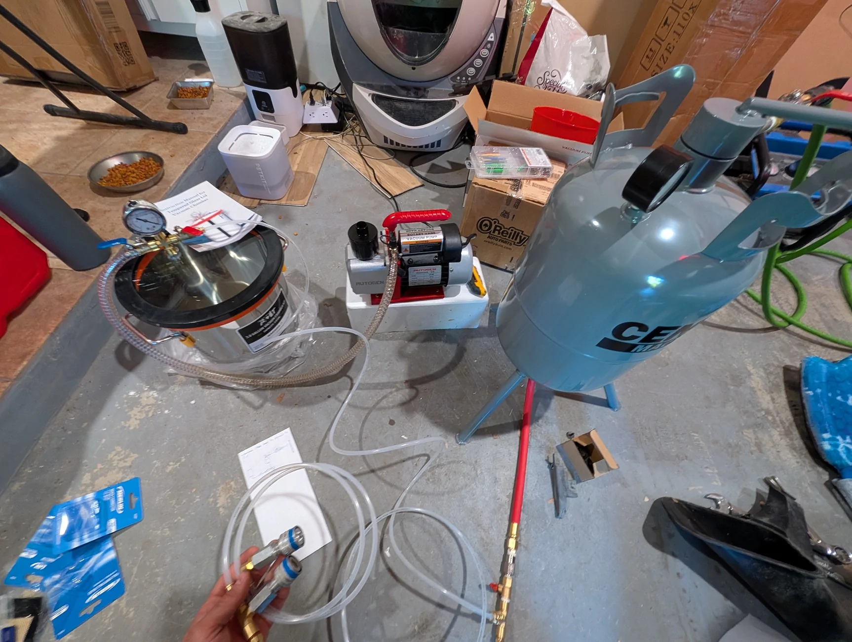

Hey DIYers, please help me out on the pump refill, before draining all the lines and doing the whole procedure.
I assembled the drain and refill machine, like @The_Skg did in this thread and from Hollywood Mechanic video, even replaced the valves with Swag lock QC4. However, when I opened the pump from the bottom, I didn't see where to go further to refill it. Do I need to access it from the truck bed or remove it from the housing for refilling?

You need to take it out from the plastic housing and foam insulation, there is a small plug on top. You'll need to loosen the wheel flare trim, liner and bumper trim and prop up the pump between the wheel liner and bumper to fill it as there is no room to do it from below.

I did it with the whole thing on the ground, the kinetic suspension doesn't affect the springs/shocks it is just fancy sway bars.
The pump housing has spring clips you'll need to pry off with a small pick or screwdriver but be sure to not break them was you'll need them to seal the whole thing again.
Yes you have to drain from all 4 corners and with air pressure to each corner to clear out all the fluid then vacuum it otherwise you will not be able to fill it properly as air will be trapped in the lines. That step is messy so make sure you have your floors covered with cardboard or something to catch the oil spray. If there is air in the lines you won't be able to pressurize correctly as air compresses. Vacuuming without draining doesn't really work well as you'll have air bubbles trapped between fluid due to the small diameter of the pipes. There really aren't many shortcuts to this procedure though I did bypass the pressure tank rig and used a 100psi water pump instead.
You didn't need to change the valves as you could have just purchased OE compatible fittings instead. 1/4" NPT ISO 7241-B. Once you refill properly any opening of the lines means you have to redo the whole thing.
Just keep in mind here any shortcuts will mean you get to do the whole thing again, it is a tedious and messy job so take your time and do it right the first time. Before you fill the fluid make sure the system can hold a vacuum for a few hours to ensure there are no loose fittings and make sure to purge the air in the supply lines before opening the valves
