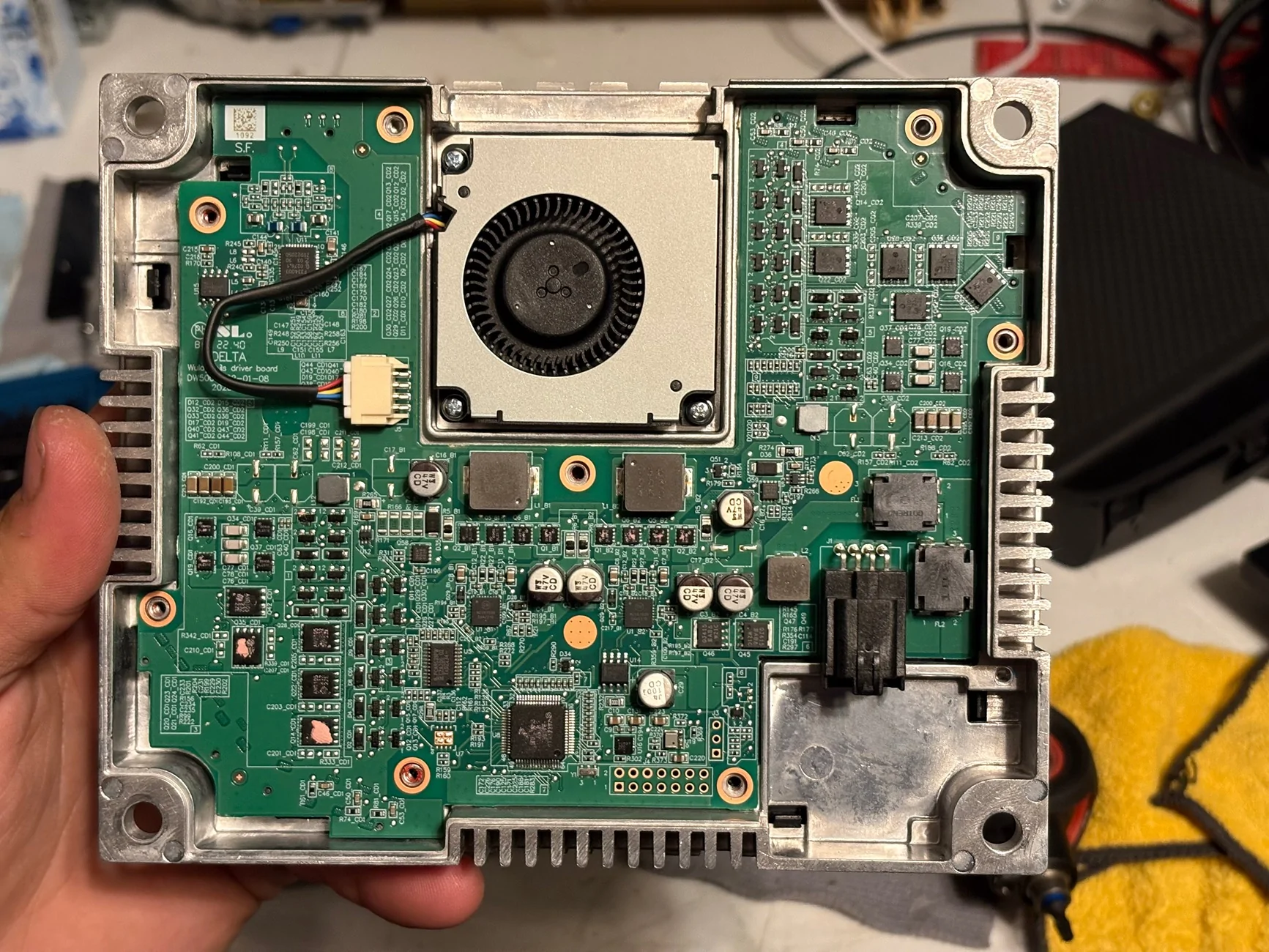

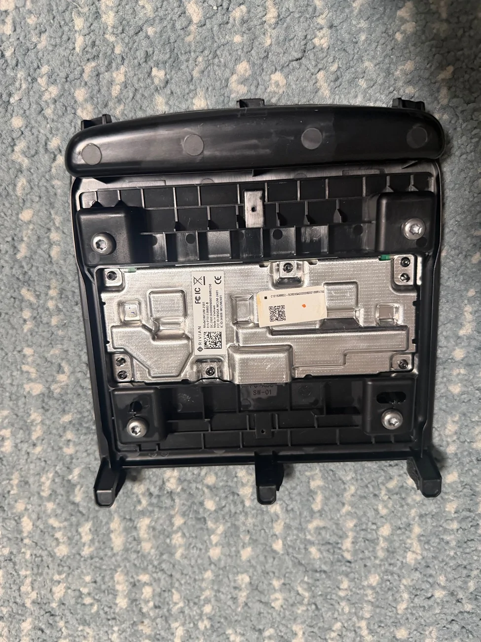

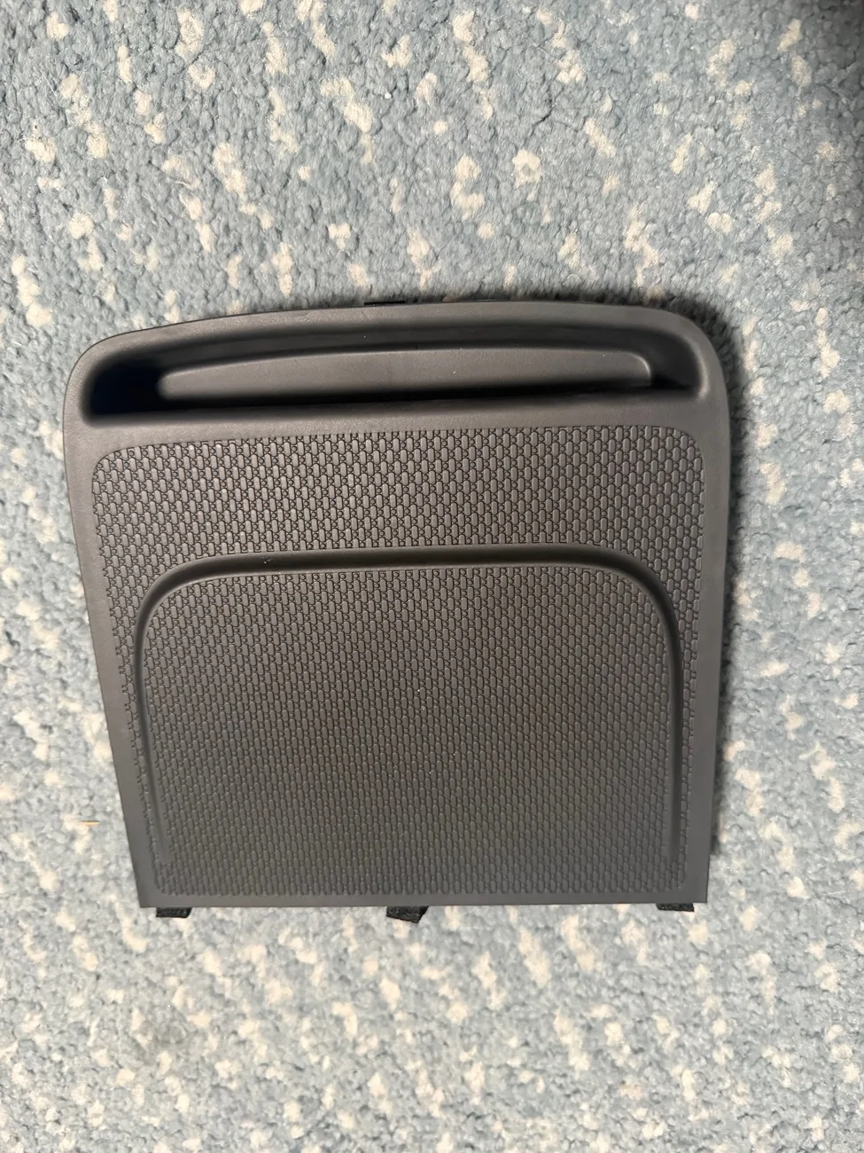

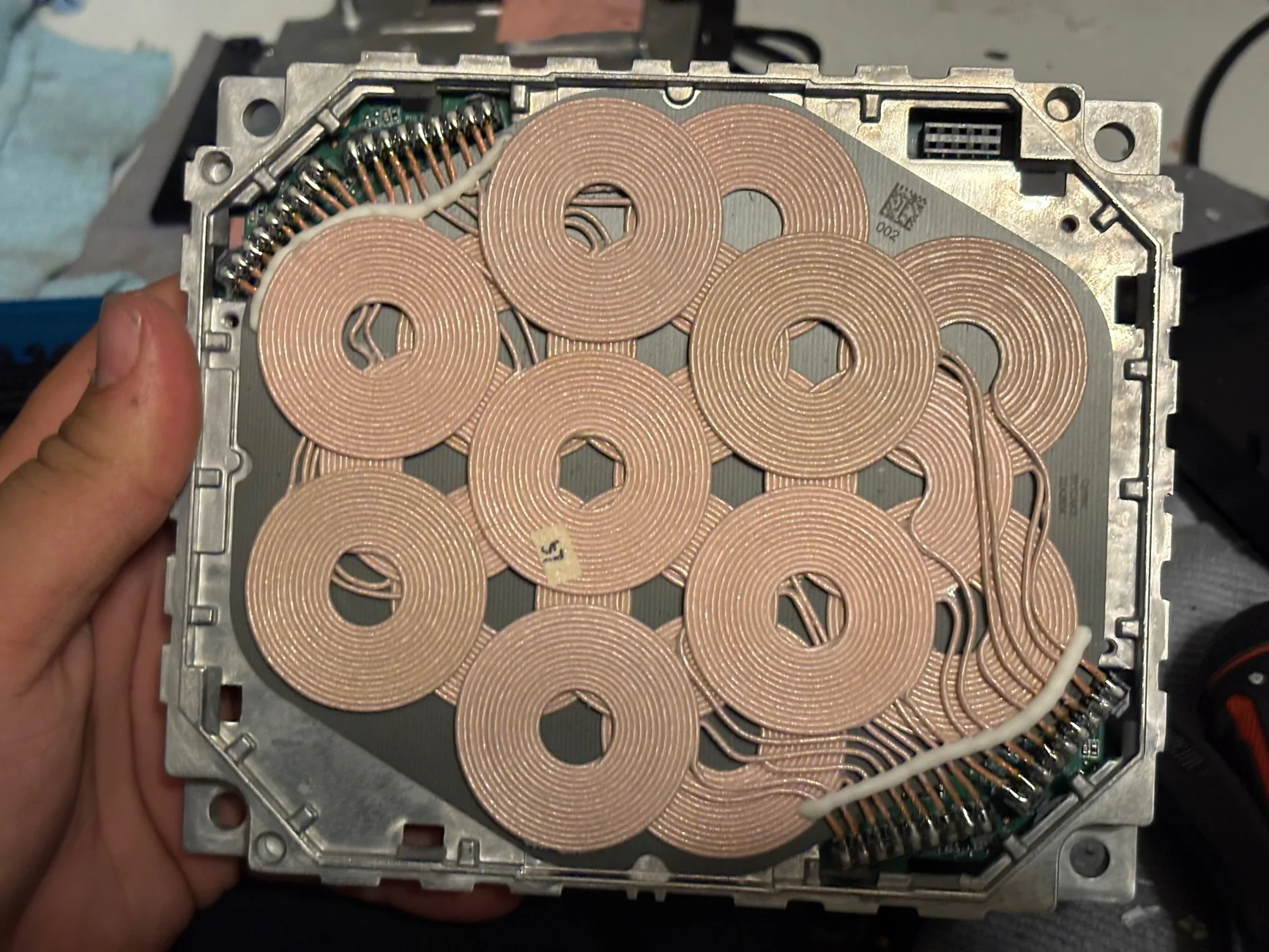

I attached some pics of the old charger. I think others have shared this design before.. It’s a unit! I’m not sure who ever thought this would work well, but it’s a crazy contraption. It had to be incredibly expensive. For some reason I didn’t think to take pictures of the inside of the new one even though I took it apart. It is much smaller and simpler.

My god, how are these pads NOT a fire hazard.. ?
Because it isn’t high powered? If any criticism, it’s inefficient; the amount of resistance and copper used in a device that is ineffective in charging phones. A design that works in theory, if theory doesn’t include real world variables.

I attached some pics of the old charger. I think others have shared this design before.. It’s a unit! I’m not sure who ever thought this would work well, but it’s a crazy contraption. It had to be incredibly expensive. For some reason I didn’t think to take pictures of the new one even though I took it apart. It is much smaller and simpler.
