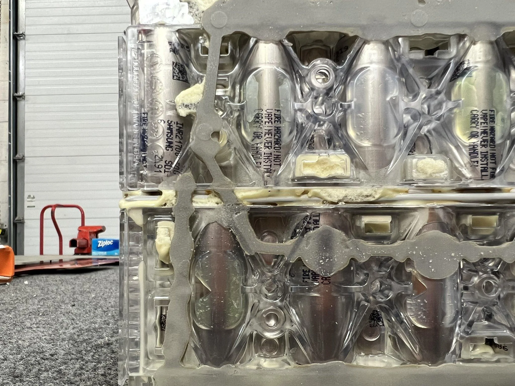

Looks like they are using the Samsung INR21700-50G Lithium-ion cell.
INR21700-50G
Minimum capacity: 4850mAh
Nominal voltage: 3.6V
Standard charge current: 1.6A (0.33C)
Charge cut-off current: 121mA (0.025C)
Max. charge current: 4.85A (1C)
Charge end voltage: 4.2V
Max. discharge current: 9.7A (2C)
Discharge cut-off voltage: 2.5V
Max pulse discharge: 14.55A (3C)
AC impedance at 1kHz: 14±5mΩ
Max weight: 69.5g
The math works correctly out for that cell:
4.85Ah X 3.6V = 17.46Wh
7,776 cells X 17.46Wh = 135.8kWh pack capacity
Here's test results of that particular cell compared to two other Samsung cells:
https://www.thunderheartreviews.com/2021/12/samsung-21700-50G-48G-50E-test-comparison.html
If you want to skip to the results... the cell Rivian uses is excellent!
