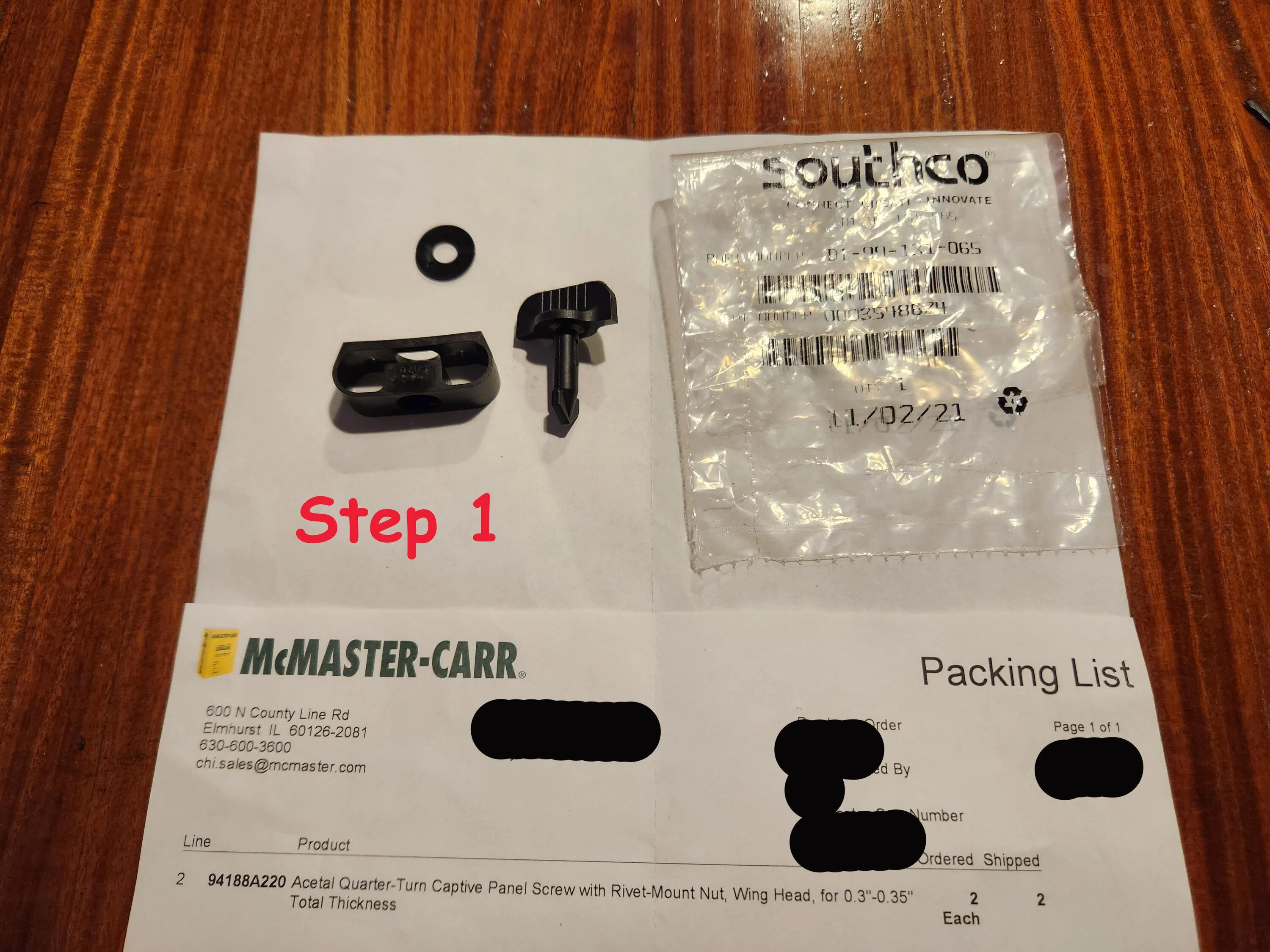

Step 1. Go to McMaster-Carr and buy TWO of these. Not two of each...but two of either/or. The preferred part is 94188A210, it is the exact same length as the fastener you are replacing. 94188A220 is slightly longer and requires you to use a washer (see step 3). I listed both because availability could vary and both work perfectly.

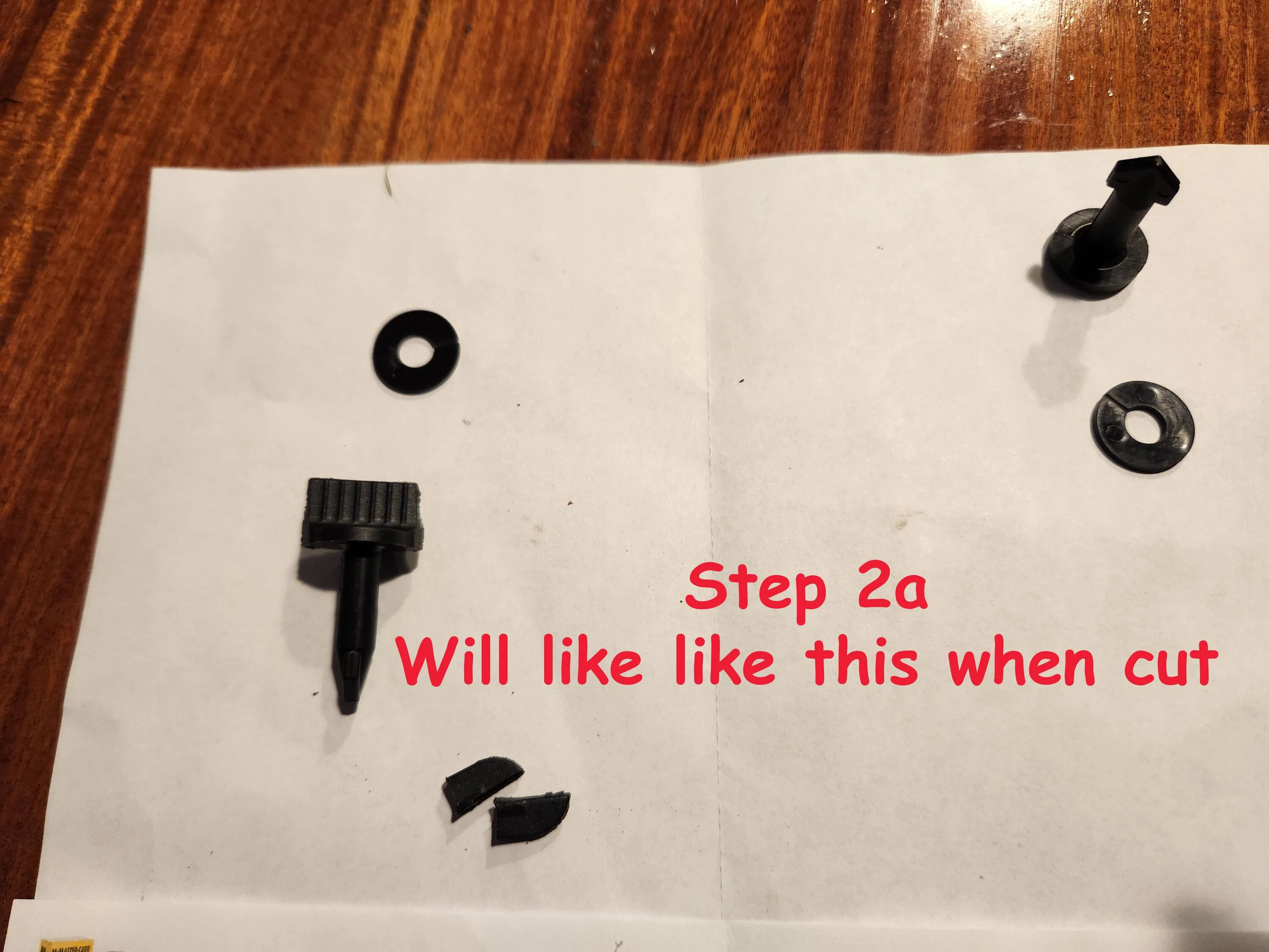

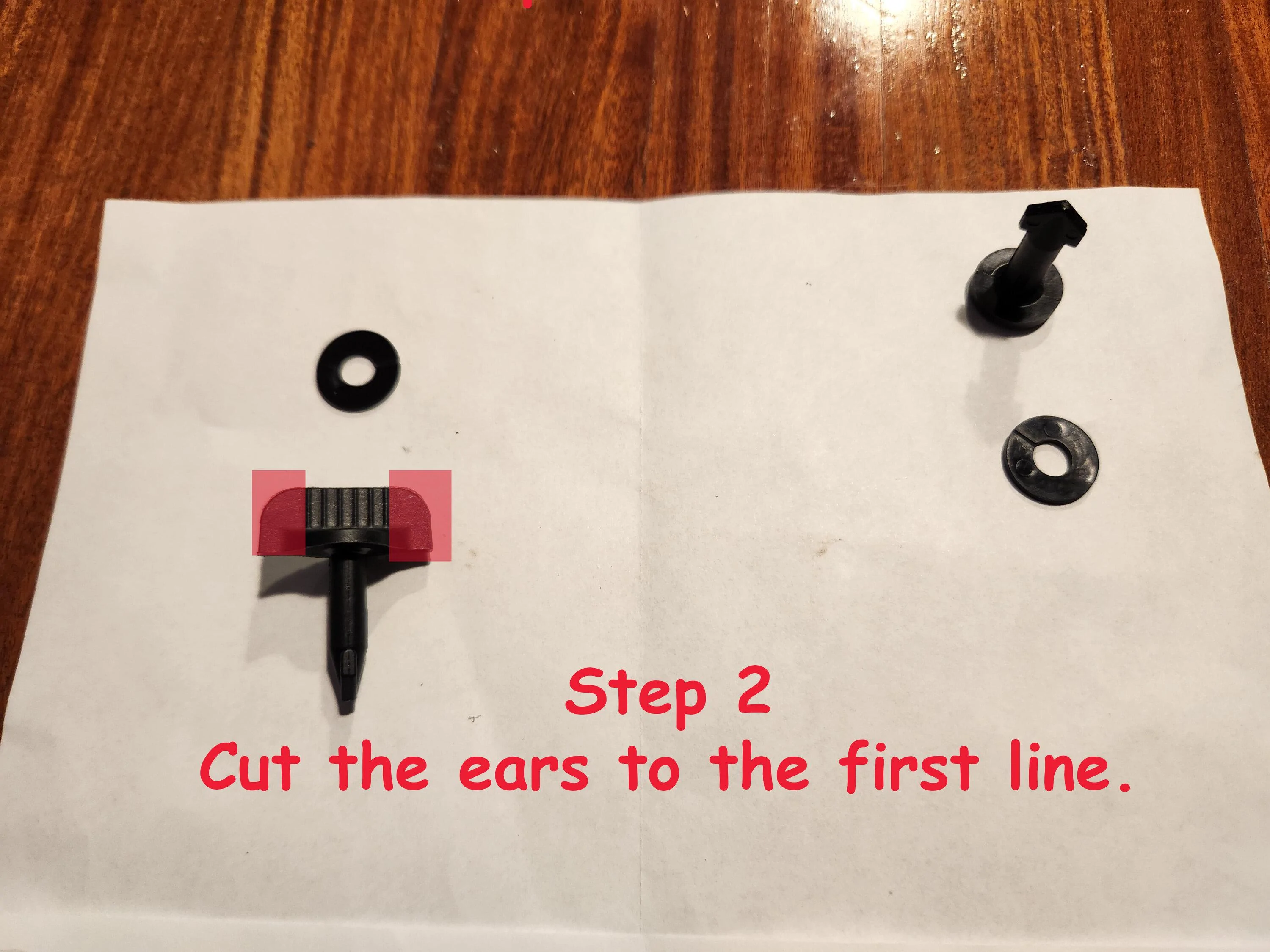

Step 2. Discard the female part of the new fastener. All you need is the retainer clip and the male part. Cut the ears off the new fastener to the first line as indicated in the pics.

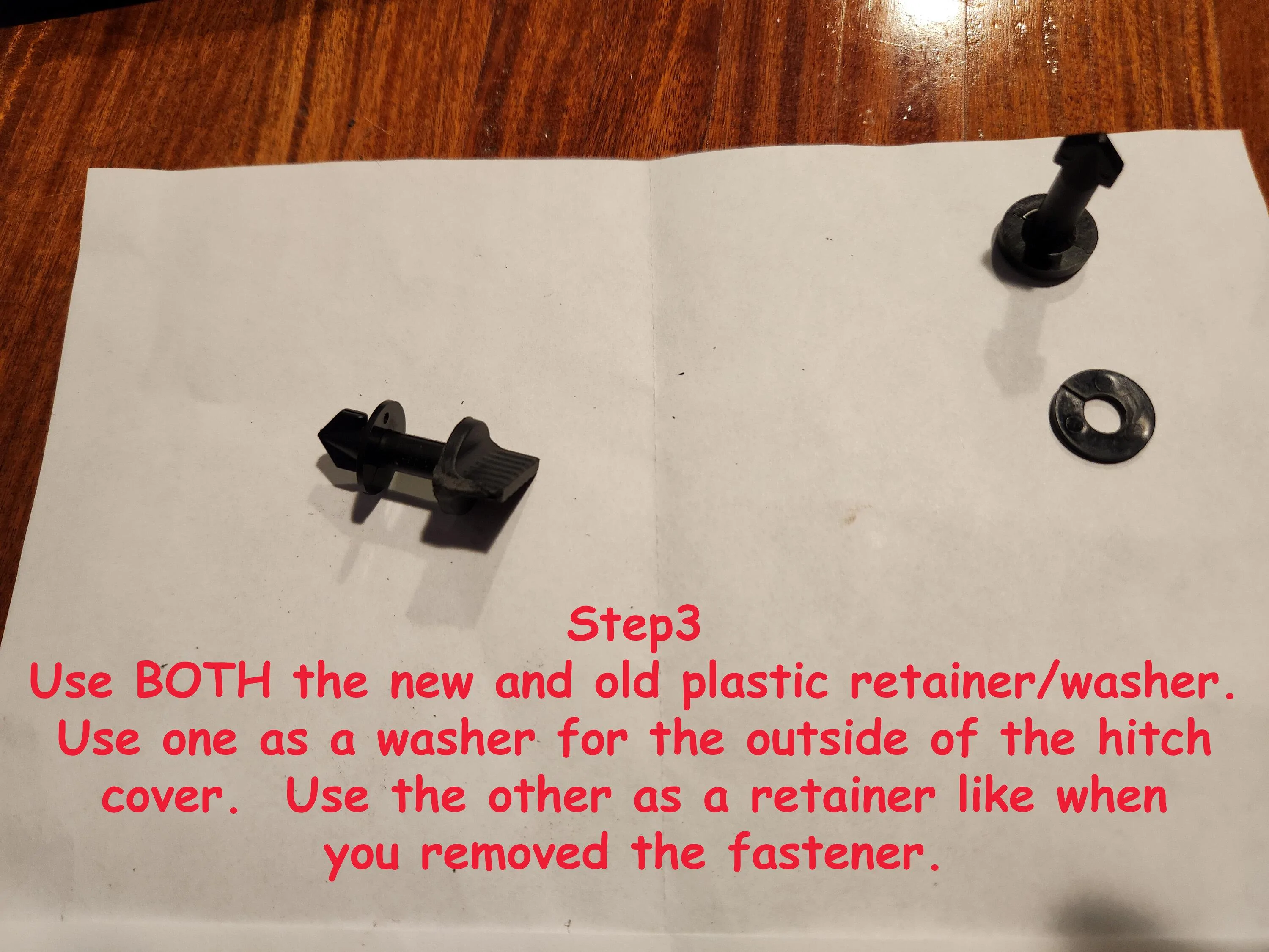

IF YOU BOUGHT PART # 94188A220. Use BOTH the old plastic retainer/washer and the new one. One as a washer, and the other as retainer. The reason you need the old washer in addition to the new washer is that the shaft of the new fastener is very slightly longer than the old one. Without the additional washer on the outside to reduce the effective length, it won't hold as well.

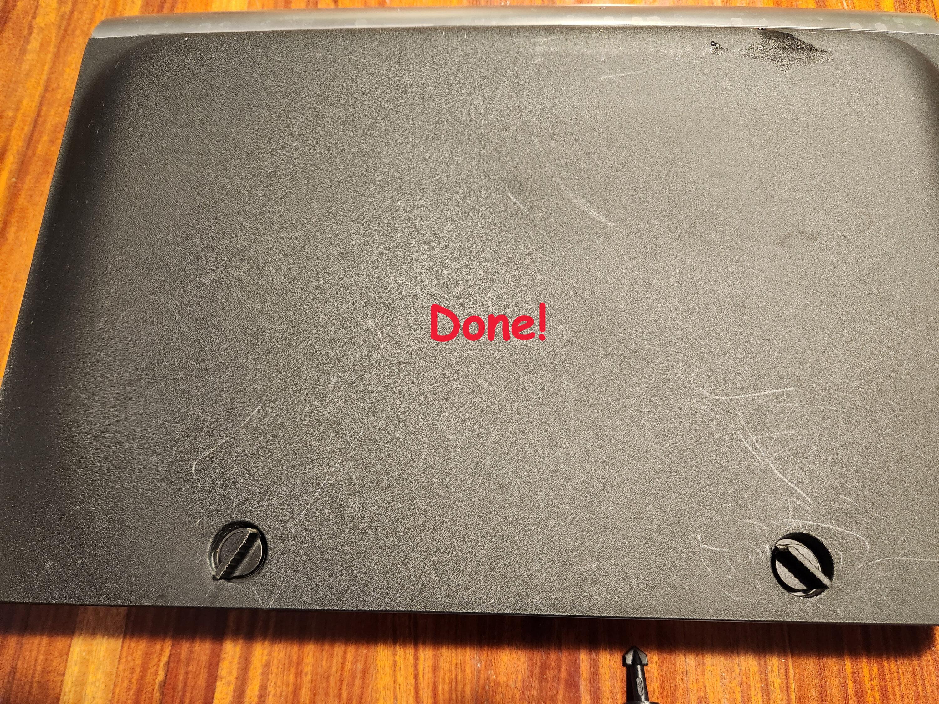

Step 4. Done. Now you have a thumb(able) quarter turn fastener and you can ditch the screw driver.

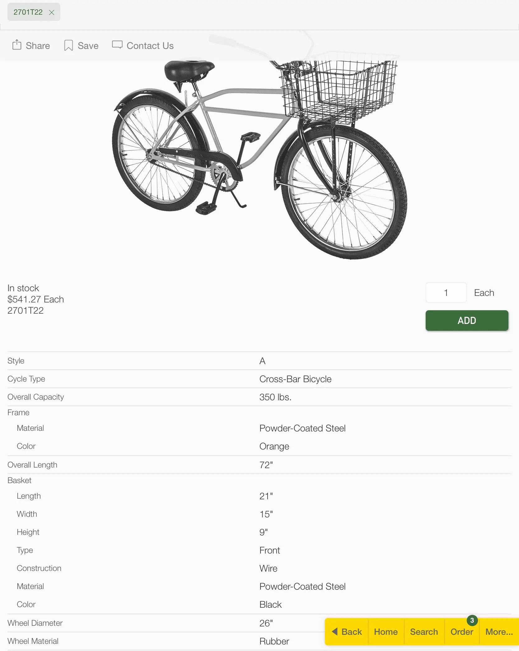

If McMaster-Carr doesn't have it, you don't really need it. ?
even bicycles!
Rivian R1T R1S Hitch cover DIY mod.  Ditch the screwdriver! 1663766275727
I did a job once where the customer engineer spec’d McMaster Carr PNs for everything. even a piece of schedule pipe. Threaded rod. The sheet metal. All of it McMaster.
I think I did end up getting the pipe from them, as it was a funny wall thickness and stainless, and only needed a foot of it.

even bicycles!
I don't think I've ever not found what I was looking for in the inventory, and there is a warehouse about 50 miles from us, so we order by 3 PM and have it at 9 AM the next day.
A few weeks ago I needed a 6mm pneumatic speed control valve for our bottle filler. That's a pretty obscure, low demand product and size. They had several different designs, all in stock.
