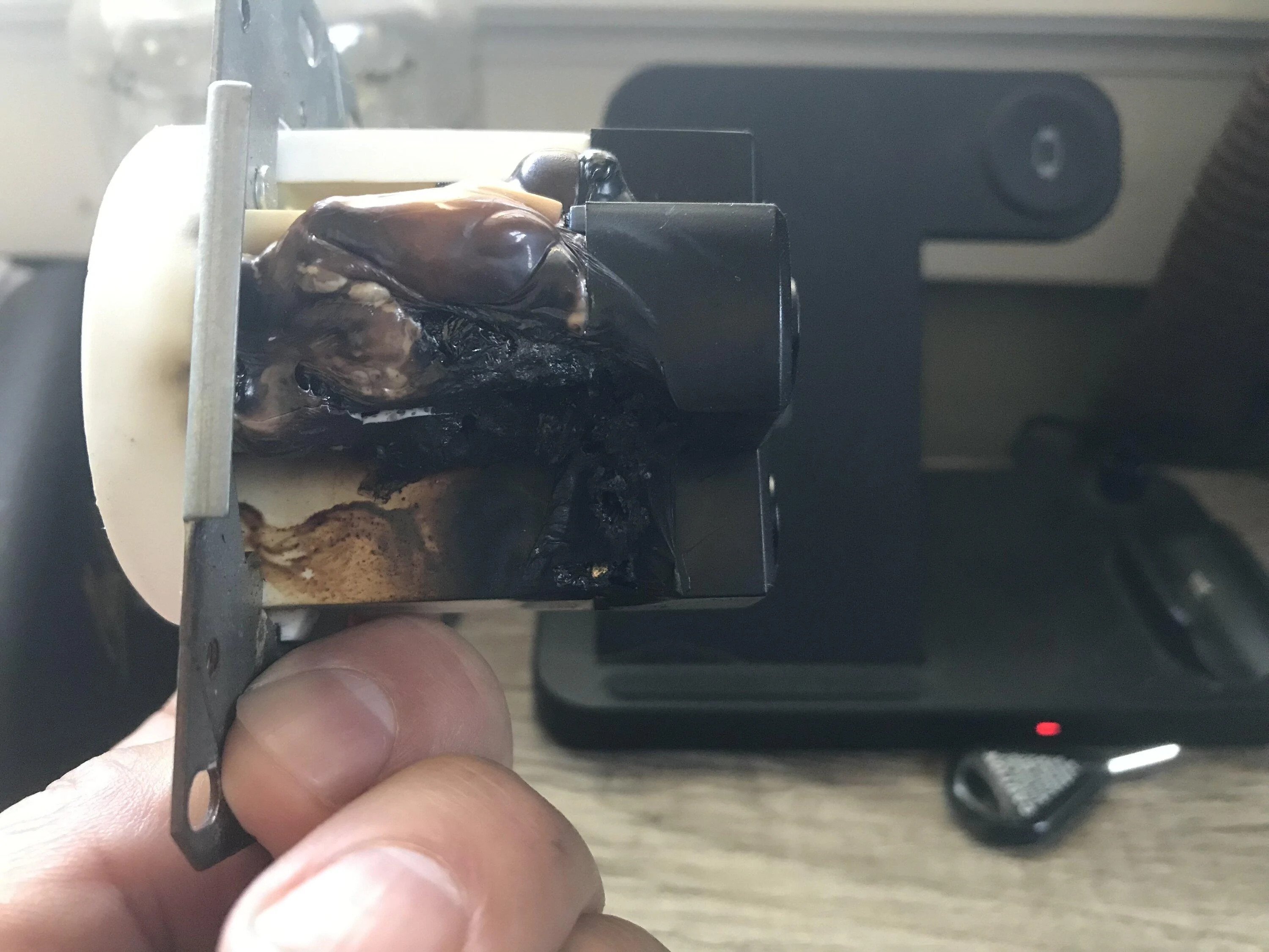

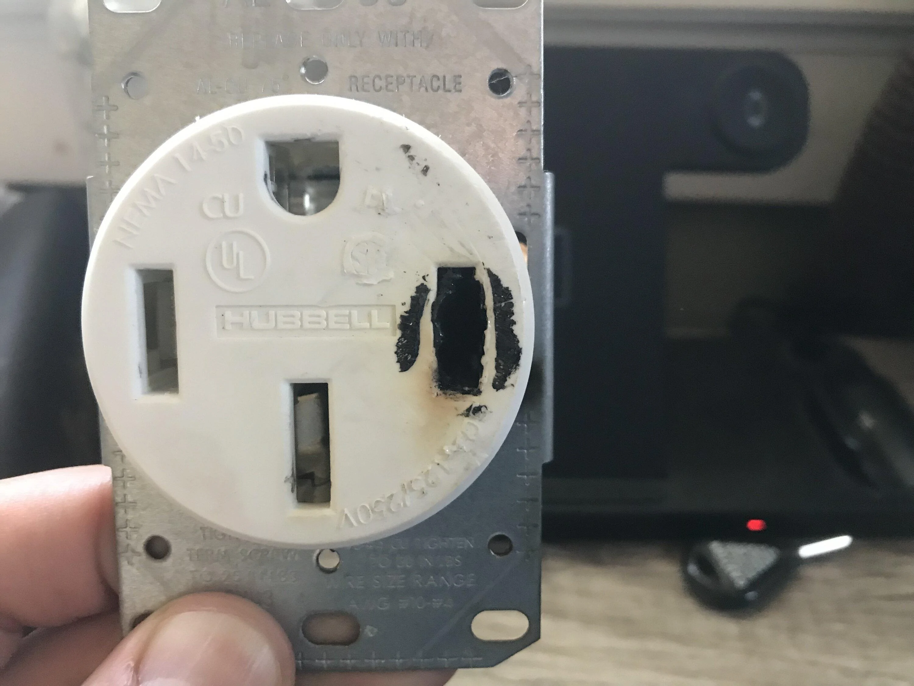

This is VERY IMPORTANT.
3 years ago, I had 2 240 drops in the garage off their own panel from a local and reputable electrician. They were plug-in 14-50s vs. hardwired so I could be flexible with the chargers we bought (since we figured they would improve dramatically over time).
Abut 15 months later, I smelled burning plastic while the i3 was charging.
Here is the result.
Rivian R1T R1S EV Charger Risks: Home Charging Installation Risks and Advice - by Munro Live B41D9D6F-884A-43CC-804F-58171C7D52F7
Rivian R1T R1S EV Charger Risks: Home Charging Installation Risks and Advice - by Munro Live 52C8E8A8-E1DC-4880-9A3E-6A12C31E0600

My recommendation, regardless of who's doing the install, is to hardware your EVSE. If that's not an option, or you may want flexibility of swapping out to a nicer EVSE in the future, go with a 14-50 plug.
Always use an INDUSTRIAL (not commercial, but INDUSTRIAL) 14-50 outlet from Hubbell, Bryant or Cooper. Go with a 60A circuit as well for future supportability.

I experienced the exact same thing with my NEMA 14-50 outlet last year. Lucky I didn't burn the house down. Now have the charger hardwired.

You’re absolutely right - unfortunately, there’s not enough awareness of this yet and I’m willing to bet the vast majority of 14-50 installs are for lower duty-cycle application plugs like the Hubbell in the picture I posted.
I can say with certainty that my electrician had no idea.
Yep! Only the electricians who've worked in actual industrial commercial applications understand the difference. Local sparkies that do residential stuff aren't up to speed.

That looks like a bad lug on the receptacle or prong or bad clamping on the prong.
Anyway, I am old school and don't ever like aluminum conductors, for one, and secondly using a high-quality breaker panel like square d or siemens.
A quality breaker will trip before you get a bad issue.
Just like car tires, or bearings, if during normal operation you are getting excess heat when you touch the cable or receptacle, there is a problem. Don't want to touch, you can get a thermal gun for $25.
I think a really good investment if you are parking an EV inside a garage. You could also do spot checks under the vehicle to see if any of the areas of the batter are warm when they should not be.

How often was the plug removed from the receptacle?

So the receptacle issues I am familiar with, what was the deal with the breaker? Poor quality or something else?
