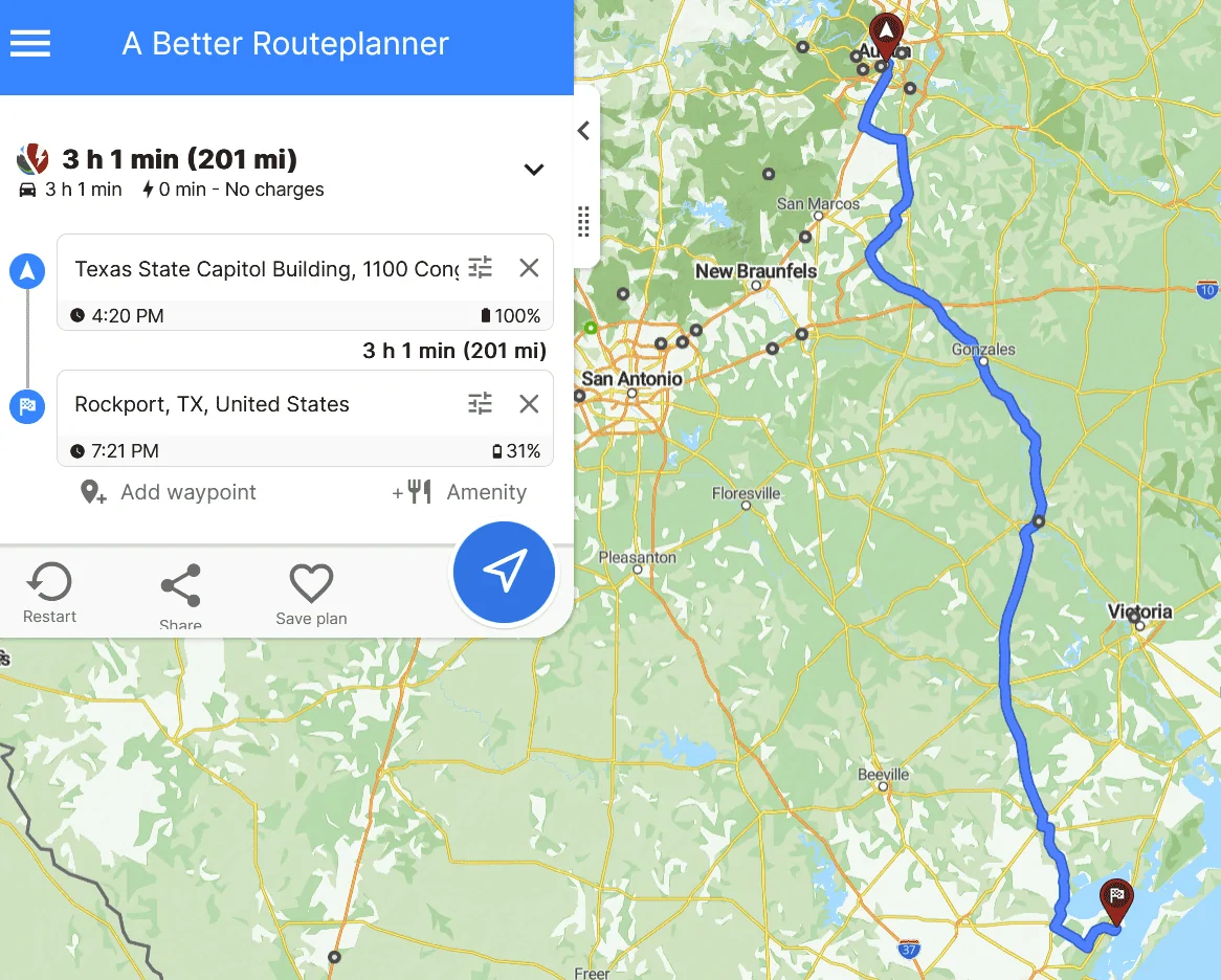

Try to use ABRP to drive from Austin, TX to Lost Maple State Park and then compare it to google maps. ABRP adds 20+ miles w/o ANY reason. Also, the expected drive time is 30% off in ABRP.
That's interesting, it looks like ABRP is favoring highways more than local roads. If you toss Blanco in as a stop, it gets it "right" per Google. The irony here is my FIL won't use Google because it doesn't route him "correctly" on the back roads in MN and wastes time.
The expected drive time in ABRP is very dependent on your inputs. I'd argue that Google is very off on long distance drives for me because of what they assume for the speed people are driving when long distance.
Or try to plan a route from Austin to Rockport, TX. 211 miles only, but it insists you can not make it even when you specify 2.9 miles per kW for 65mph and set arrival SoC to 10%. But what's worse ABRP insists you charge at a nonworking charger (for more than a few months).
You should try again, it worked fine for me and said I'd get there with 31% SOC with the ABRP settings I use for my truck.

I am glad you have a good experience. Try to use ABRP to drive from Austin, TX to Lost Maple State Park and then compare it to google maps. ABRP adds 20+ miles w/o ANY reason. Also, the expected drive time is 30% off in ABRP.
So I am glad it is working for you, but for me, it is really not.
Yes! I had a similar experience routing from Buda to Corpus and back the day after the update that integrated ABRP routing. Before the update it routed me correctly using the shortest route (down 123), only 181 miles and starting at 100% so no need at all for charging stops. The new Rivian nav with ABRP kept insisting on routing me way out of the way (30+ additional miles) for charging stops, no matter what settings I tried, and would not give me any option for the most direct route or completely removing charging stops. I ended up having to find a spot about halfway in between to navigate to on the way down and the way back. Going there I arrived with 28%, on the way back I got home with 33%, driving a bit over the speed the whole way.

Well, the good example why is when I want to drive from Austin to Rockport and back. I think it is a very valid scenario. ABRP would route me to unworking charger despite it marked unavailable for 2 months by EV connect and plug share.
