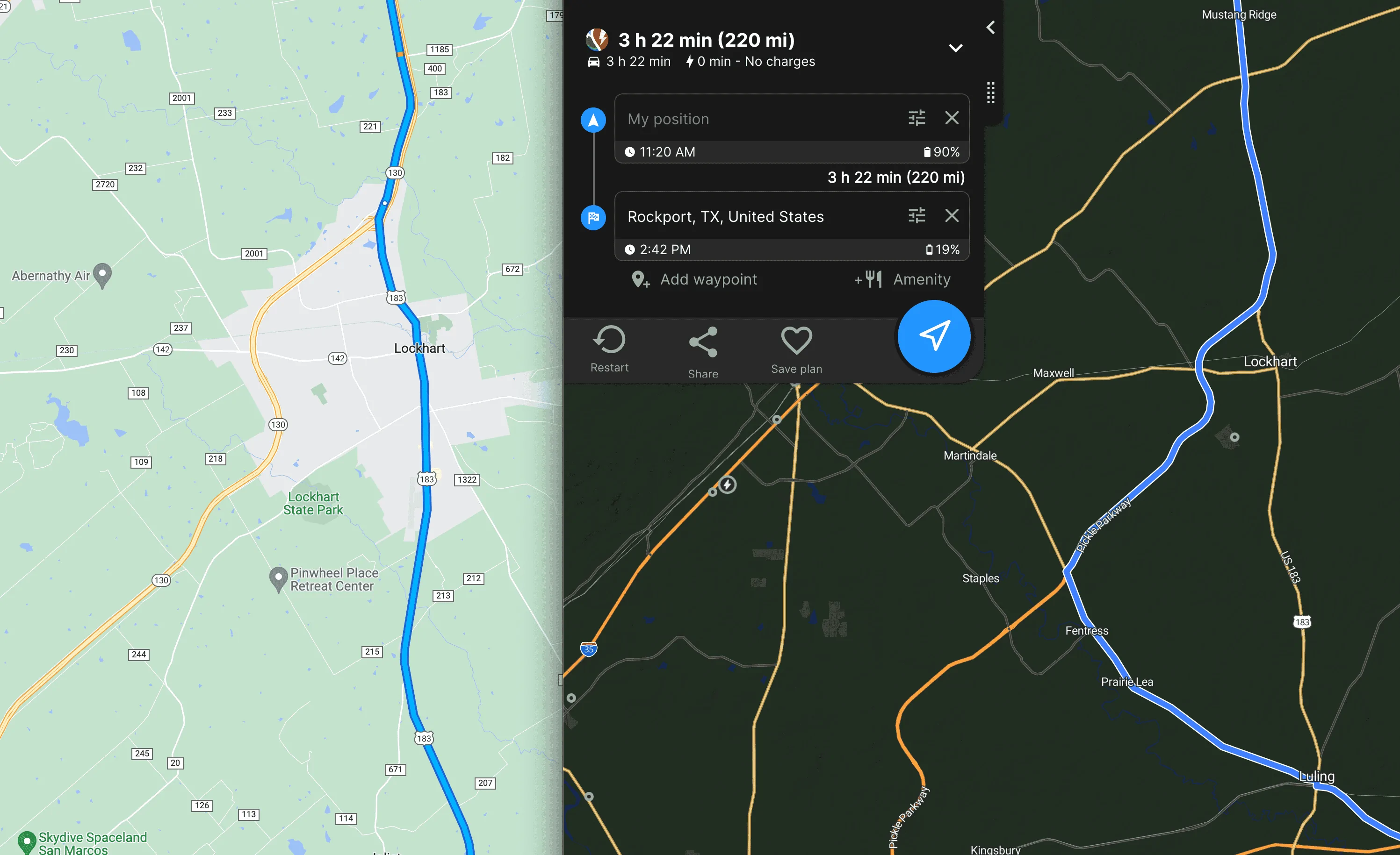

As far as the range prediction from Austin -> Rockport, when the Rivian deal was announced, we updated the R1T/S models quite a lot, so maybe you're still using the old alpha model? It might be worth re-selecting your car model from the list to make sure you're using the new model.

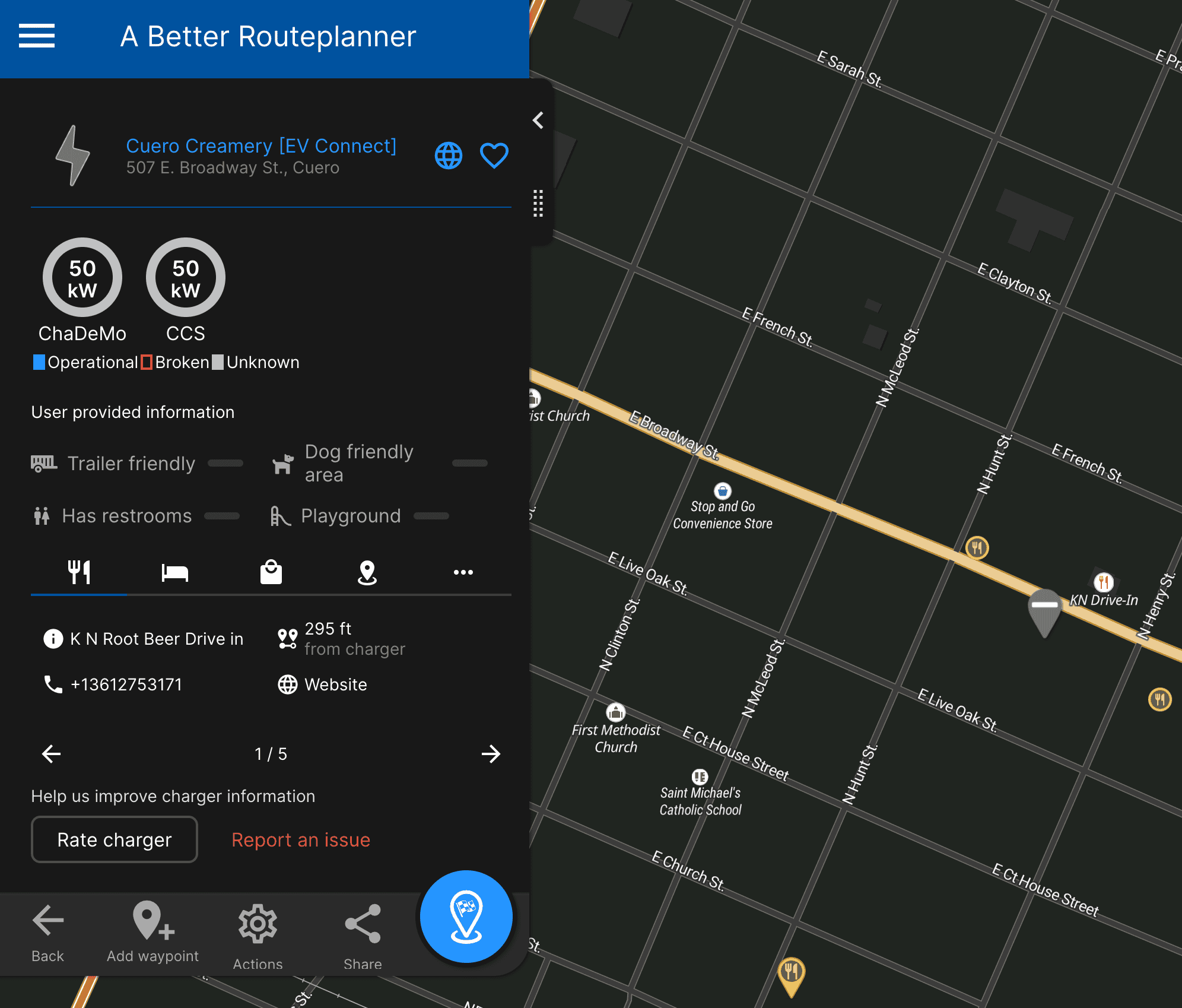

Can you point me to the non-working charger? I'll check what data source we're using for that and see if there's something we can do about it.

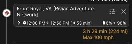

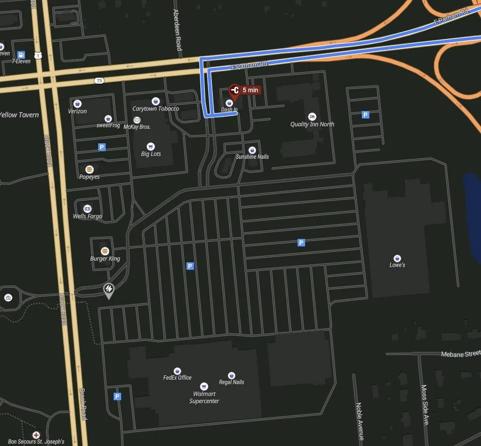

1.1 Also, if you look for a route that ABRP calculates, you will see that it uses inefficient detour :
with or without tolls (compared to gmaps (no tolls) that adds additional 11 miles w/o any benefit

2. Nonworking charger:
Rivian R1T R1S ABRP 4.5.0. gets a major upgrade 1691683628555

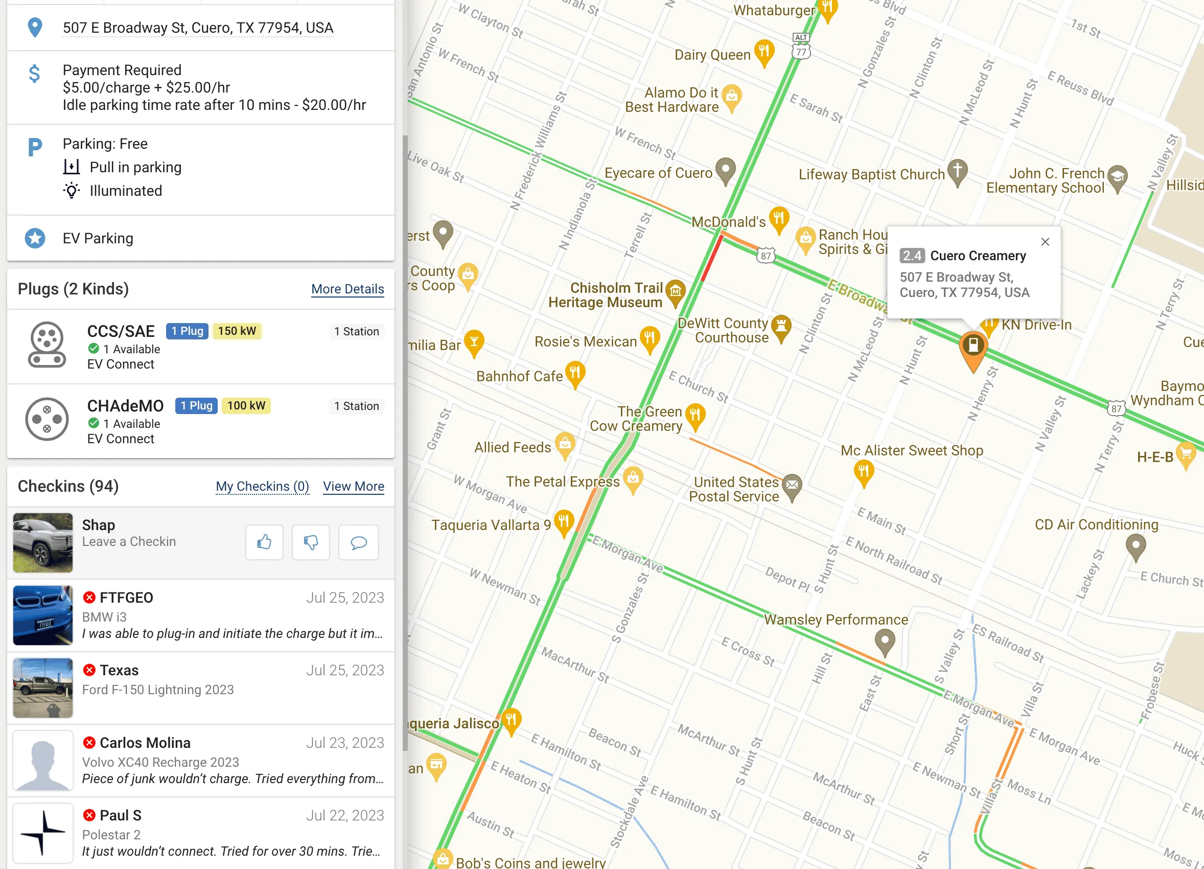

BTW, here is from plug share on this charger: (BTW, yesterday EV Connect change their status to available - they were marked as unavailable till yesterday).
Rivian R1T R1S ABRP 4.5.0. gets a major upgrade 1691684819490
