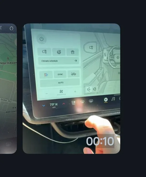

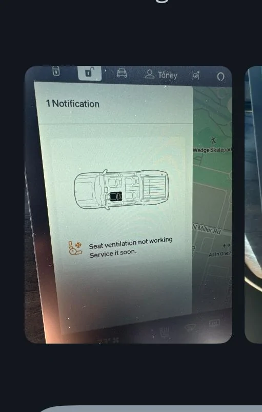

Mine started off working intermittently. It would either be fine, or not work at all for the entire drive. They maybe reset itself for the next drive. No pattern in operation.
Yesterday it finally crapped the bed. Error message. I captured diagnostics and made an appointment. First available was Sep 23rd, just in time for the end of summer here in Arizona.
