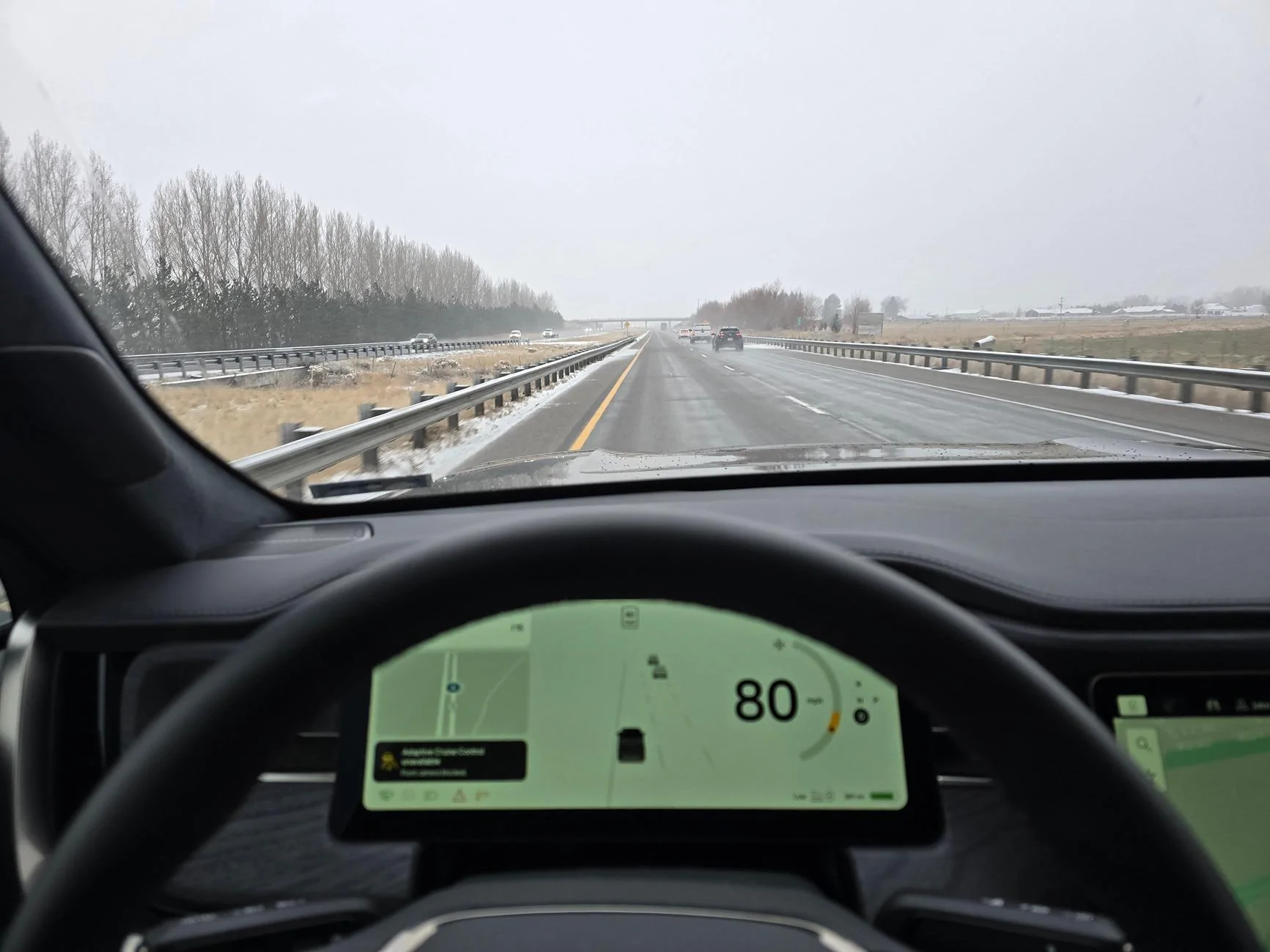

Omitting traditional cruise control is annoying and problematic, but it would be workable if the ACC could reliably work. Mine shuts off when there is a slight mist and it's cold outside. I wish they would have located whatever system they use (cameras or radar) in front of the rear view mirror on the windshield so the wipers could always keep it clear. My front bumper gets rain, sleet, and snow which blocks the sensors so quickly.
