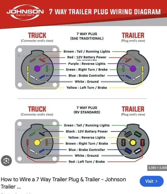

You could tap into the Reverse in the 7-pin plug which is the center pin in the plug. This is used commonly in RV Trailers for backup lights as well as boat trailers to disengage the brakes when backing. See the standard wiring diagram below...
This would make the truck think you are towing which will deactivate any assisted cruise though.

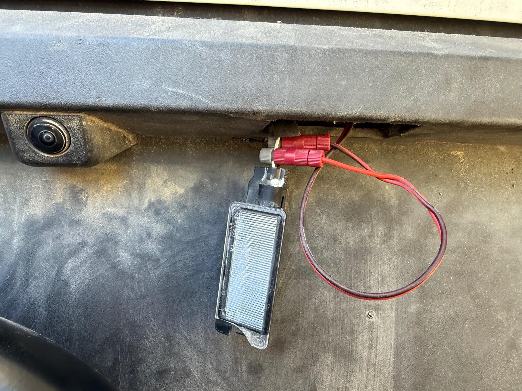

I recently added a hitch mounted tire swing to my R1T.

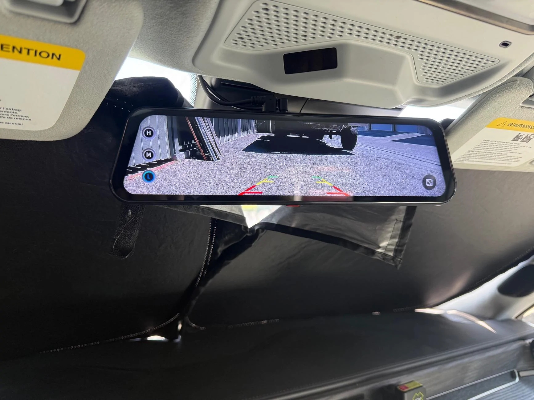

After a couple weekend projects worth of looking like a tweaker in my garage I have a completely usable solution for wiring my license plate light, and more importantly for this thread, I found a location for a 12v reverse trigger to make my aftermarket rear view camera work. (wolfbox G900 Pro, if you know these type of cameras you know you need a 12v signal to make the reverse lines function)
The license plate was easy just popped to tabs and pulled down enough to splice, it was annoying because I had to fish around a plastic channel that is in the bumper for the proximity sensors

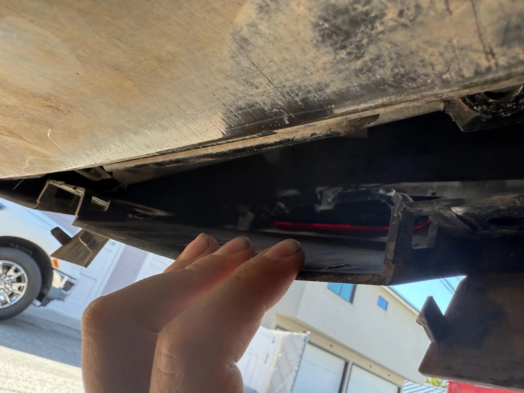

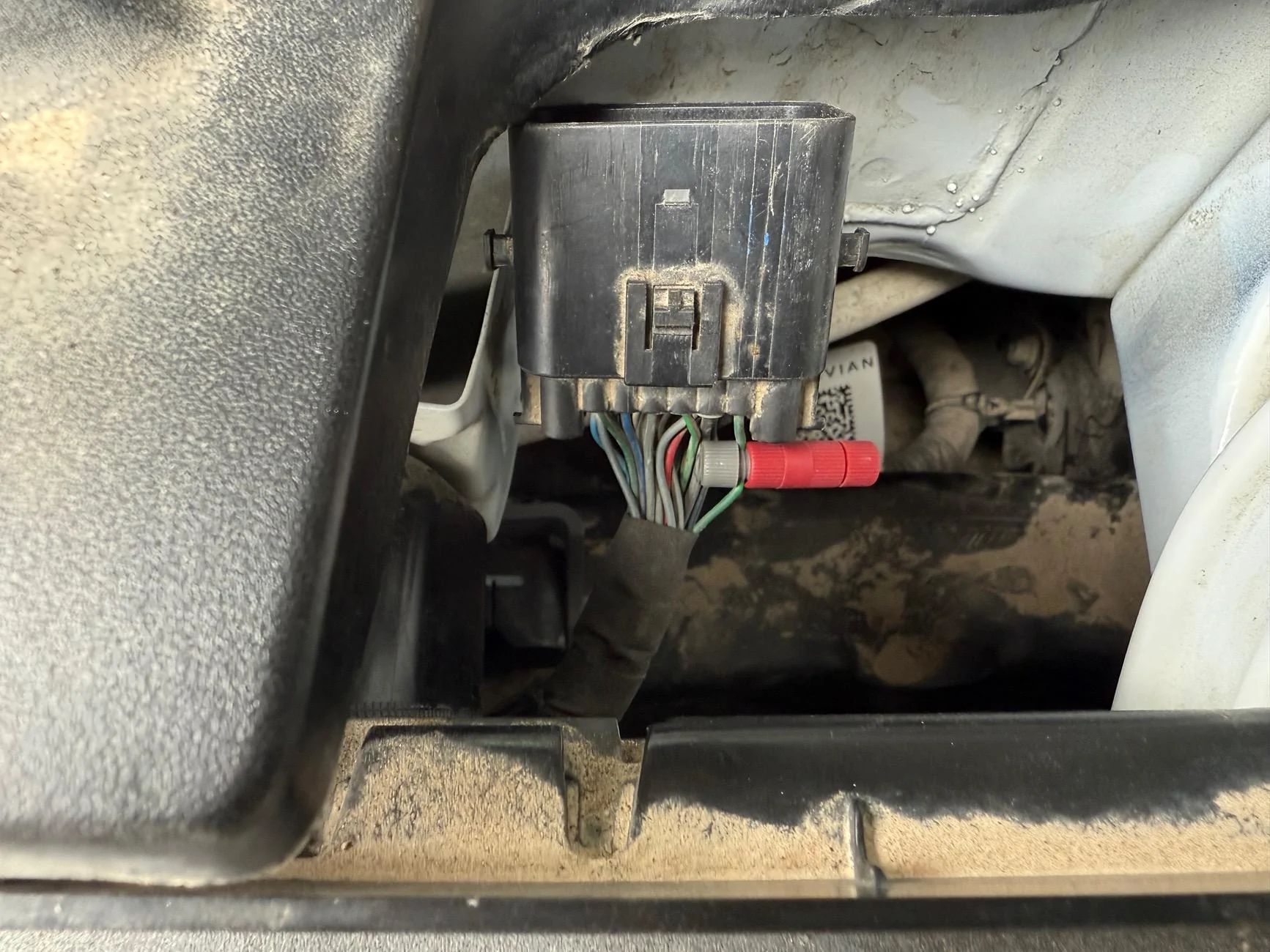

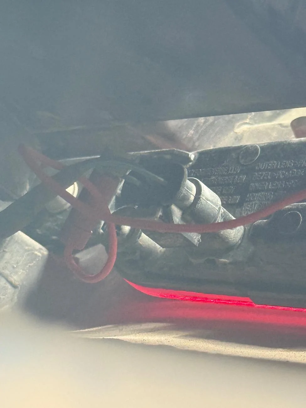

Ultimately I was able to splice into the rear light on the passenger side, if you go this route I recommend this side as the driver side has a strut that cuts into the working space
Rivian R1T R1S Aftermarket Backup Camera install question IMG_2216
I was able to make enough room by pulling most of the trim torx connectors but I think I can figure out a more elegant solution

-The solution has not created any faults or system errors
-maintains all driver+ functionality (my T is an earlier gen1 build)
-Tow mode is NOT falsely engaged
-it is not draining the battery and the lights function the same as the regular reverse light and license plate light
-it is removable/ reversible
-It would be very doable as a single day project (especially if you have a rough guide to follow)
Currently I have a working solution but I think I can troubleshoot a much easier route, just need to get a new battery in my voltmeter to continuity test properly
Final goal is to be able to splice in to the loom in the bumper harness and avoid having to pull any trim pieces/ parts
Rivian R1T R1S Aftermarket Backup Camera install question IMG_2185
(This is an example, this was not the right wire, just an example of what I want to accomplish)
