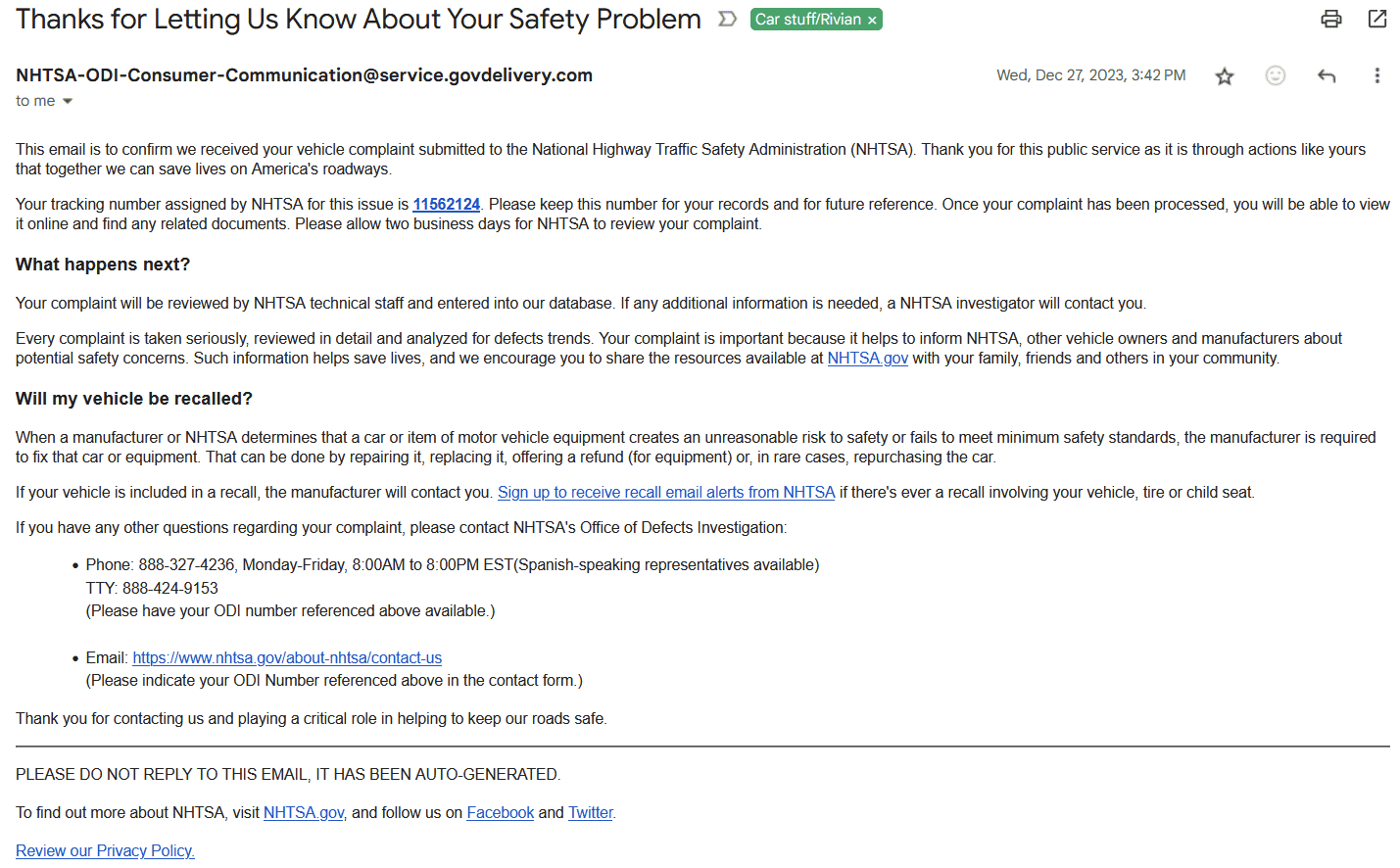

I wonder if it helps to reference each other's filings? Did you get some sort of file number or something? I'm used to dealing with the FCC and every single filing gets a reference, and then I can file mine under yours. A literal pile-on.
Hi! Good question. Yes, they did. # 11562124.

I don't want to barrage Rivian with trivialities but I do think this is a legitimate safety concern, as many others have noted as well. I think it's something that could be easily adjusted via OTA software update. Unless it's set at a particular threshold for legal reasons? ?
