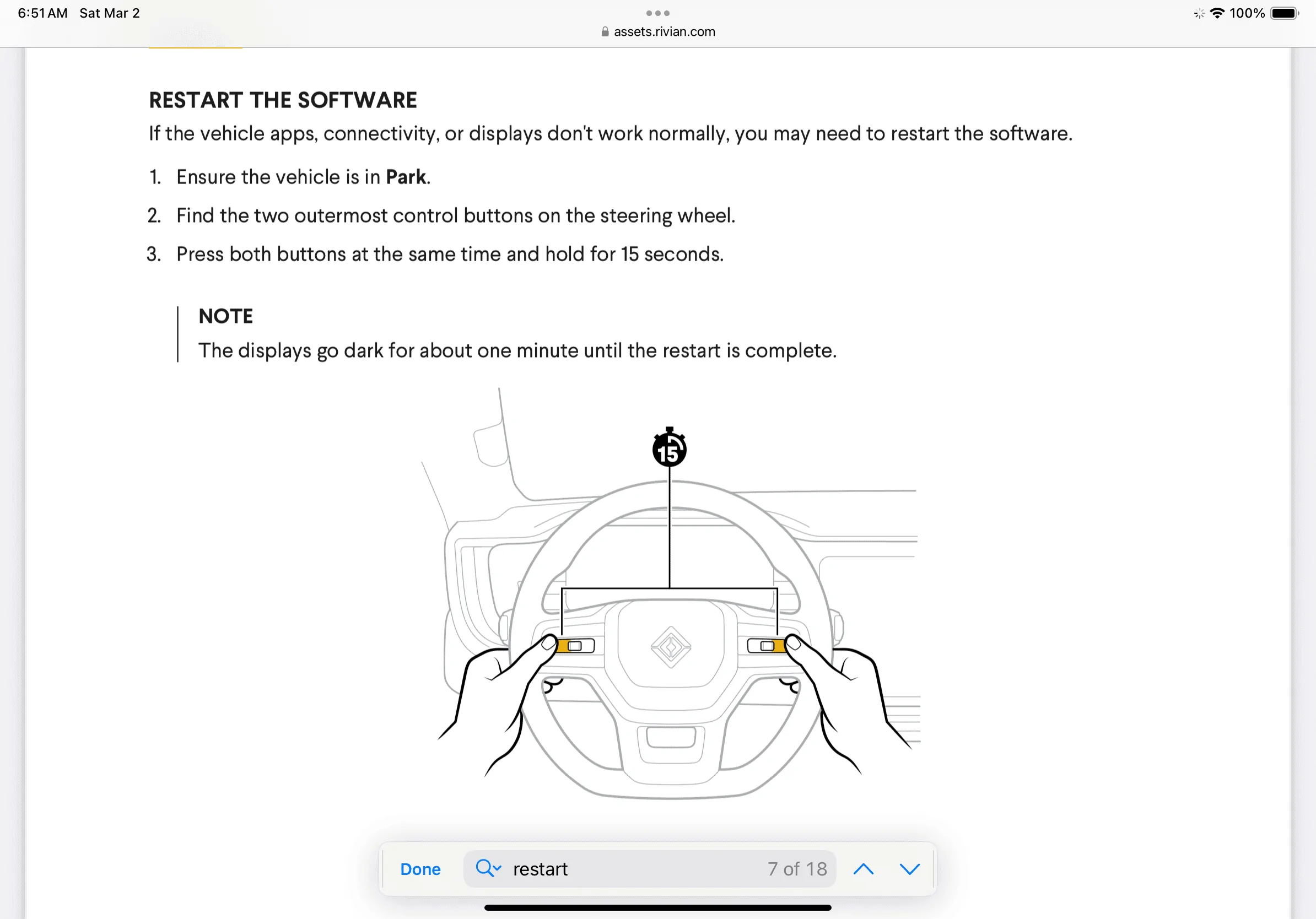

Same issue. Rebooting the infotainment center did nothing to solve the issue.

I did the soft reboot and it worked...but only briefly. Within a couple of days, if not sooner, Alexa was gone. Very frustrating.

We have a brand new R1S. Alexa worked the first day and since then hasn't been working. I can confirm other internet services work (maps, spotify, etc.) but Alexa just says "Can't connect." I'll give the soft restart a shot, but it seems like that's hit or miss.

Very glad to see the Alexa fix on the forums. Alexa quit working for me last week, but it wasn't until yesterday that I had the time to deal with it. I turned to this forum to see if there was an easy fix, and found this thread.
It took two soft reboots before Alexa "woke up" and asked me to log into my Amazon account to reconnect my Rivian to my account. That worked. Alexa is back chatting with me again, and everyone is happy again.
