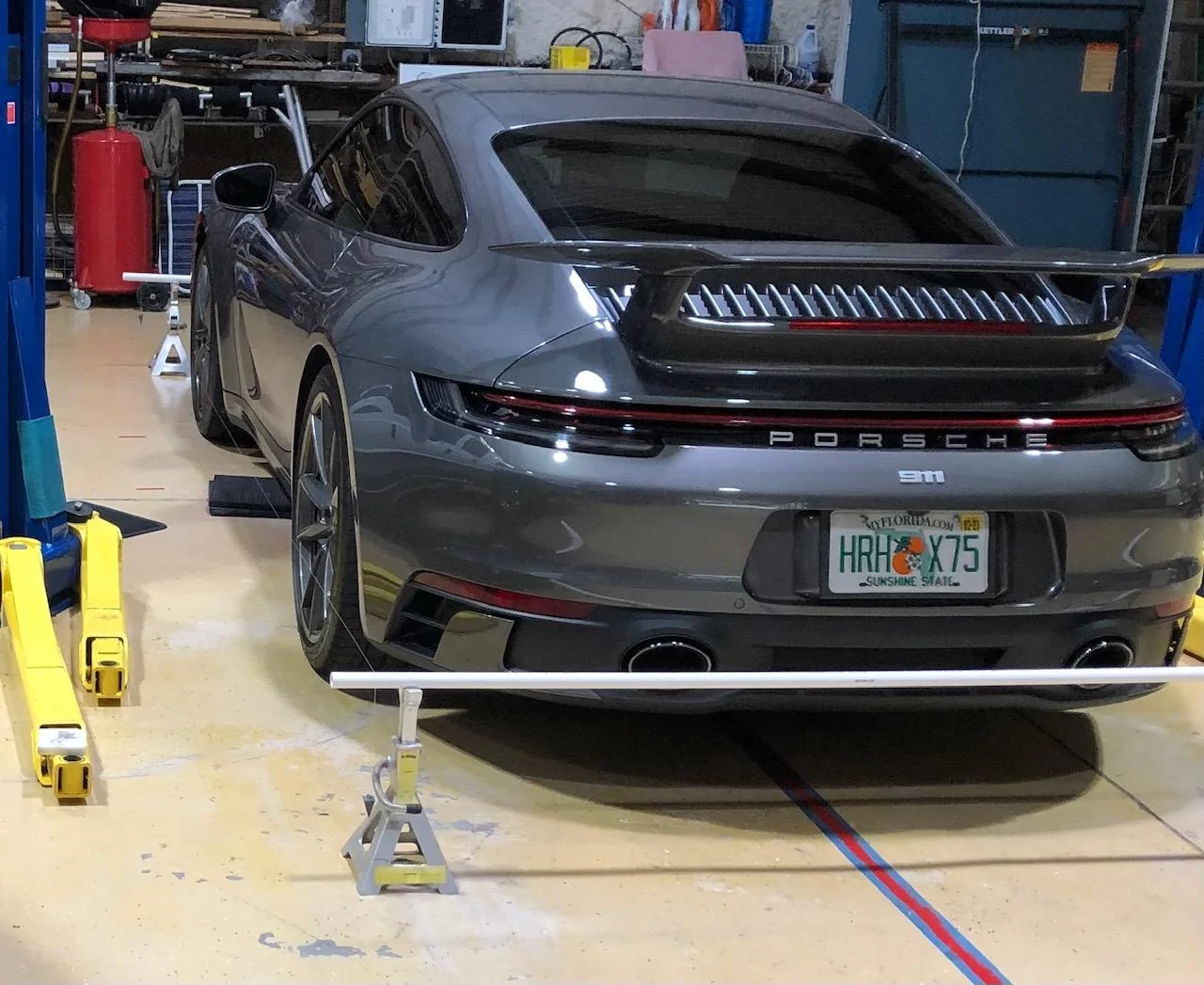

It's easy and very accurate to check the toe settings yourself if you are willing to take the time and be meticulous. You have to build a "string box". We do this for track cars. It is more accurate than a Hunter rack.
Rivian R1T R1S Alignment, hitting bumps, and off center steering wheel 992 string box

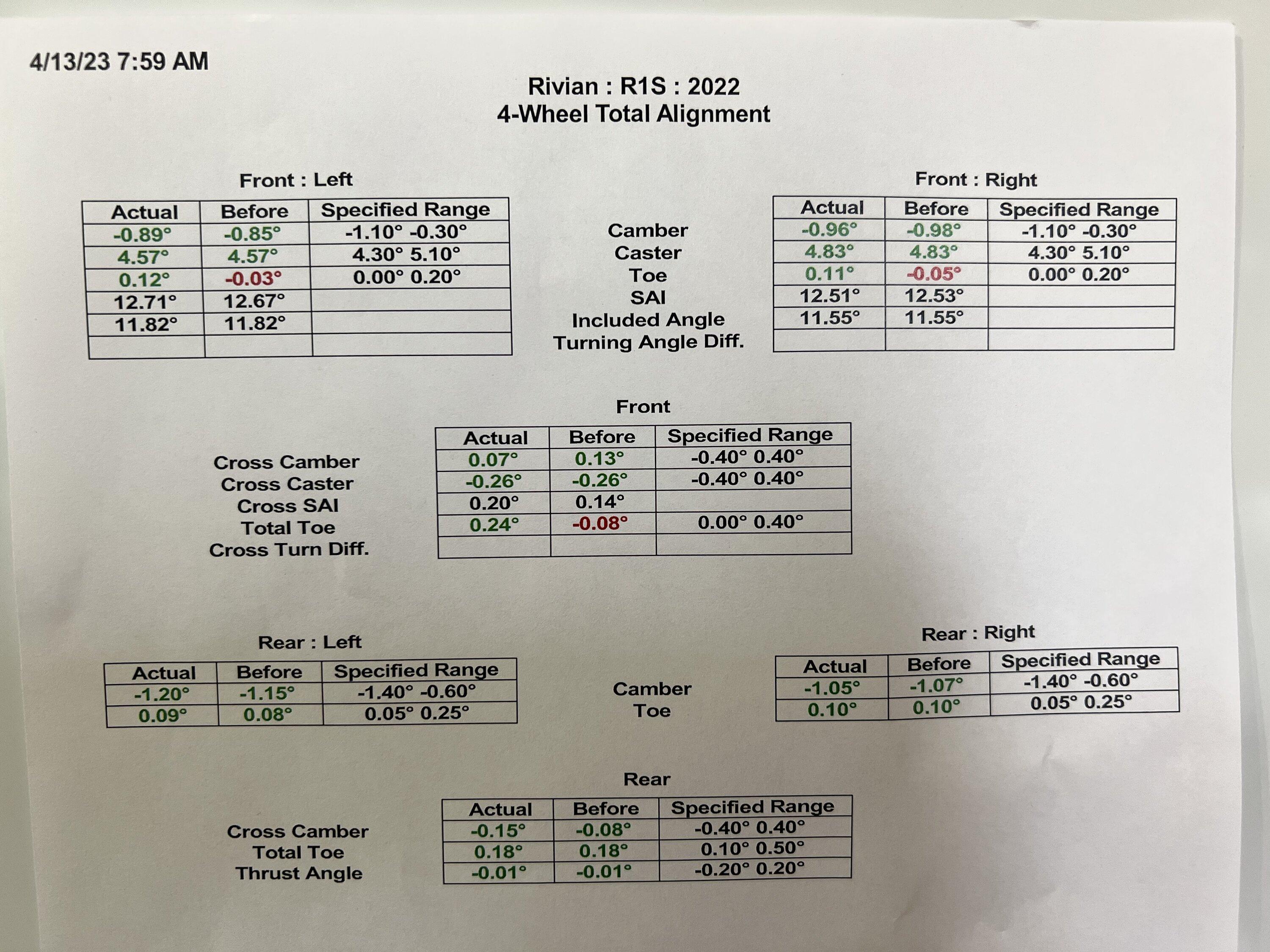

Here is my R1S alignment sheet in case it would be helpful to someone in this forum.
It pulled to the right when steering is centered. After the alignment last wwek at the service center, its aligned well.

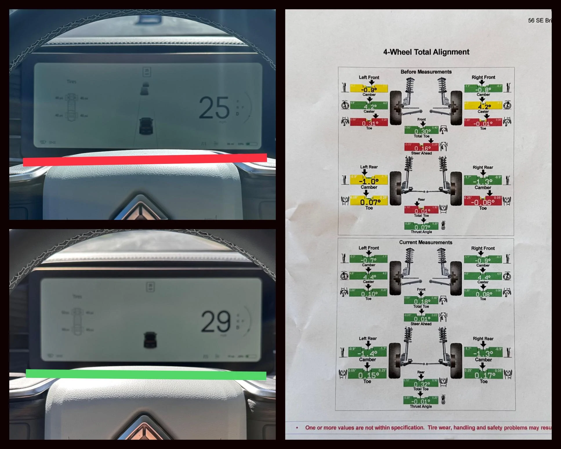

Follow up after having alignment done by a motorsport shop that specializes in alignments, corner balancing, etc. They spent quite a bit of time on mine, partly because they'd never done a Rivian, partly because they didn't really have any factory specs to go by and partly because some panel remove was required (or they removed thinking it was required).
Anyway, below are my before/after ... both how the steering wheel looked and the numbers.
Did about 50 miles since, including on crowned highway sections, and it's straight as an arrow now. I still think the quad motor set up, how they're calibrated, throttle inputs, etc play into how the truck behaves with regard to tracking -- i.e., some of the above could be misconstrued as alignment issues. But as far as my steering wheel and how the truck reacts when letting go of the steering wheel, an alignment corrected my issues.
