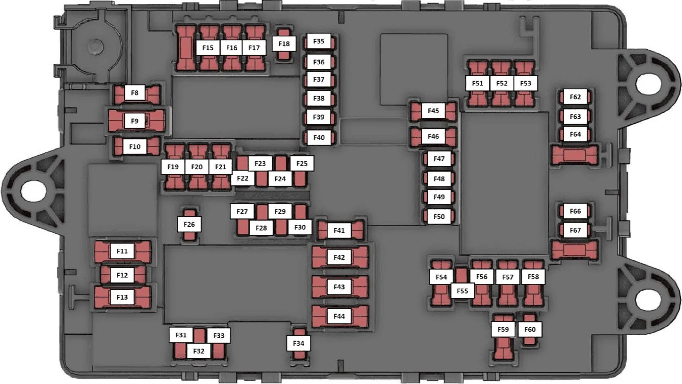

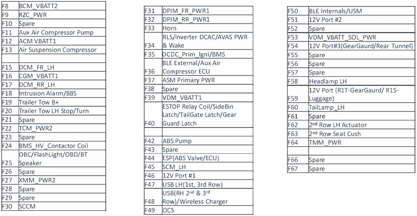

Blown fuse in the inverter circuit?
Thanks for the idea...but it appears that is not the problem. The fuse appeared fine, and replacing it with a spare didn't help.
So perhaps I have a bad inverter. Who knows when Rivian might decide to get around to looking at it. We thought these outlets would be handy on camping trips, but I guess not for a while at least.
Sorry it wasn't the fuse, but at least you now know you won't be wasting a lot of time and effort to a SC for a simple blown fuse.
