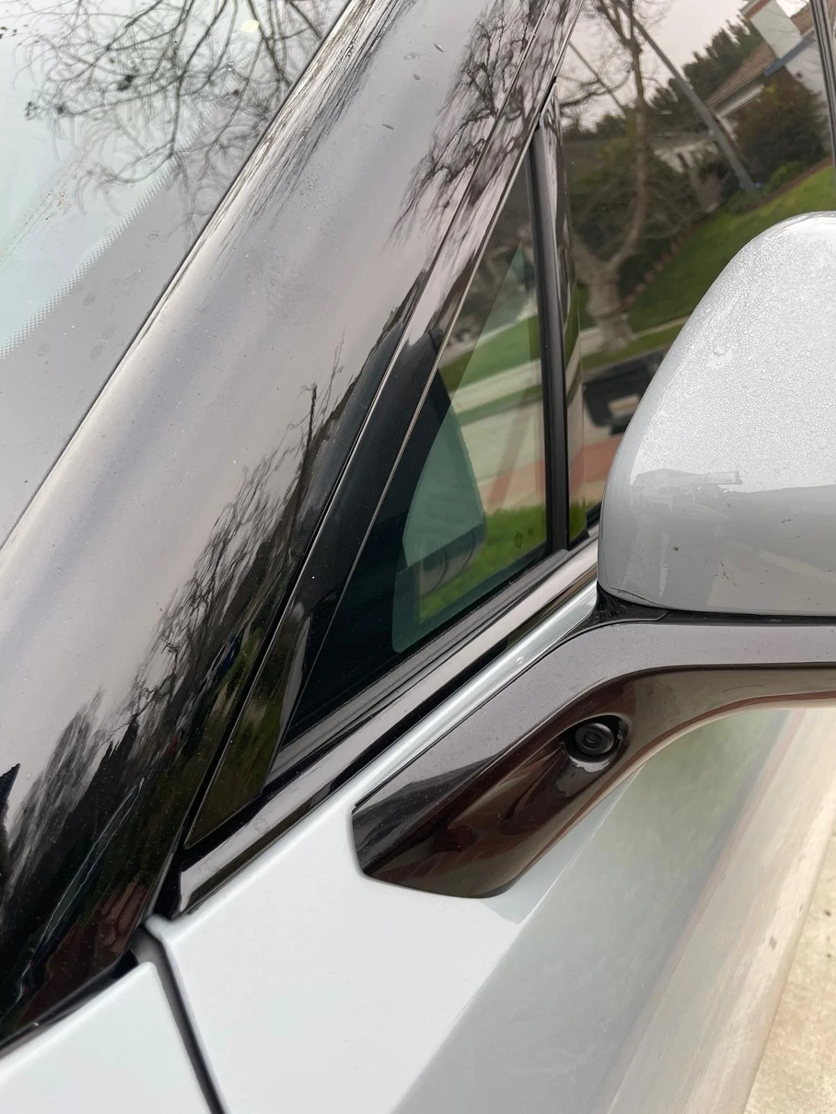

Hi guys,
Coincidentally I had the same annoying issue with my R1S with noticeable driver's side wind noise above 70mph that drove me crazy! I had a service appt at El Segundo two weeks ago for other issues (namely replacing the roof glass that I cracked with my elbow :rolleyes:), but while I was there, I mentioned this issue too.
My service advisor got a knowledgeable Tech to do a drive with me to see if he could hear anything out of the ordinary, and he noticed it right away at like 50mph, before we even got on a freeway. They added it to the ticket and ended up replacing the corner glass as well as the rubber gasket (I believe) and it's made a world of difference! The car feels like a vault at freeway speeds now, as it should! I have to get the window retinted now, but it's a small price to pay for a permanent fix! Picture below is after replacement (I did not get a "before" shot).

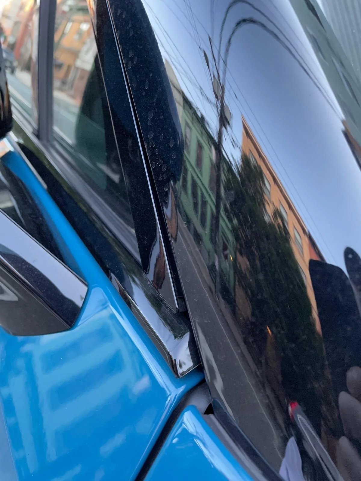

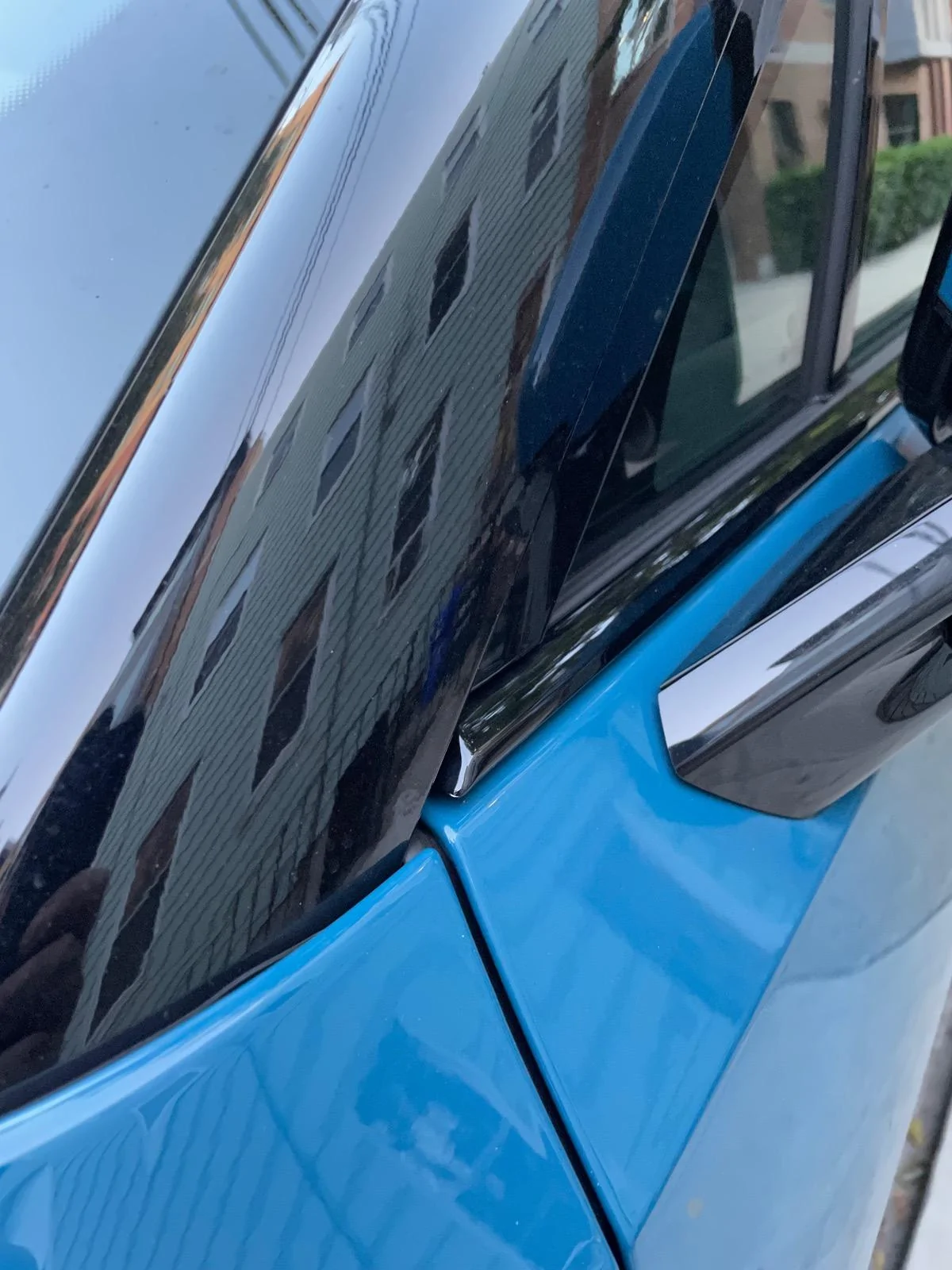

I think there is a lot more to unpack about the wind noise issues at the corner. Take a look at my driver side versus the passenger side when I first got the truck. Drivers side corner trim is all nice and tucked in behind the A pillar. The passenger side has the trim slightly off the door and sticking out beyond the A pillar. On top of that, the A pillar is seated farther in exposing all the other issues already mentioned.
