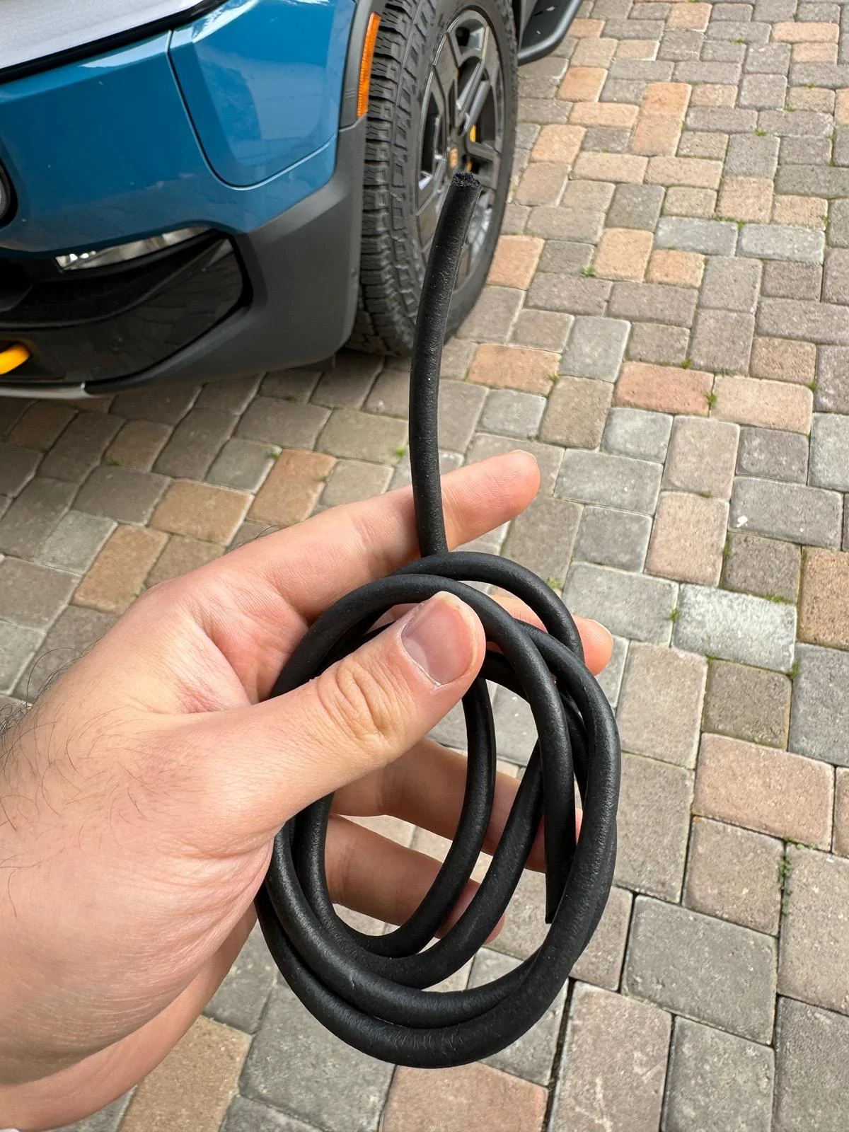

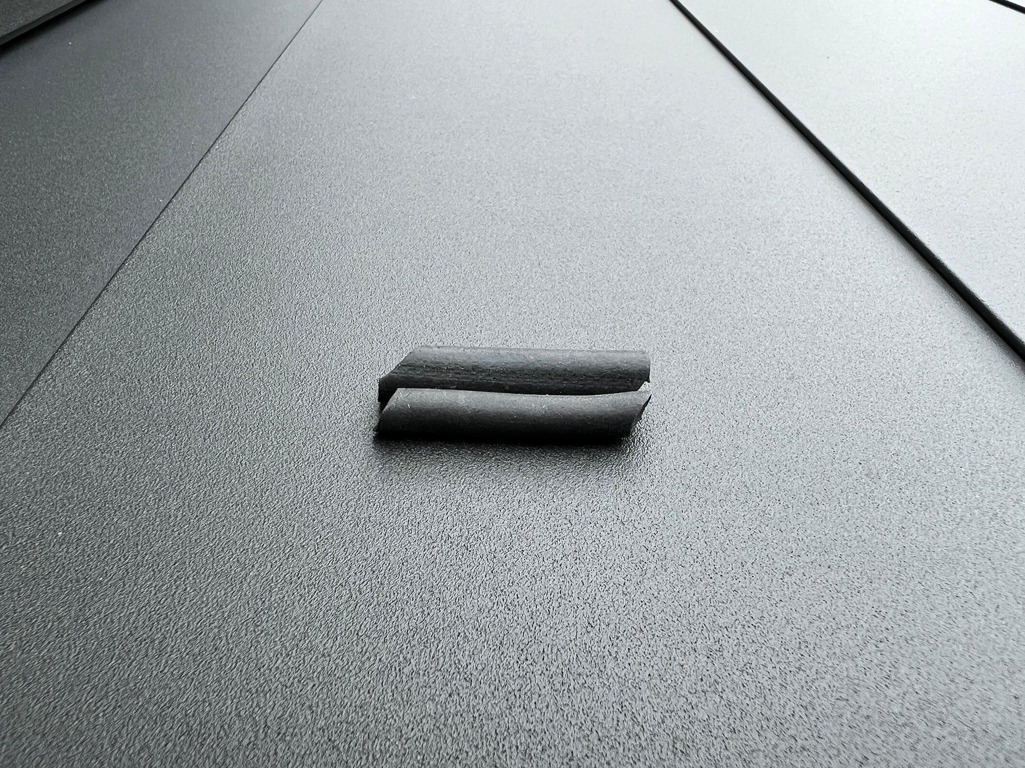

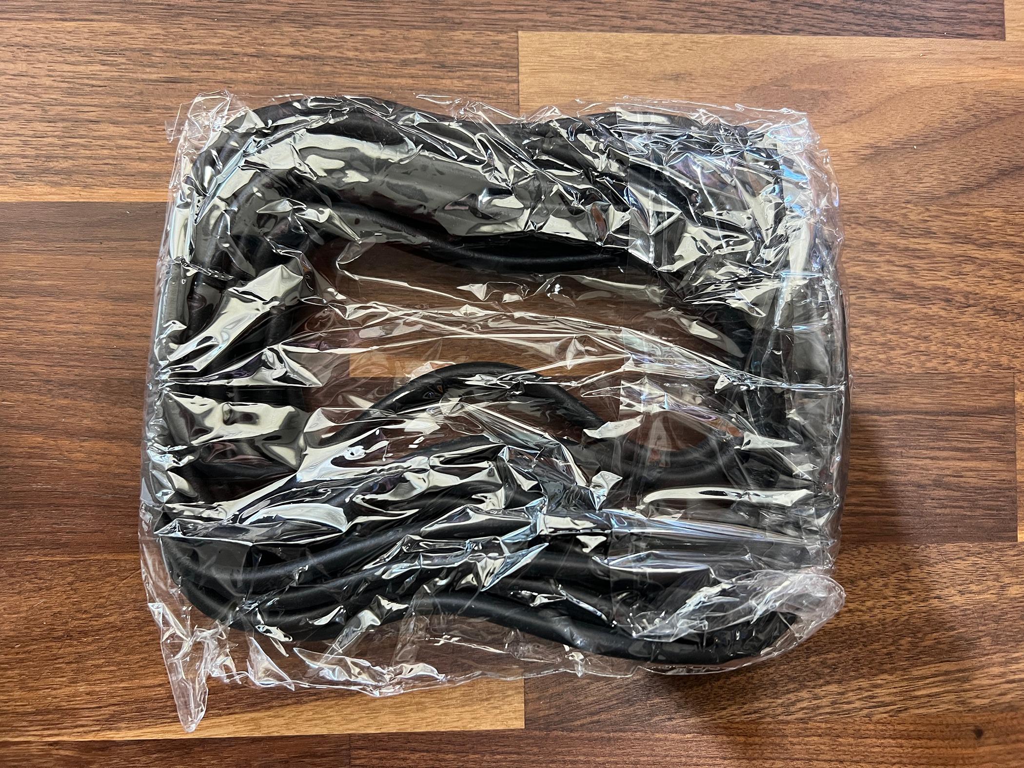

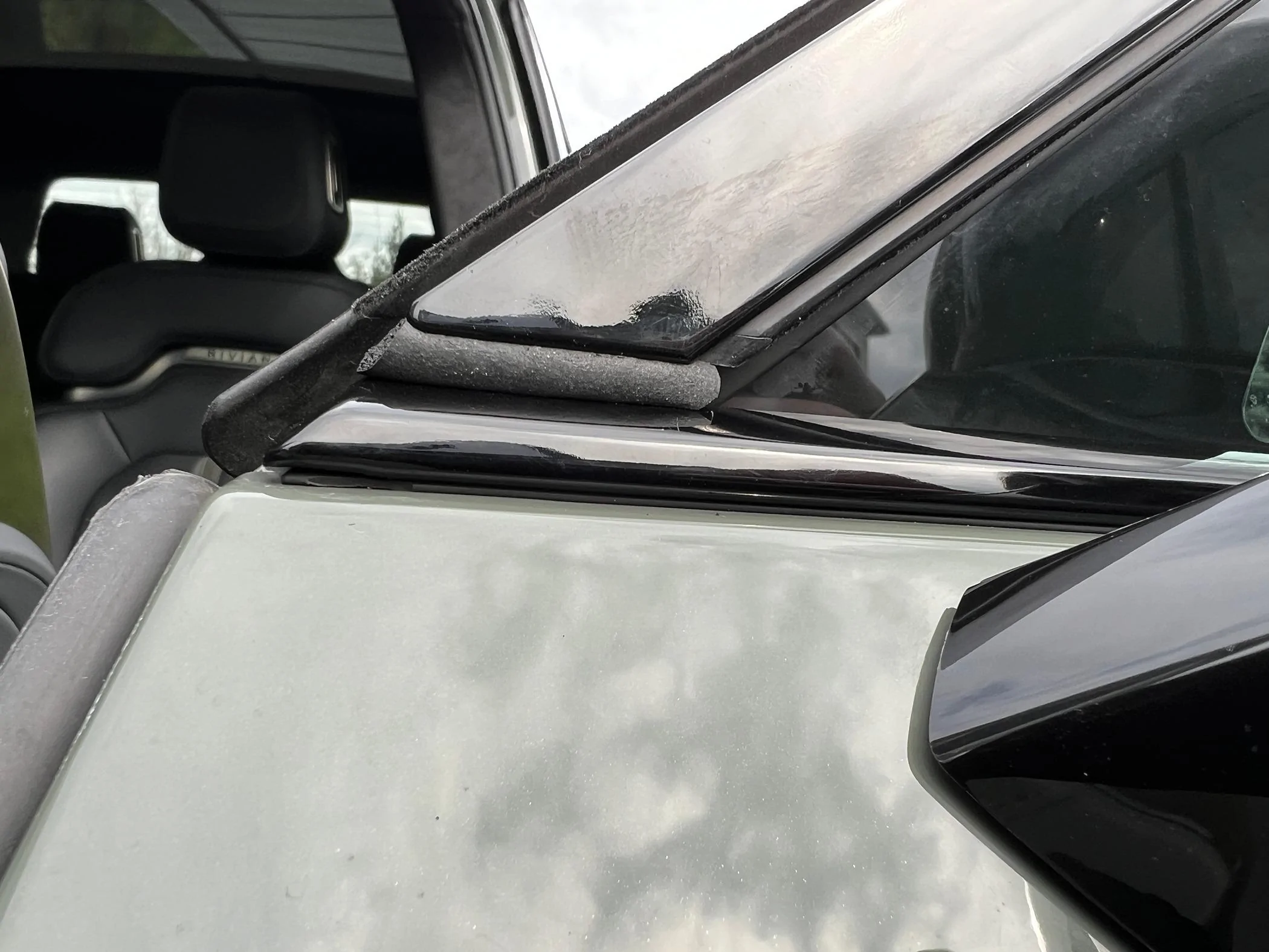

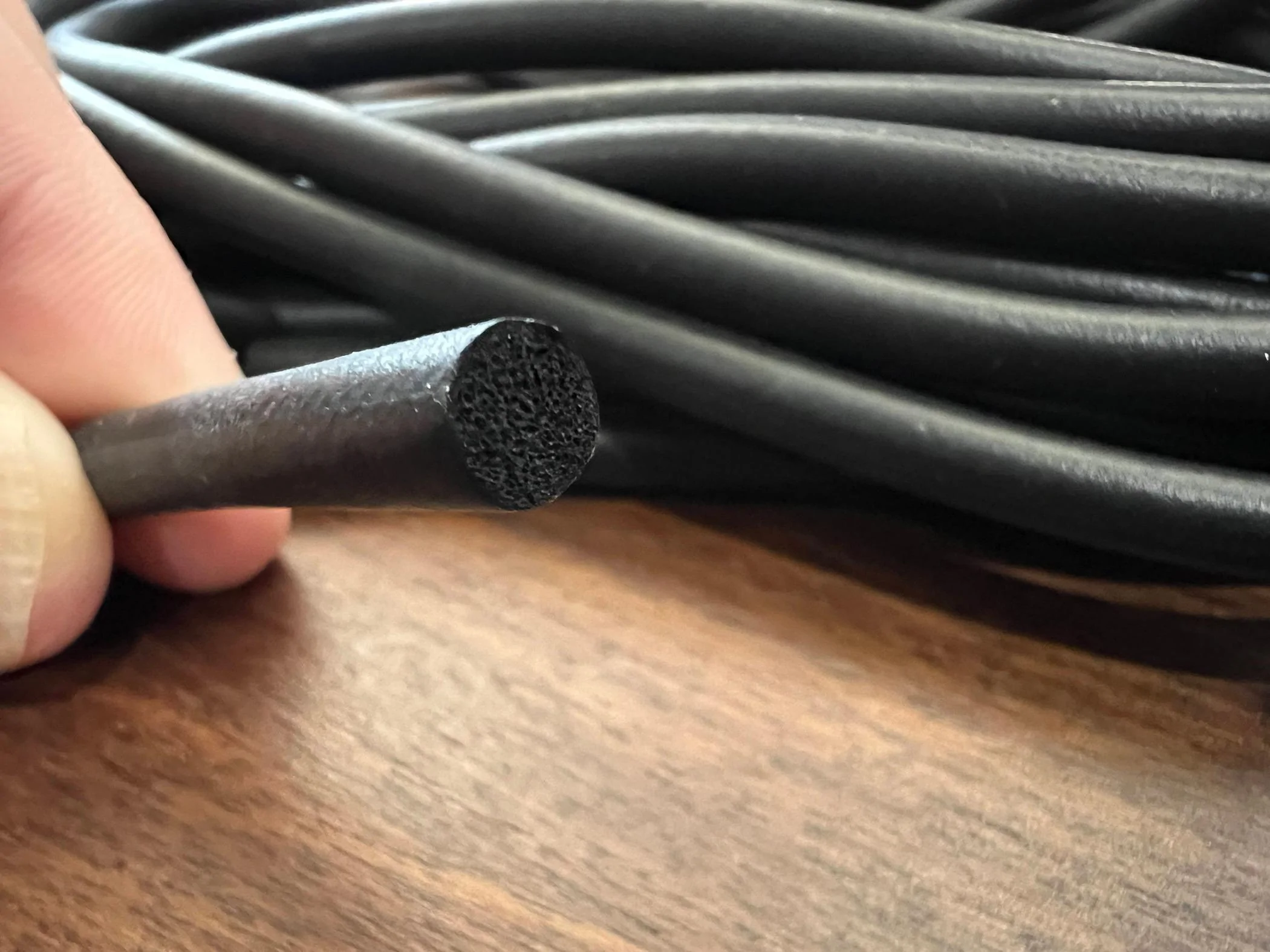

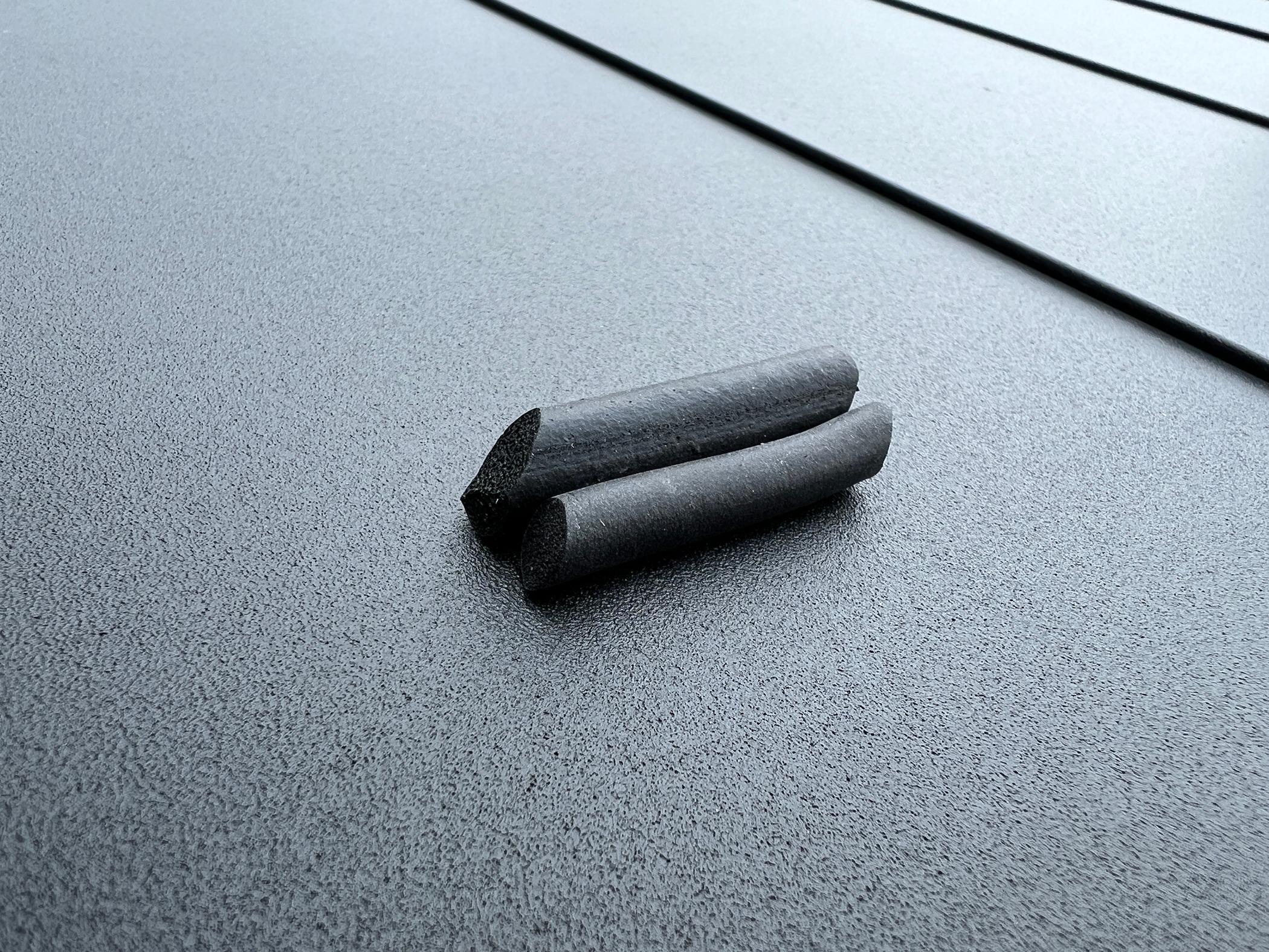

So, I've done a bit of testing with this earlier today. I ordered the same item that OP identified:
Rivian R1T R1S Resolved (my) excessive wind noise 2023 R1T (cause: corner window plastic trim) IMG_2112
Rivian R1T R1S Resolved (my) excessive wind noise 2023 R1T (cause: corner window plastic trim) IMG_2113
Rivian R1T R1S Resolved (my) excessive wind noise 2023 R1T (cause: corner window plastic trim) IMG_2115.JPG

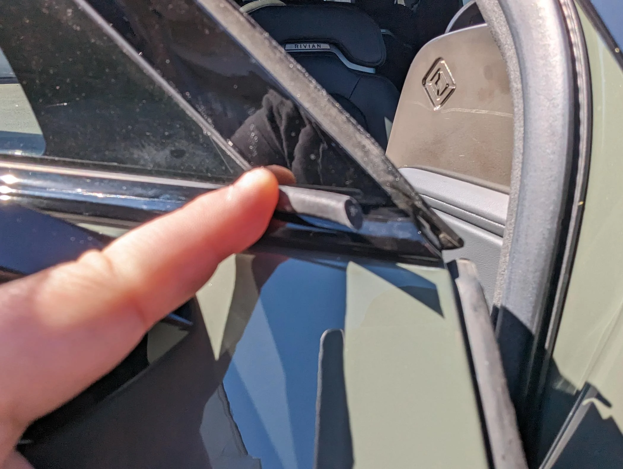

And I decided to test it on a 10 minute or so loop, twice in a row. Once with the gap-filling foam installed and once without. Each loop was driven in portions ranging from 60 mph to 75 mph (allegedly).
Rivian R1T R1S Resolved (my) excessive wind noise 2023 R1T (cause: corner window plastic trim) 1711310374265-s3

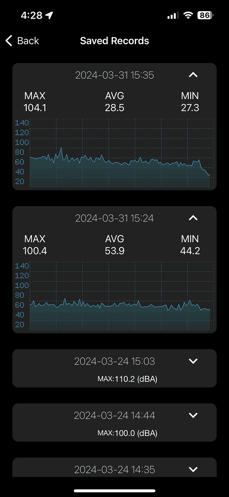

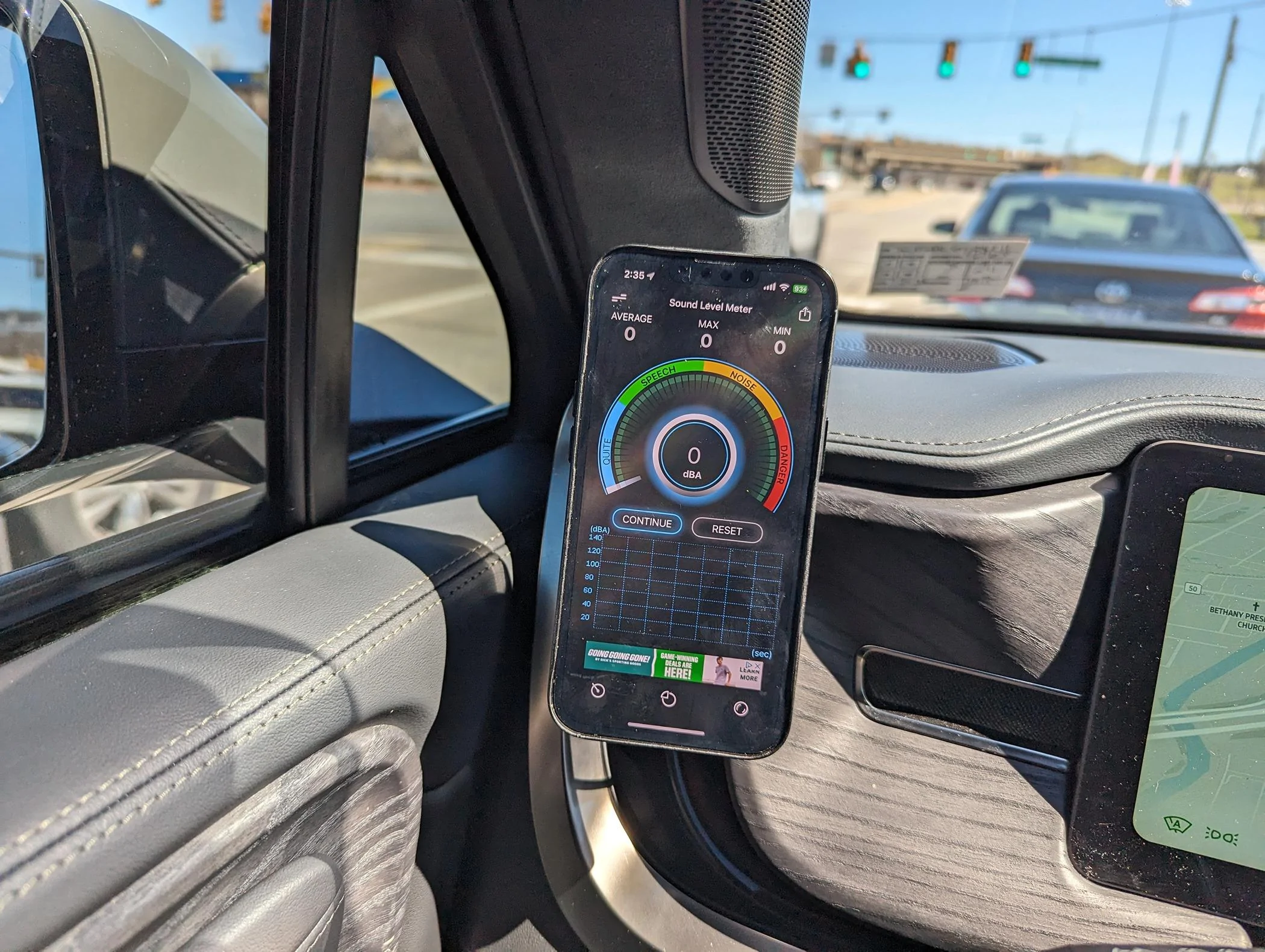

During each run, I used a sound level meter to determine if there was an overall difference between having the foam installed and not. The phone was installed on my NextGen Phone Mount, which is close to the window:
Rivian R1T R1S Resolved (my) excessive wind noise 2023 R1T (cause: corner window plastic trim) PXL_20240324_183539675
I also listened with my own two ears to determine if there was a wind noise difference as the sound meter might not show anything.
All that said, here are my results:
  • There was no difference for me using the sound meter. Average dB inside of the truck was between 65-75 on both runs.
  • There was a difference in the amount of wind noise. I would consider it easily perceivable. Somewhere between slight a moderate. The noise was not completely removed.
  • Wind noise in the truck is very much not the peak or the floor. Road noise, tire drone, traffic, and road imperfections account for nearly all of it, so it seems.
  • There was a clear elevation in both the dB level and the wind noise based on speed. At 60mph, there was little. At 75mph, there was a bunch. The difference was around 6-10 dB.

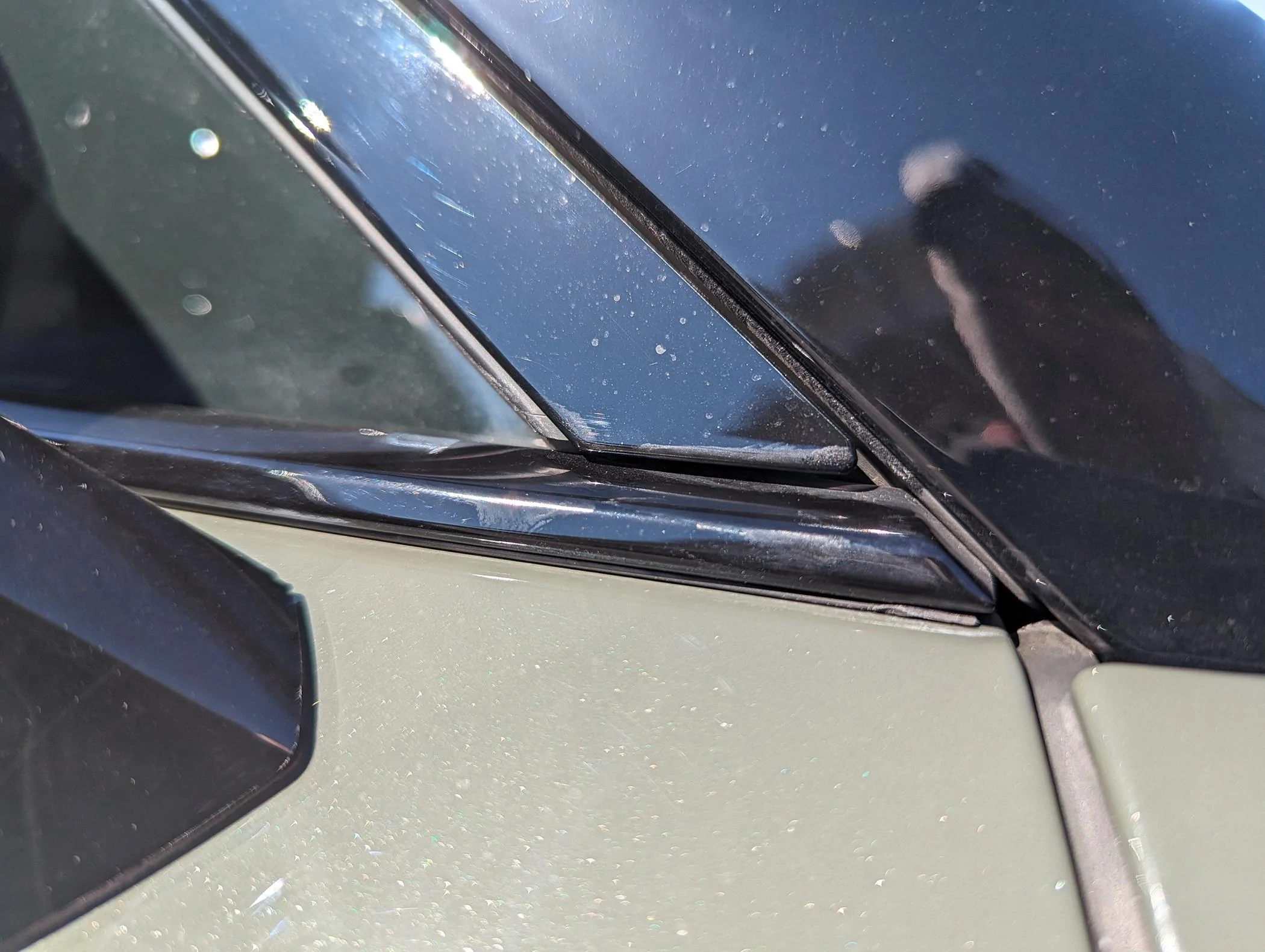

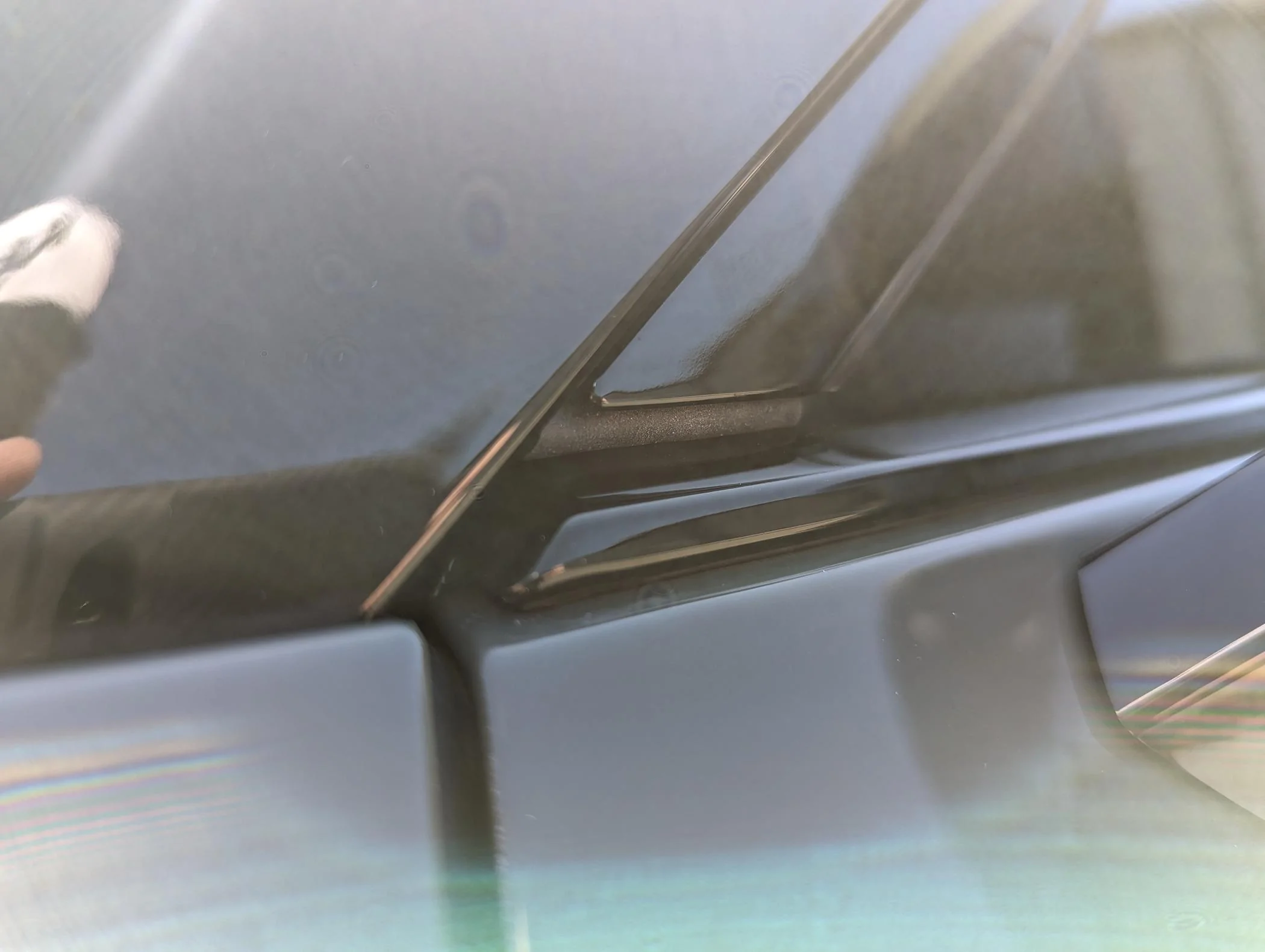

I think my vehicle might also be a bit of an outlier here, or there is clear variability in the Rivian vehicle fleet. For instance, here is my passenger triangle:
Rivian R1T R1S Resolved (my) excessive wind noise 2023 R1T (cause: corner window plastic trim) PXL_20240324_185203178
I could not get the foam in there even if I tried:

On the flip, here is the driver side (with some really weird reflections):

I could probably due with an 8MM or 10MM bit of foam:

To sum up, this additional foam weatherstripping IS likely helpful for a bunch of folks, but not for everyone. Some folks need none of this. Some others need a larger diameter product.
I'm going to see if 8MM or 10MM work better for me. I'll post an update after I'm able to test.

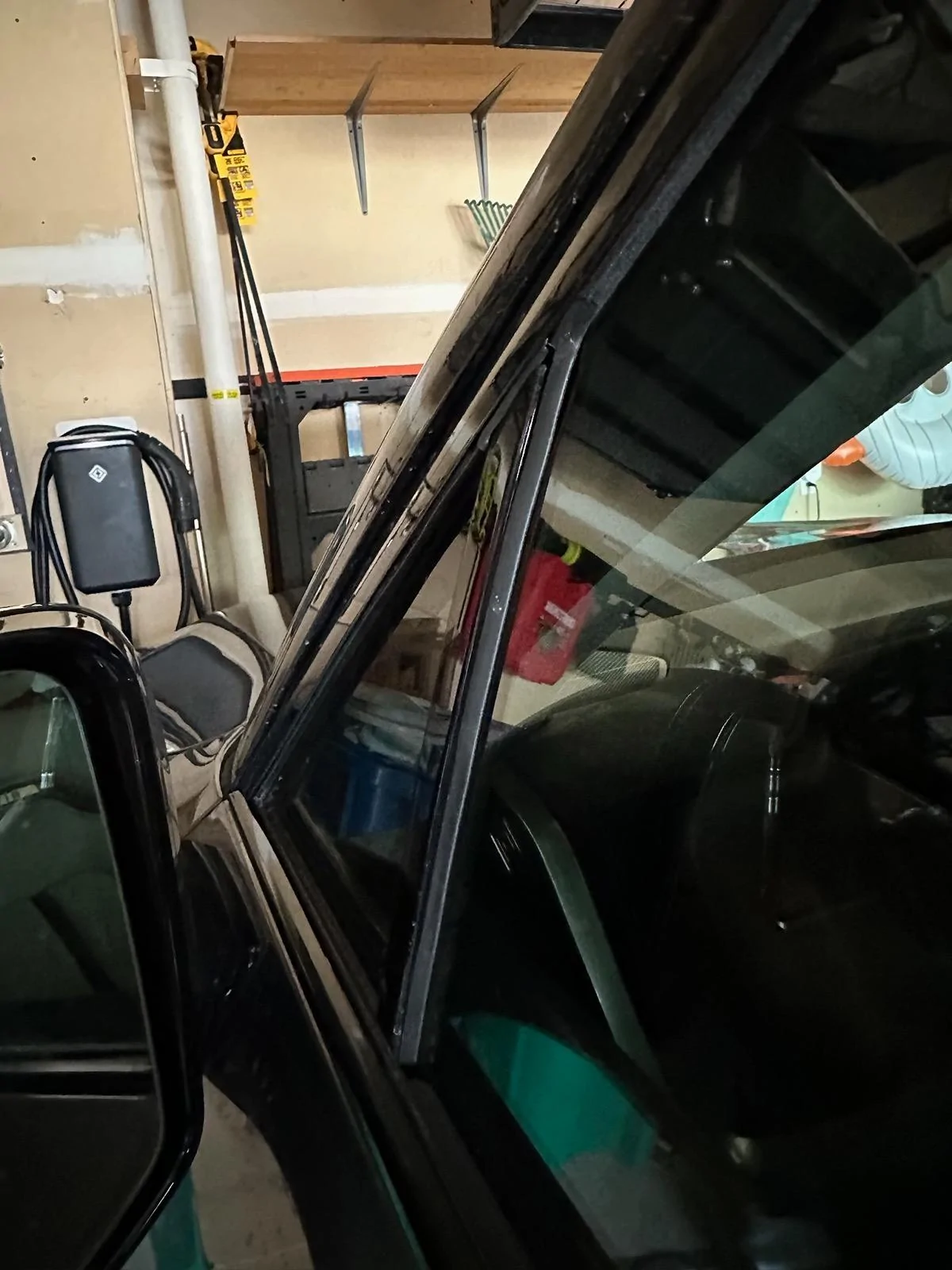

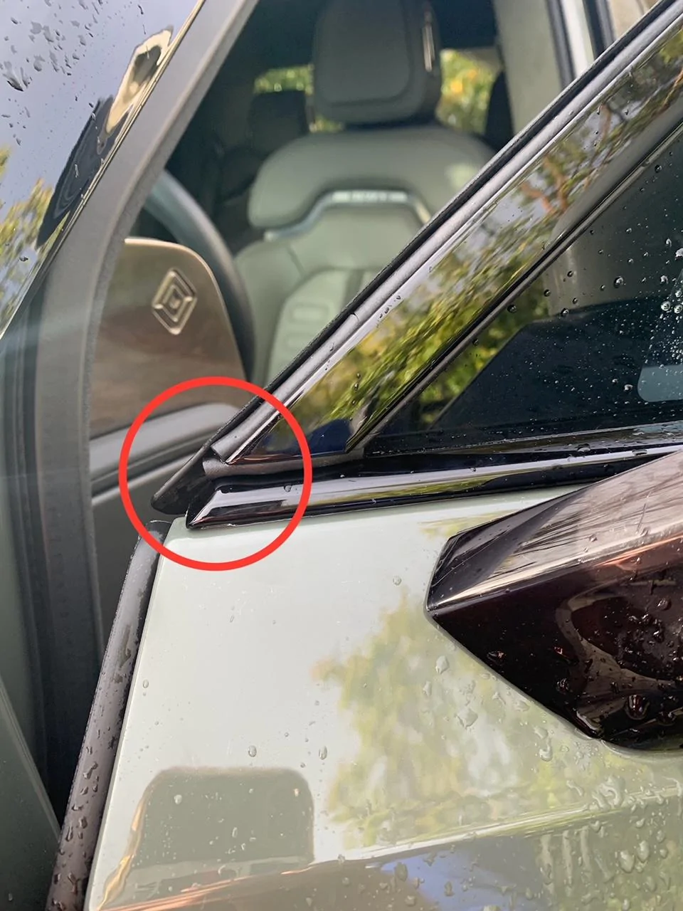

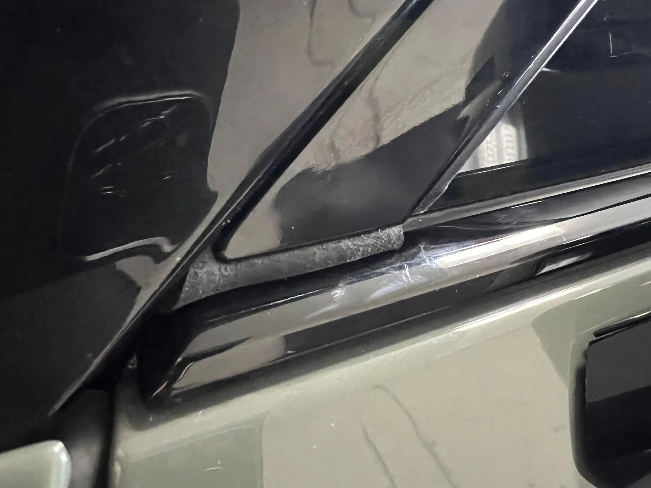

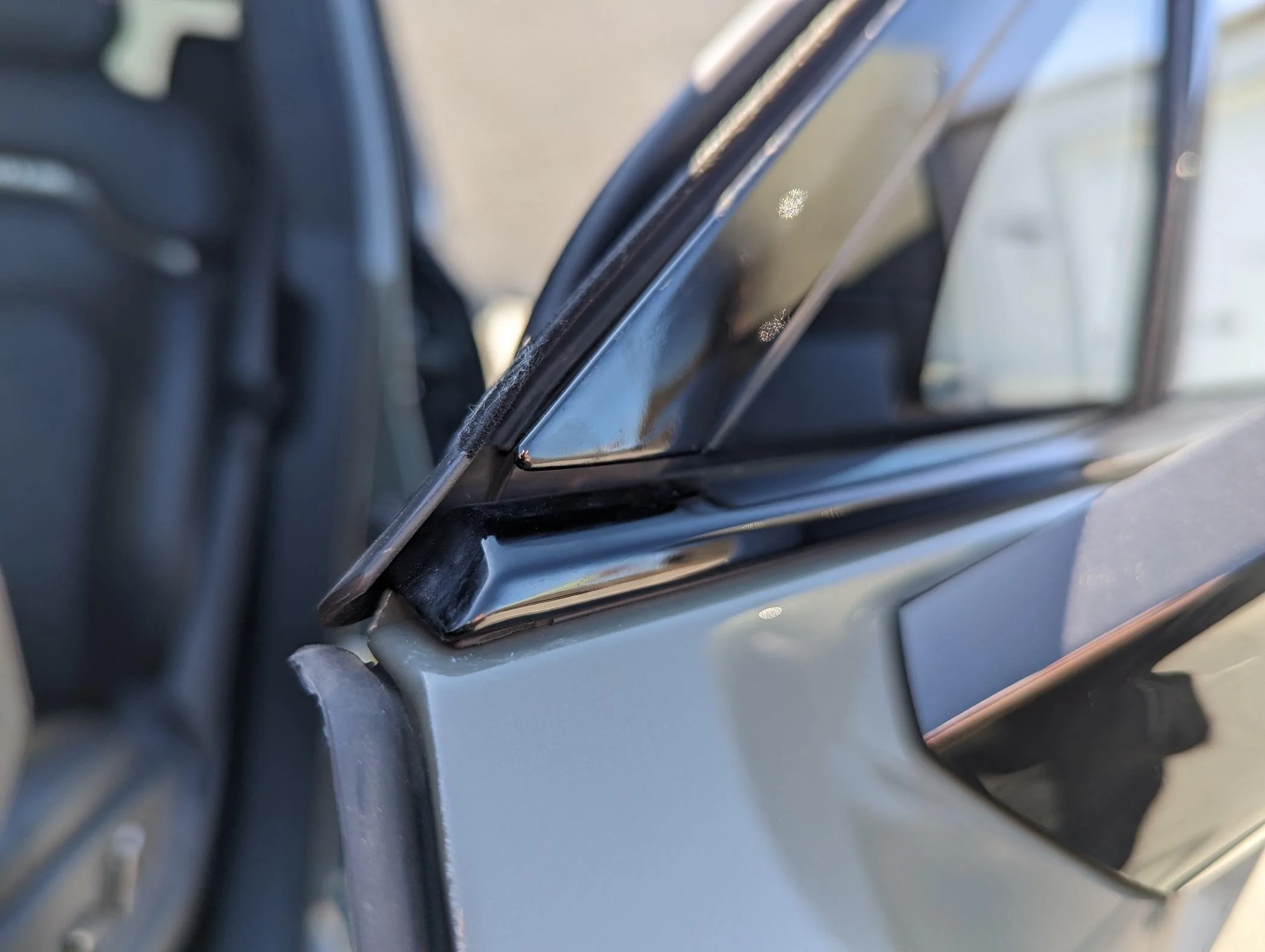

I have tried to have the SC resolve my wind noise since day 1 of getting my truck 1 year ago. It’s taken away from enjoying the vehicle as it was turbulent and excessive at anything over 55 mph. Nothing worked to resolve it and SC didn’t do anything to help either (all within spec). I watched a few YouTube videos and posts about using rubber weather stripping tubing around the top of the vehicle. Rubber inserts along the roof rails, I taped up all the corner windows to see if it was them causing the noise.. nothing worked.
Recently I noticed the edge of the corner window plastic trim piece a few mm outboard of the left and right driver side doors (pic attached). I placed a small piece of leftover cylindrical weatherstrip into that lower plastic edge and BAM.. my wind noise is 90% gone. I thought it was a fluke. But have driven about 100 miles highway and with crosswinds near the coast and it’s much improved.
Up to this point the wind noise was so bad (and I’ve had a number of other issues with my truck come up) I was ready to get rid of the Rivian, not sure now as the ride is much more enjoyable when it’s quiet on the highway.
Pretty sure this is a build/ door alignment issue which is why some trucks are dead silent and others are super noisy. Hope it helps others, though I’ve realized not all solutions work for everyone.

I ordered and tried this a few days ago. I’ve had service work on mine three times without totally resolving it. Still seems to originate from the small triangle window even after replacement. I would say adding this piece of foam did improve the noise further but didn’t totally eliminate. Totally worth a try for the cost.

As promised, I ordered the 8MM and 10MM size to test. Here are the results:
10MM size was immediately too large. I'd suggest that if you require something that big, it's a clear call for service as something is really wrong. 8MM. alternatively, size seemed to fit well for me. A comparison between the 6MM and 8MM size:

Here is what the 8MM size looks like installed for me:
Rivian R1T R1S Resolved (my) excessive wind noise 2023 R1T (cause: corner window plastic trim) IMG_2131.JPG
I ended up moving it up a smidge:
Rivian R1T R1S Resolved (my) excessive wind noise 2023 R1T (cause: corner window plastic trim) IMG_2133.JPG
Long story short - clear improvement over not having it. It's the difference between, "a bit more wind noise than I want from my side-view mirror" and, "It sounds like I'm constantly being passed by another vehicle". It's even noticeable on the dB graph. Pay attention to the first half of the graph, which is highway speed at 70 MPH. The run on top is the one without any foam:

So, following up on my prior post, I would absolutely recommend this. While not earth shattering, there is a clear difference. Installation is less than 60 seconds and completely revertable.
I would suggest that you measure the gap and order the correct size (go slightly larger). Alternatively, I think I'm going to add a kit to OpenSourceEV.com for this. Likely 4 inches of both sizes for like $1. If you want to take a flyer on it with another order, that's a lot better than $12. At that $12 price, I still think it's worth it though.

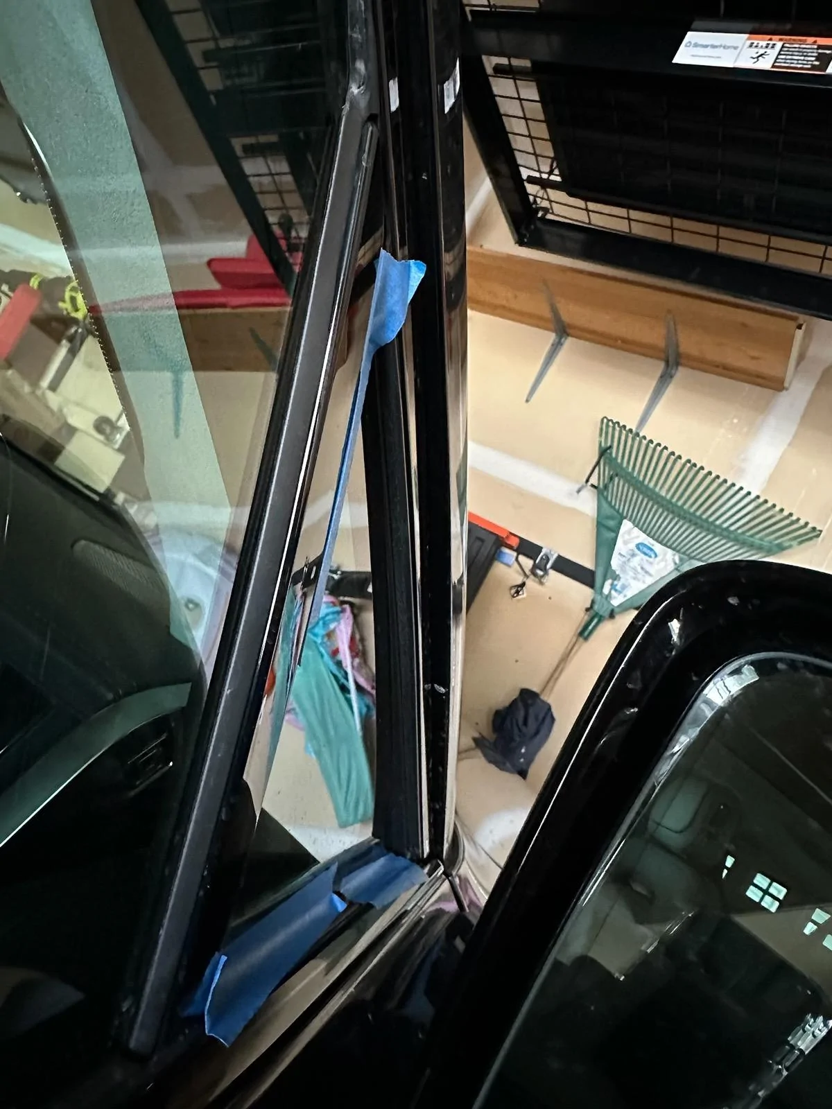

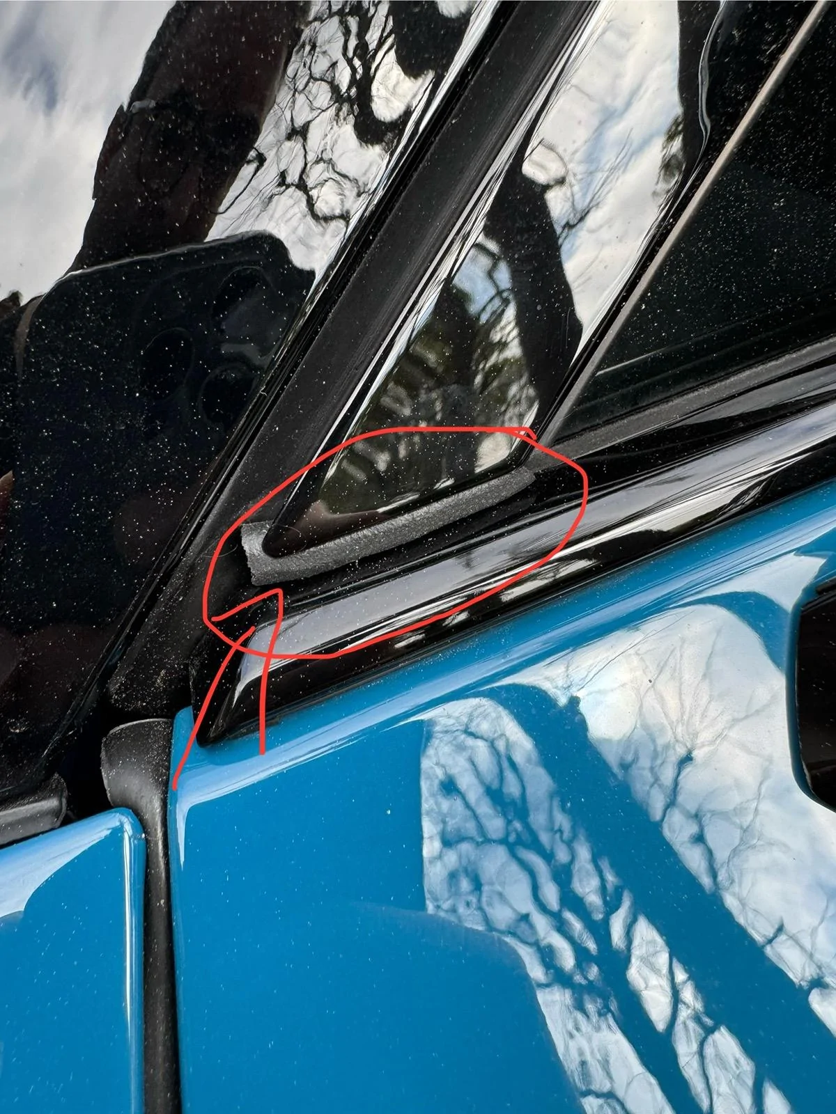

So I think I found my issue.....There is a LARGE difference between the plastic trim on my passenger (wind noise with painters tape) vs my drivers (non painters tape)
Can you describe the differences? They’re not obvious to me in looking at the pictures. Thanks!
There is definitely some fitment issues on the side with the painters tape (look at the bottom) compared to the drivers side. It seems to be in a LOT more than the drivers.

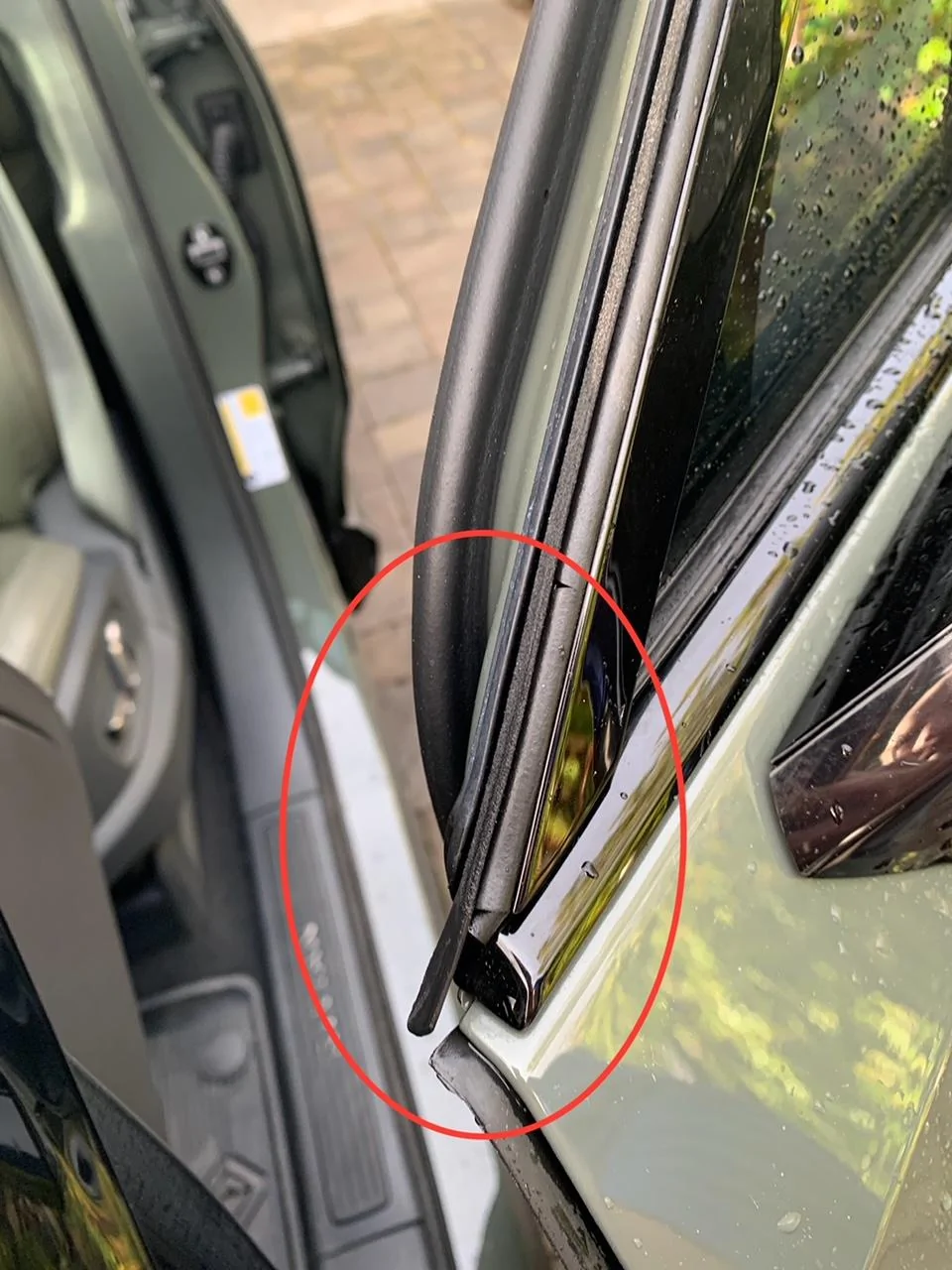

I just got mine back last week and my noise issue is solved. Service adviser drove it with me on the highway and was careful to say that there is going to be some noise at higher highway speeds, but then recognized the sound immediately (sounds like wind coming through windshield wipers on a car when going through the high speed drying blowers at the car wash). They reseated the triangle window with a new gasket that extends all the way up the A frame.
We are QUIET now!
Thanks for the explanation! I see it now.
We are QUIET now!
Got a pic? I had mine serviced once and they replaced right like 3 different pieces of foam... I gave up and just jam out instead, but it's been like 30k miles...
I'll upload a photo of how the new window gasket looks later tonight when I get the R1S back for my wife. The Gaithersburg service advisor said that he felt the gasket was folded in addition to there being a sealing issue. Maybe you guys could tell your service advisor that he should connect with the Gaithersburg one for advice on a solution?
