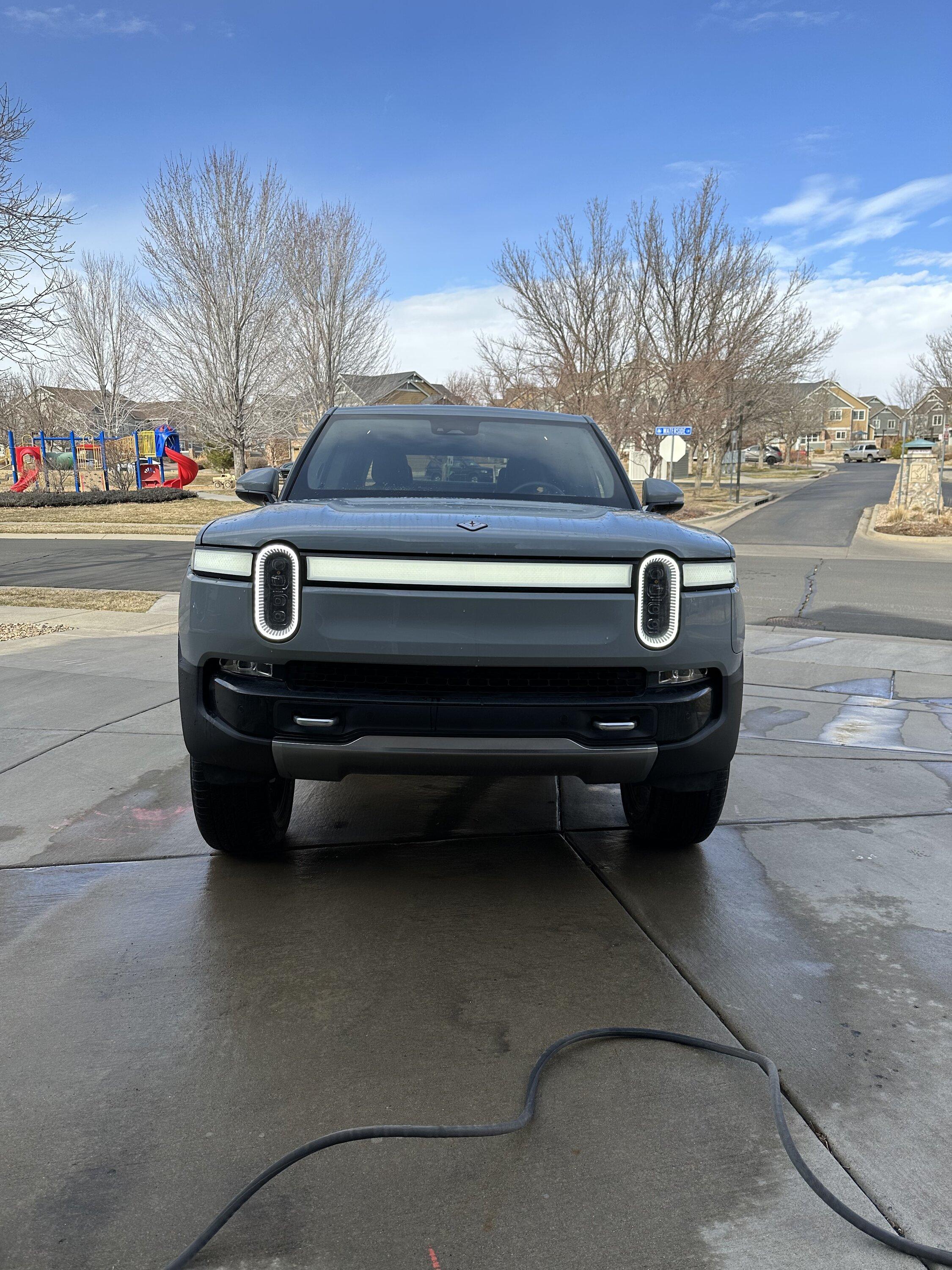

That’s good - I just noticed this on my truck today after picking up a week ago the driver side is about 3/4 of an inch lower than the passenger side at all times. This is both front tires:
That looks more like 2.5 inches. That's a huge difference
Yes I agree but I measured with Rivian service on the phone and it’s about an inch. Goes in Wednesday for a few fixes so they are going to take a look!
hard to see but this is a shot from in front…
This looks very similar to what I had except on the front vs the back. If you have some time, I would recommend you measure on an hour by hour basis after putting on offroad / tire change. Hope they can get it resolved quickly / easy.

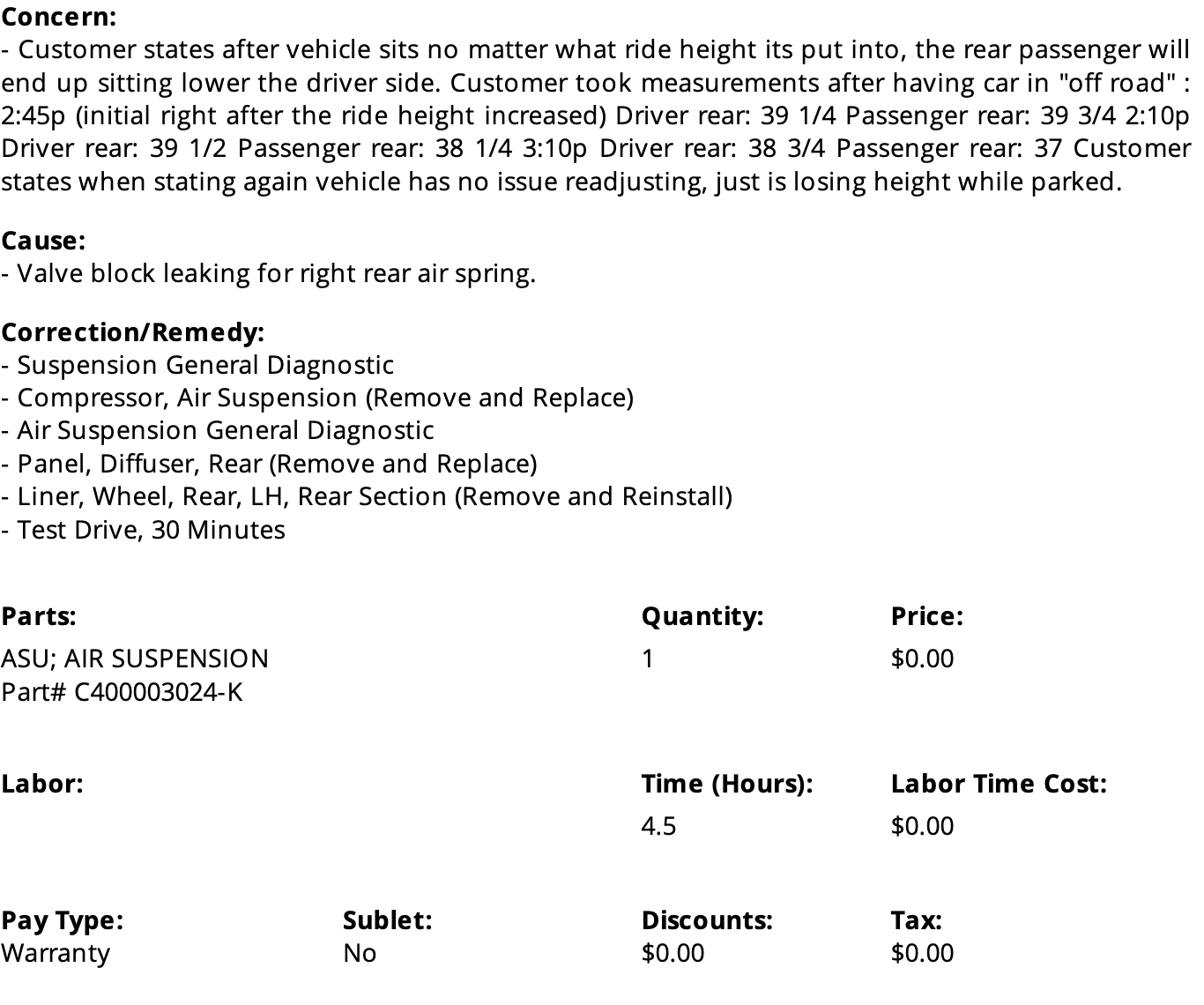

@DTown3011 BTW: Here was the writeup when it was resolved (they had some of the times wrong but you get the idea). It lost about an inch an hour and bottomed out.
Thanks - mine doesn't seem to be losing air, just not level. I just went out after an hour in tire change mode and the heights were the same. However, similar to the photos above they are about 3/4-1" different heights.

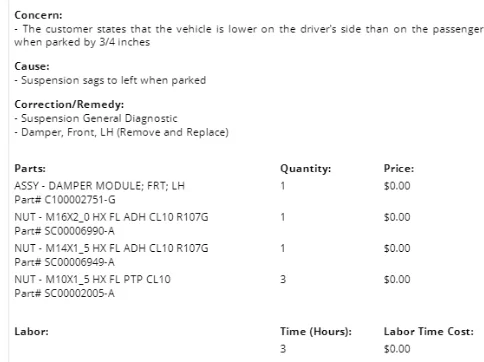

Well, they fixed my suspension today under warranty. Apparently it was a broken left front damper and they had all the parts in stock. They also fixed the alignment and all was completed same day.
