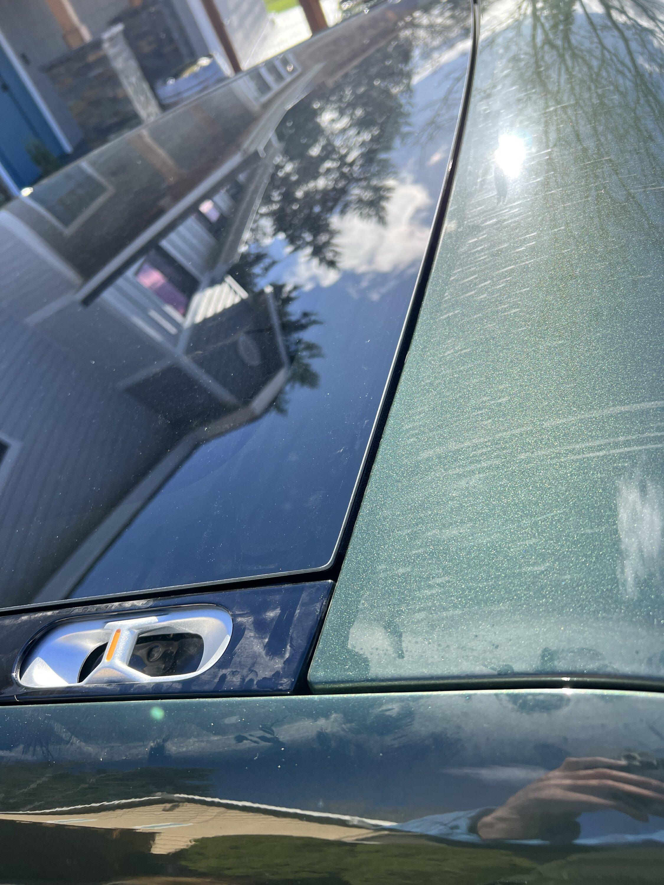

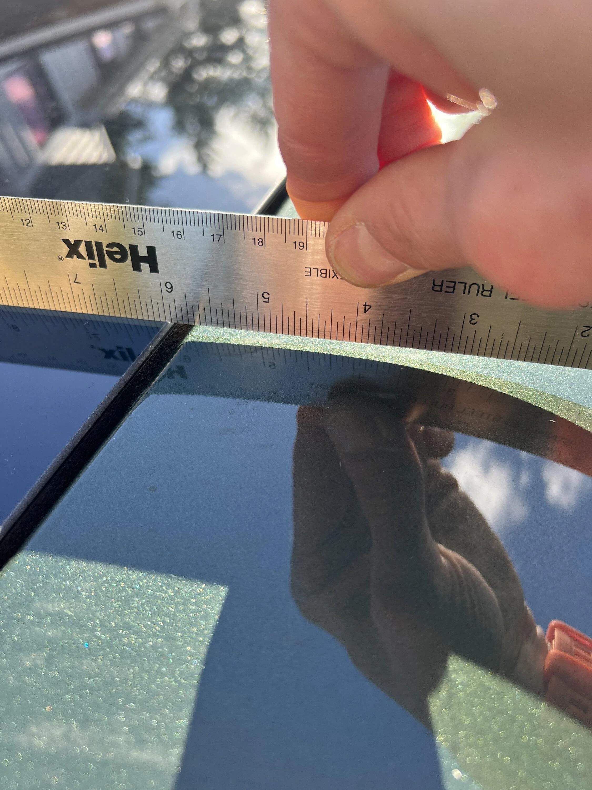

I’ve had all those problems and some still exist. After 2 attempts the PAAK is finally working; but still buggy. Had alignment completed twice and still not straight. Also have an unacceptable amount of wind noise; in my case it’s coming from the glass roof sitting proud of the header panel. Was told at last appointment that this is within tolerance... What do you think?
I have another open ticket in….
The POS has been in the shop 3 times already….
Have you taped that off yet to see if it helps? Some people have had that applique torn off and replaced so it sits higher than the glass and it didn't do much. There is a black rubber t-mold that can be put there that someone said helped (another wind noise thread, but can't locate it).
Sometimes I found that it was the black strips along the sides. They sometimes are slightly lifted or just not on all the way due to a potential roof glass replacement at the factory.
bummer. maybe try this....Car Weather Stripping 14mm Car Windshield Weather Seal Rubber Stripping Trim Weatherstrip Adhesive T Shape Sunroof Seal Cover Leak Sound Proofing (16 Feet) https://a.co/d/e5I1BDv

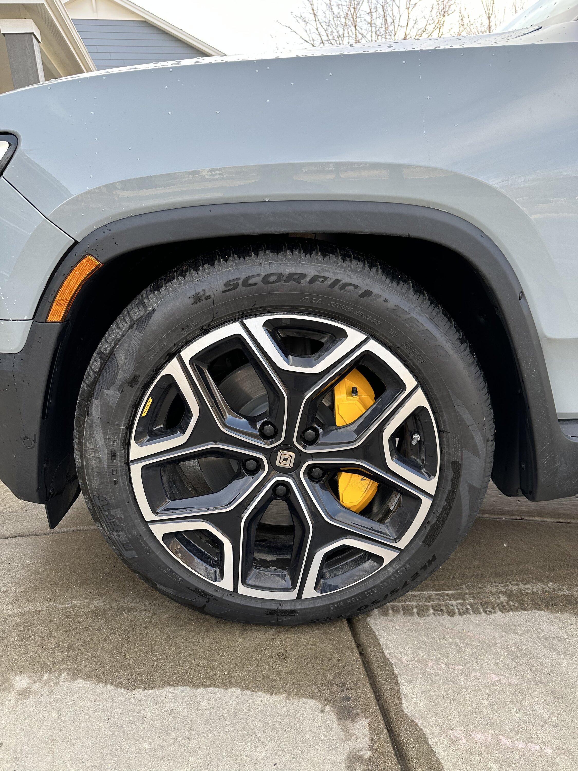

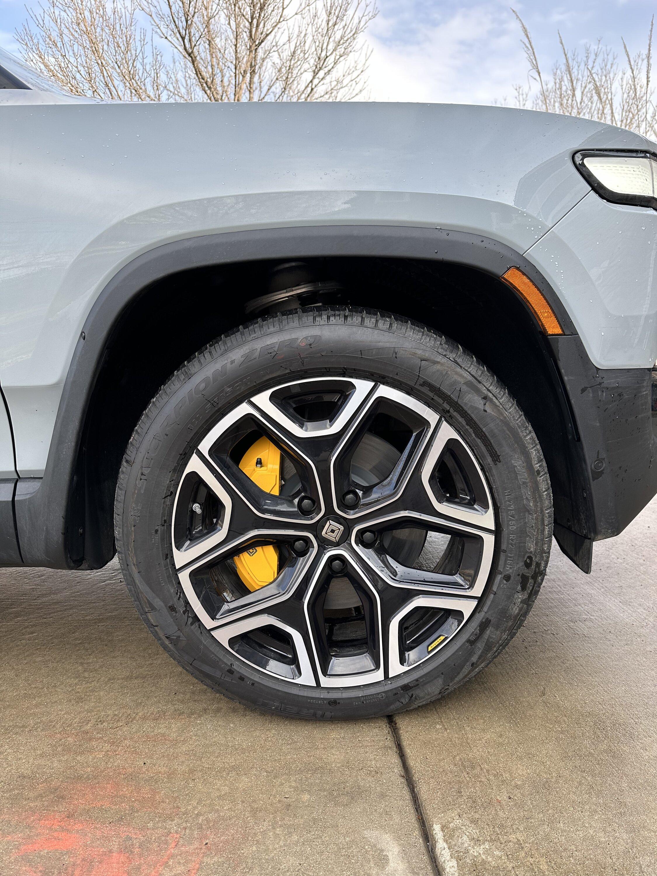

That’s good - I just noticed this on my truck today after picking up a week ago the driver side is about 3/4 of an inch lower than the passenger side at all times. This is both front tires:
