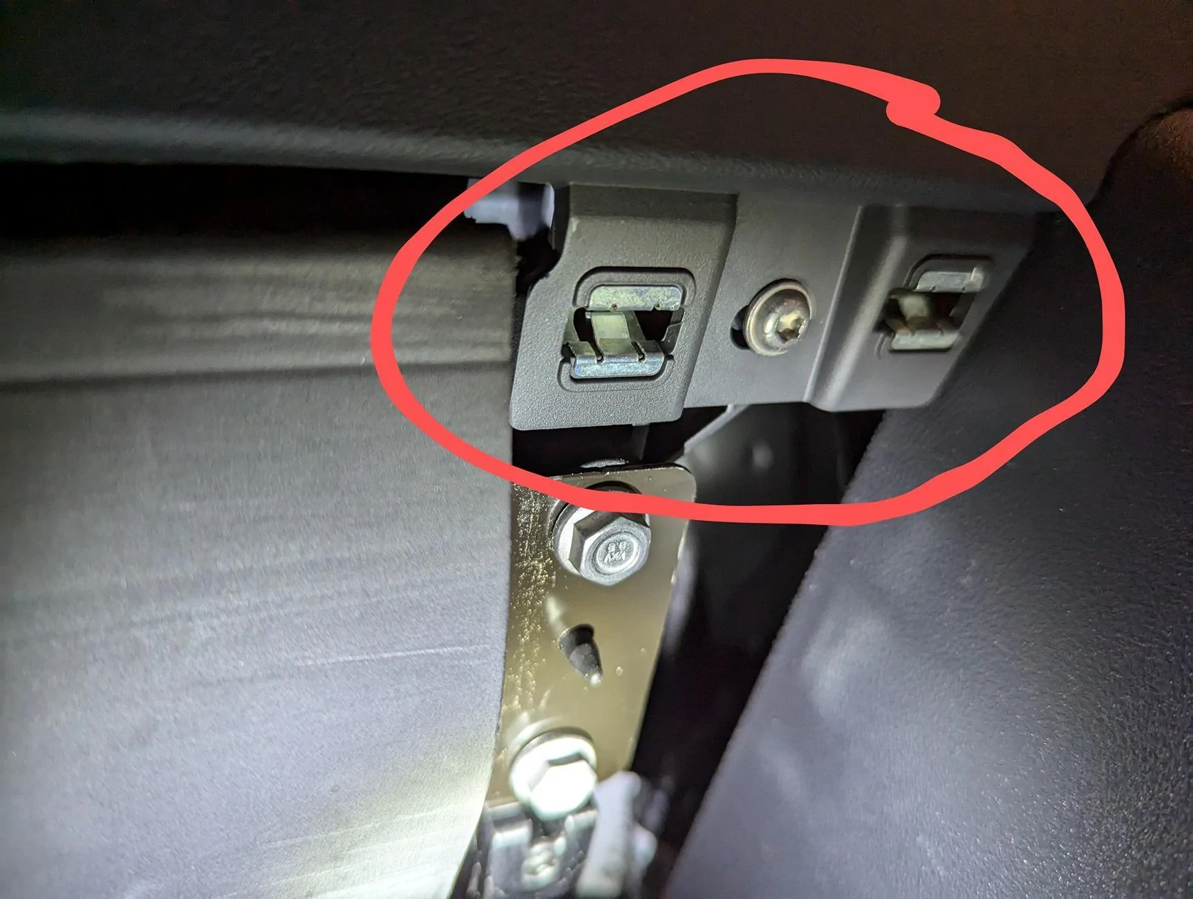

Here are the locations of the clips
Back side, towards the outside of the vehicle:

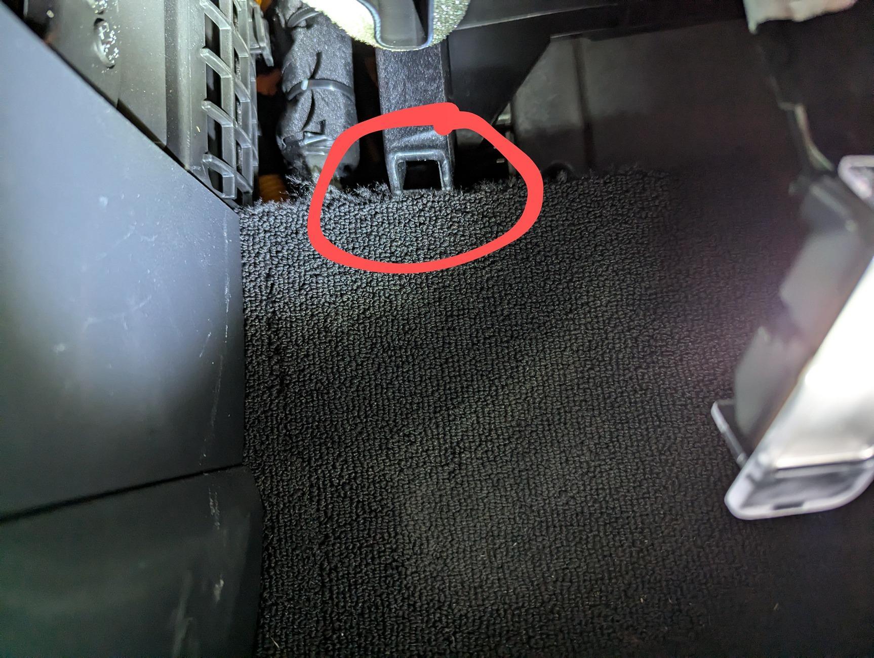

Back inside clip:
Rivian R1T R1S Backup camera pxl_20240817_162239085-2-

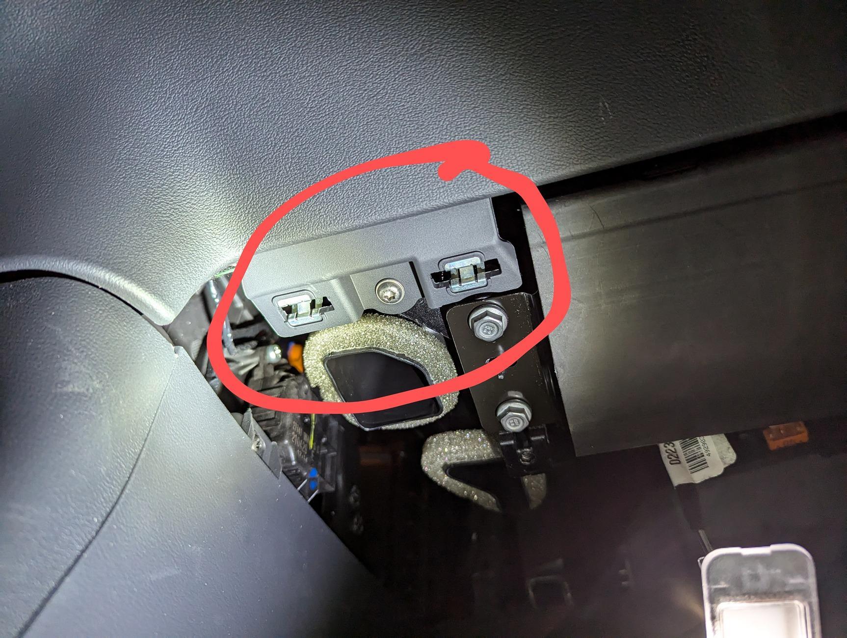

Front outside clips:
Rivian R1T R1S Backup camera pxl_20240817_162222257-2-jpg

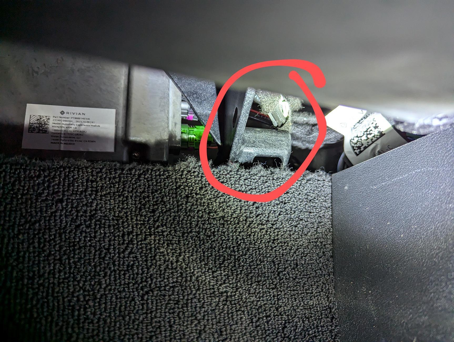

Front inside clips:
Rivian R1T R1S Backup camera pxl_20240817_162229426-2-

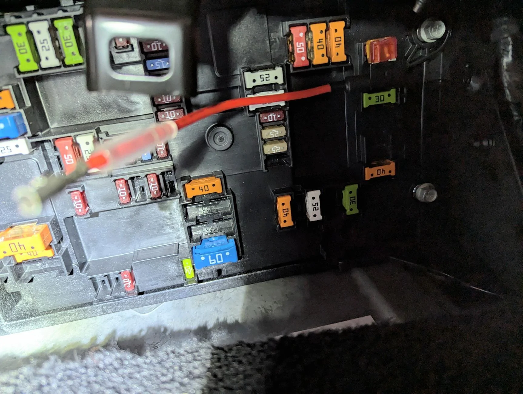

Fuse panel itself:
Rivian R1T R1S Backup camera pxl_20240817_162249304-2-jpg
i started by taking out the screws, the popping the back clips out. I was able to do this just by pulling on the panel itself, then with a little more force I was able to take out the front clips. I never needed a trim tool, and none of the clips broke.
I did have to pop the whole foot well light out of the panel, as I couldn't get the cord itself out of the light without feeling like I was going to break it.

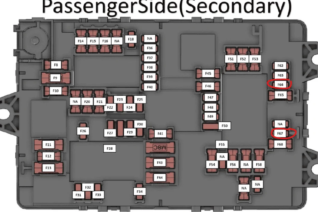

Was able to get to the panel and tried putting in my fuse tap (F64), but wasn't able to get it to power the screen I am installing. However, the USB-C ports next to the rear screen seems to be powering it just fine. Not sure what's up with that...
So, in the end I am able to power the monitor off of one of the USB-C ports which intrigued me as I thought I had read that they wouldn't push enough power. Still need to test the connection between the monitor and the camera itself.
Also interesting was that there wasn't a fuse in F67, like was mentioned above.
