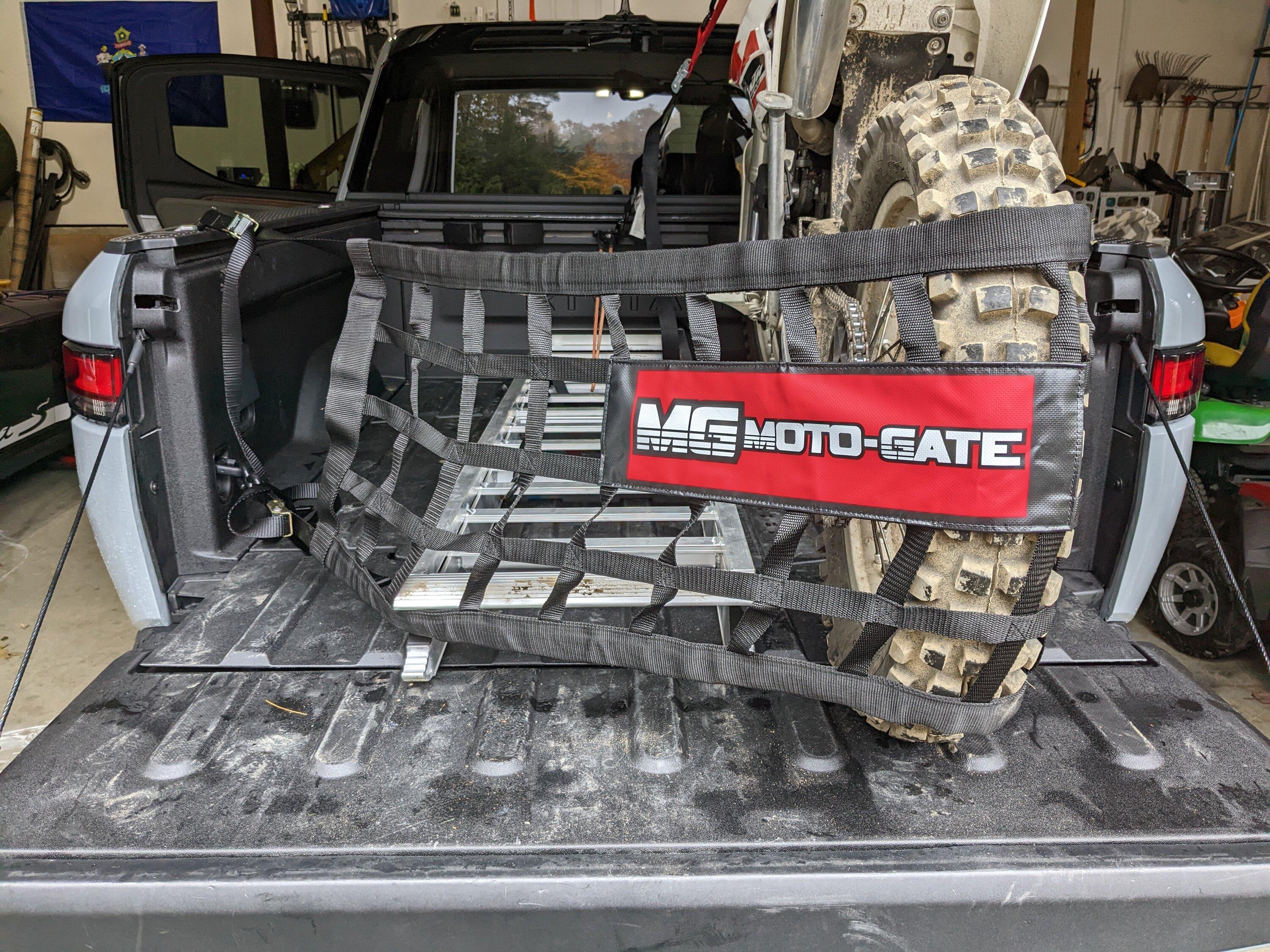

What's the moto-gate you're using?
All loaded up this morning, it's almost like cheating with the step ramp, moto gate and the CCR Hybrid rail.
Rivian R1T R1S Bed Rails PXL_20221025_124507200.MP
Rivian R1T R1S Bed Rails PXL_20221025_124518392.MP

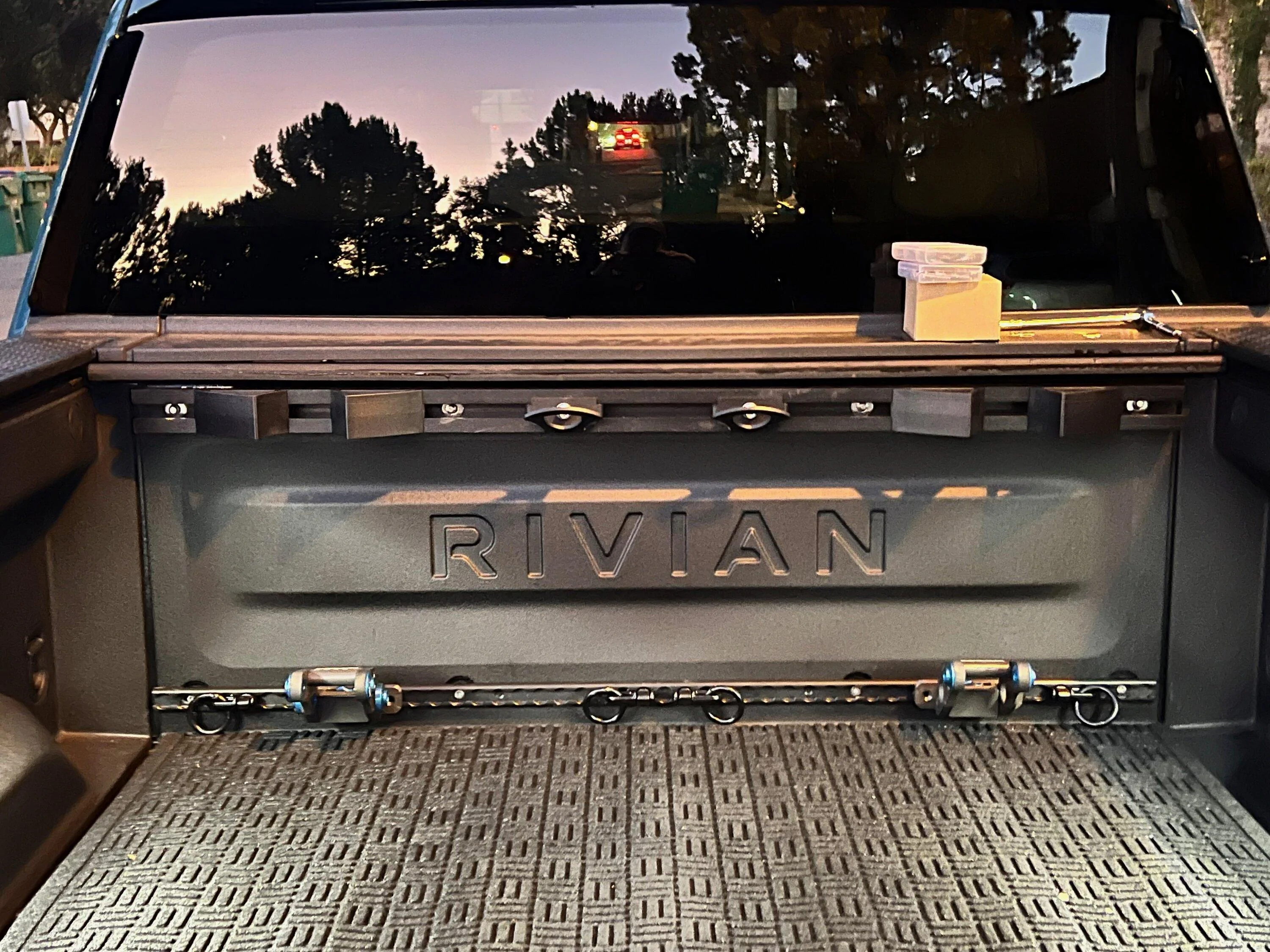

However to @EVerywhere 's question - I am using the lower L track for any tie down (if needed only after the factory load hooks are used) as I do not want to put much, if any, force on the upper L track that is bolted to the tonneau enclosure. I got 2 of these EZ Chocks
https://www.motoprohq.com/product-page/l-track-ez-chock
which do appear to clear the tonneau cover, but since they easily snap off the L track that doesn't really matter. I'll probably be only transporting 1 moto 90% of the time anyway. I haven't been able to test with my moto yet, the only questionable thing about these chocks is most of the chock sits below the L track and I'm hoping they don't create too much levered downward force on the L track when tie downs are synched. If they do it would be pretty easy to place something behind the chock that rests against the bed wall to mitigate. I'll try to take some pics later
