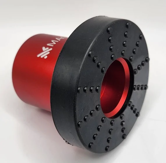

I hear your question, if the jack using the puck is in the jack/puck spot, how can a stand be placed in the same spot while the jack is there? So, the reply seemed to be put the stand under the lower wheel control arm.. The reply question to that is, if that can be done, why does the Rivian puck and spot need to exist? My interest is rotating wheels, I am buying 2 wheels with tires on them, that way I use the puck spot, remove a wheel and put one of my extra wheels on that corner of the Rivian. An extra wheel is needed to do this and the extra wheel is required to be included in the roataion.

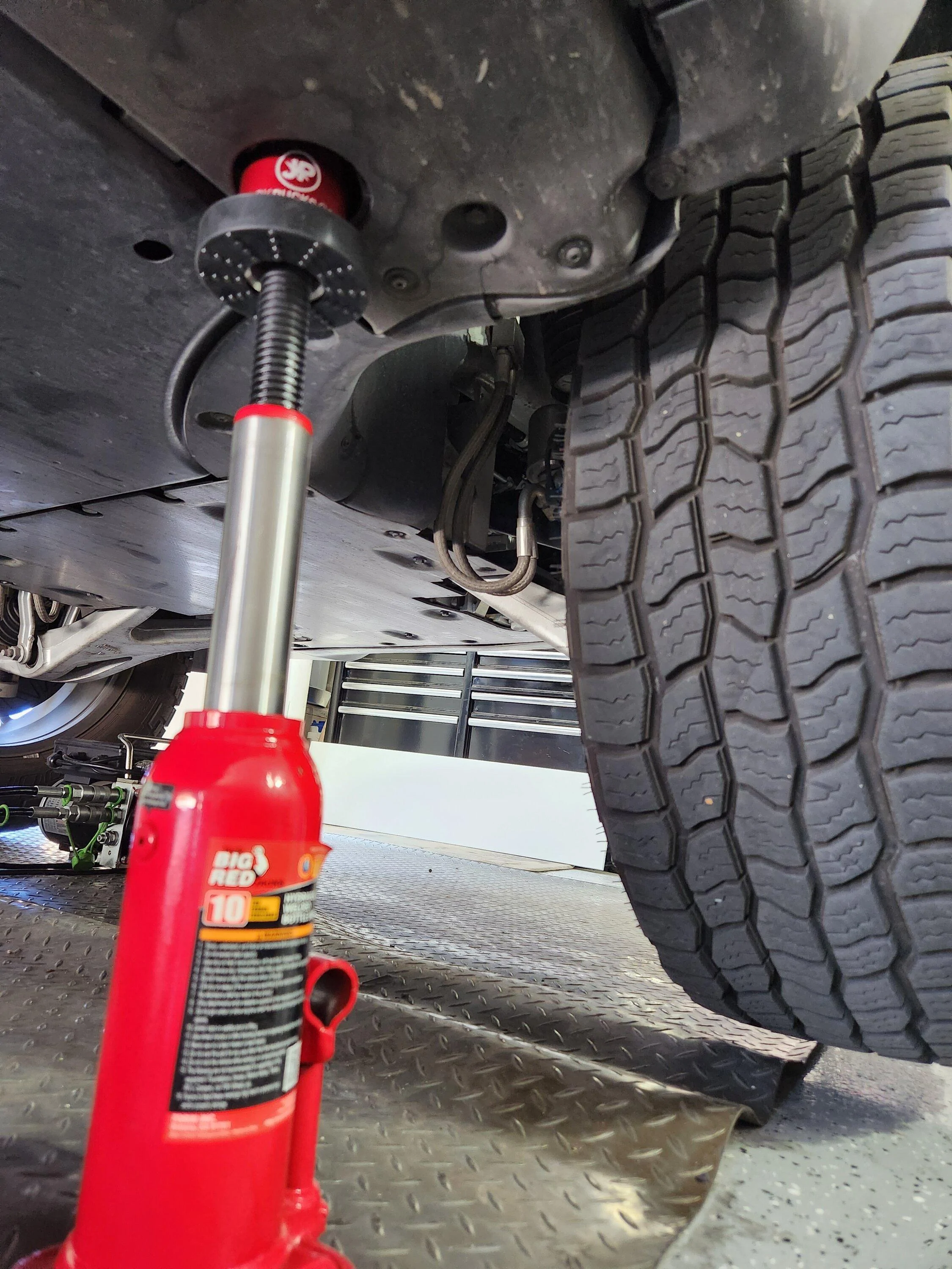

I use four (4) 10T Bottle Jacks and my magnetic pucks for rotations. Other's may not agree, but the bottle jack serves as pseudo jack stand to me, even if the ram fails it still has some protection.

Here is my unconventional way of rotating tires quickly.
Either two 10T bottle jacks with our pucks or two HF 3T high lift floor jacks. Lift opposite corners and then use the 4T flat top Jack Stands with our Jack Pucks with the Grip Tech Bottom (no slippage) on the other corners. Works like a charm, not saying you cannot do this another way, but it's how I do it.
