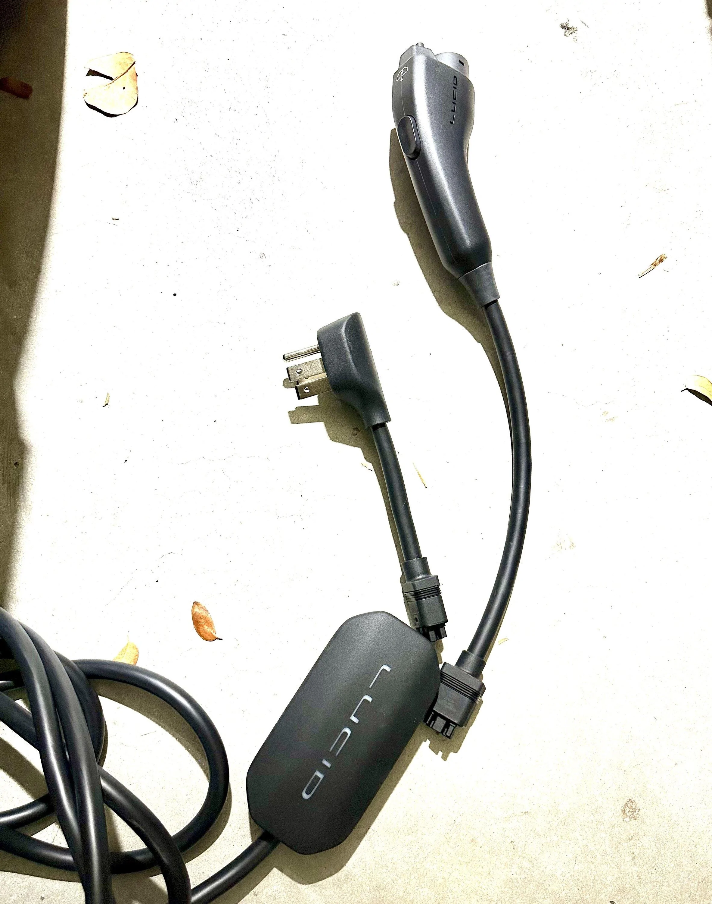

I suspect Rivian will do V2V first as it is the easiest to implement. Lucid did it a few months back and it was nothing more than replacing the 240 volt charger cable connection with a 1772 and a software update. We tested it on our R1S and our son'e Model Y (with an adapter) and worked great on both. Both cars were charging around 9kW from the Lucid. I am now waiting for a smart device that can trick the Lucid to treat a 240V 40A connection to the house as a Vehicle.
Does it break out a neutral? That's the issue with J1772, it doesn't have a neutral wire so you'd need a transformer to be able to tap one off it.

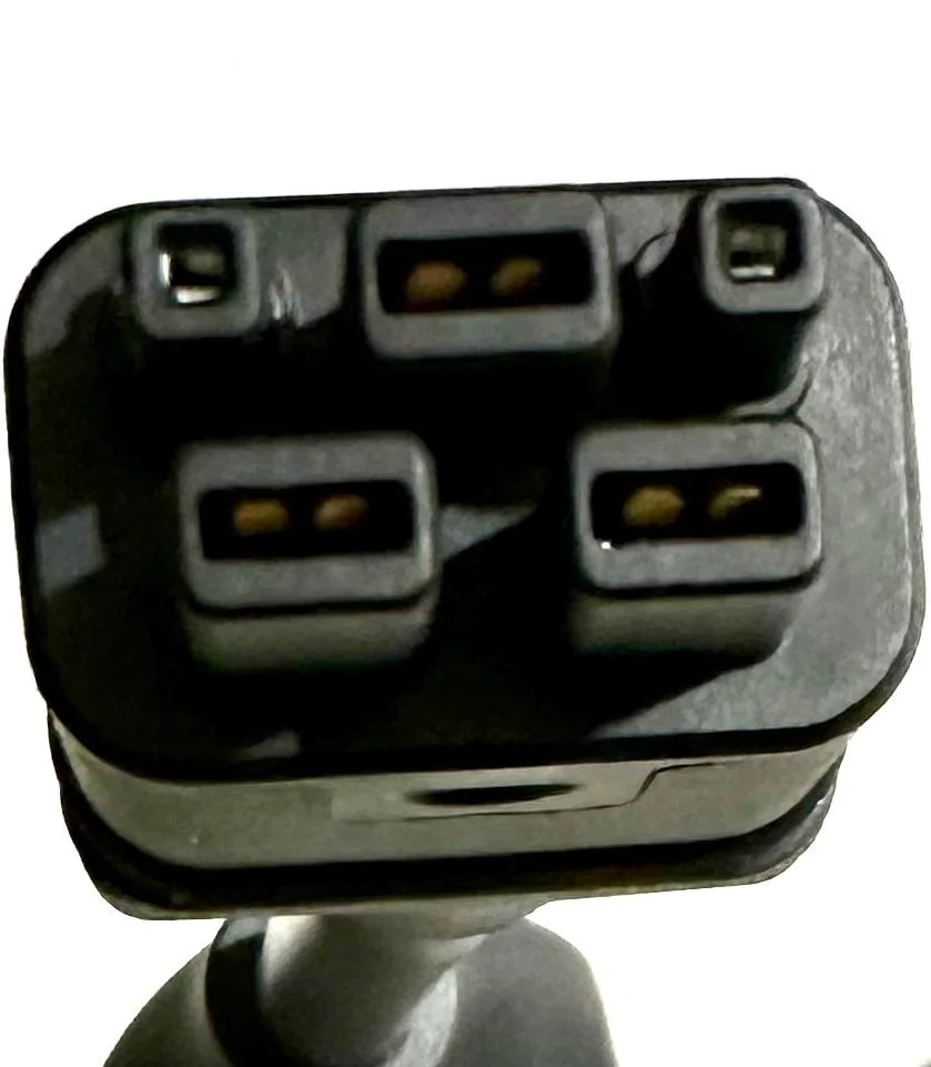

Looking at the two dongles it appears that both the NEMA 24-50 input and the j1772 dongles use the same connections.
You shouldn't need a transformer to get a Neutral. Just bond a Neutral to the existing Ground. If you're doing V2H, it would be bonded, anyway at the main panel.
This is assuming they are actually putting the ground in a neutral position instead of it just being a path for equipment grounding. I don't have a lucid so obviously haven't tested.
