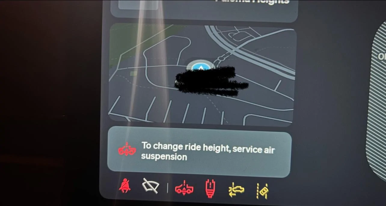

Had this exact issue a few months ago. Early 2022 R1T build. Turned out that it was the ACU (accessory compressor unit) starting to overheat and fail prematurely. And the reason it also popped up for me right after a previous update is that they put new vehicle testing/warning features in software updates that allow the truck to catch small errors earlier that way they can be serviced before causing major damage.
The reason all of the other features (lane assist, etc) don’t work is because it can’t confirm calibration will be accurate due to the (suspension issue).
They replaced my ACU checked all the suspension components and got me back on the road in less than 24 hrs from dropping off at the service center!

It's not the OTA. It's your brand-new vehicle that has a problem. Problems show up when a vehicle is new and systems start to get their first workout.
Perhaps there's a slow leak in your air suspension. Perhaps a wire connector wasn't snapped in fully and worked itself loose with vibration in the first few hundred miles. Perhaps one of your control modules has a bad chip. These are all things that could have worked at the factory then broke when the vehicle started to get some use.
Why you go straight to blaming the OTA? The OTA has been out for more than two weeks now, so if it were "botched" then don't you think many of the 100,000 existing owners would have noticed that?
I think if you look at the thread "Rivian reliability is a problem" from yesterday's most popular new topics, you will find many complaints following the recent software update. My vehicle is 16 months old with 10,000 with no serious problems til the screens went black while driving 2 days after the update....which others also had occur.
