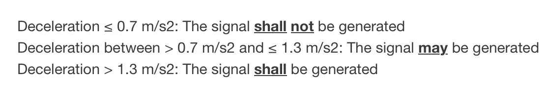

do you know if Rivian uses the 0.7 or the 1.3 to determine when the lights are activated.
I do not know for certain, by the seat of my pants it seems like the Rivian lights are about the same as my Tesla. 1m/s2 is around .1 g so my best guess is they are triggering the lights in that middle range.

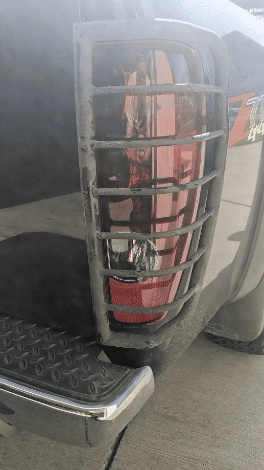

on the way home last night I noticed it was bad enough that the car behind started leaving more space because the lights weren't coming on until I came to a complete stop in stop and go traffic
I don't have enough experience to say one way or the other, but the rate & frequency seems fine to me. If it causes, as you say "people behind you to leave more space" I'm all for that. Just speaking as someone who's been rear-ended many times, people in general need to slow down and leave more space. Ironically I've put reflective caution tape, "Caution this vehicle makes frequent stops" magnets, and even brush guards and bumper bars on the backs of my previous trucks, and the idiot drivers in my area still manage to run into the back of me.
Funny how I was driving a Chevy and nearly every time was hit by some clod texting & driving in a Ford F150. It's like Fords have it out for me. ??
I have these items on the back of my Chevy, currently:
Rivian R1T R1S Brake Light Activation Poll 1680626712985
Rivian R1T R1S Brake Light Activation Poll 1680626797938
I live in one of the worst traffic congestion regions of the country, outside of somewhere like New York or LA. Need to figure out a good way to mount them on the Rivian!
